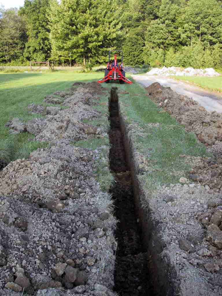

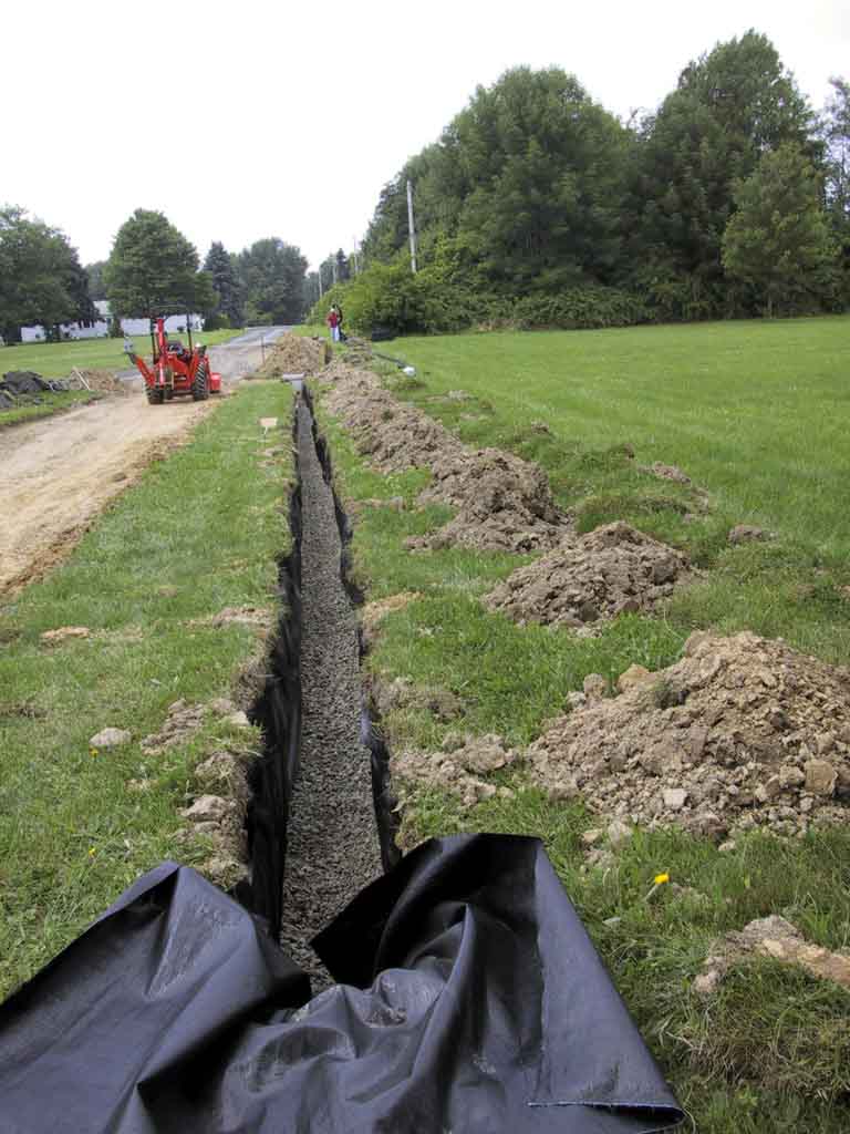

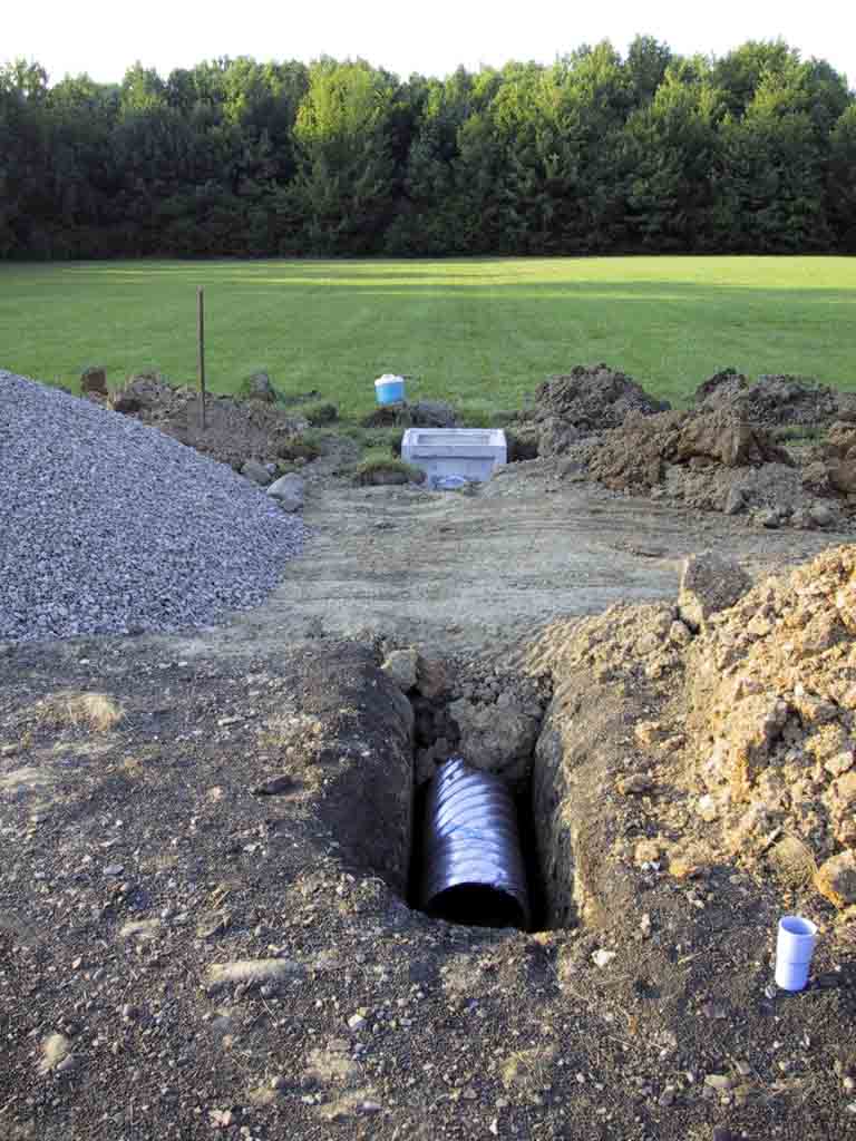

My upper front yard is a field about an acre plus which is separate from the lower front by my driveway. The grade of the land is from the upper yard to the lower one. The driveway is roughly 12" - 18" above lowest part of the upper yard - thereby forming a barrier to surface runoff.
When it rained water would pool at the lowest points of the upper yard and it would stay wet for days .... and days ........ and days .... couldn't get into mow it without making a terrible mess and rutting it all up.
I dug roughly 250' of trench, 3' or so deep and installed a french drain using washed 57 gravel (about 18" deep) and 4" perforated pipe (with soil sock) placed near the bottom of the trench .... and then routed that to a catch basin which had a culvert that went under the driveway and emptied out in the lower yard. The trench was then covered with topsoil and planted in grass.
The result is that the upper yard no longer holds water - within 24 hours after a heavy rain there is no standing water, and within a couple of days (of dry weather) I can take the tractor on it.
On the french drain you are going to need to go deep enough to catch the majority of the subsurface water coming down the mountain ..... I would think that ideally it would be below the grade of your foundation.
It should be placed out away from the foundation some distance (out past the deck sounds like the place to me) - so that it both intercepts the flow of subsurface water coming down the mountain .... and draws water away from the foundation.
It should be capped well below the surface with an imperious material (say, clay) that will prevent surface runoff from finding it's way down there.
