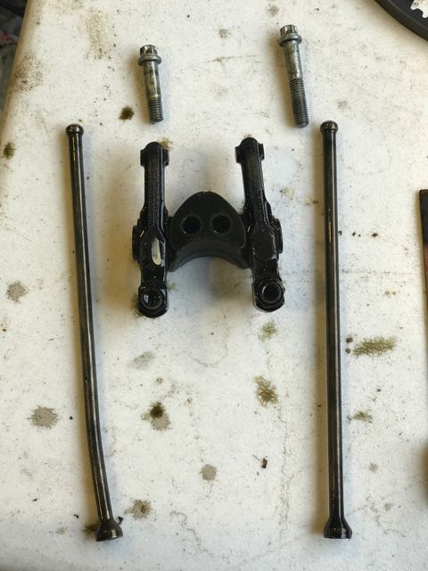

So here is where we are at. I am going to do a timing belt replacement today. As well, I will pop the valve cover and look for any goodies. If this does not solve it, then I guess it is a blowh head gasket.

With the injectors out, did you check compression in the cylinders? If it isn't OK, you probably want to check your valves (and therefore push rods), when you change the timing belt. As you manually rotate the crankshaft watch that the correct valves cycle the same amount.
The hesitation in the exhaust may just be ignition / non-ignition, but it could also be valve leakage.
