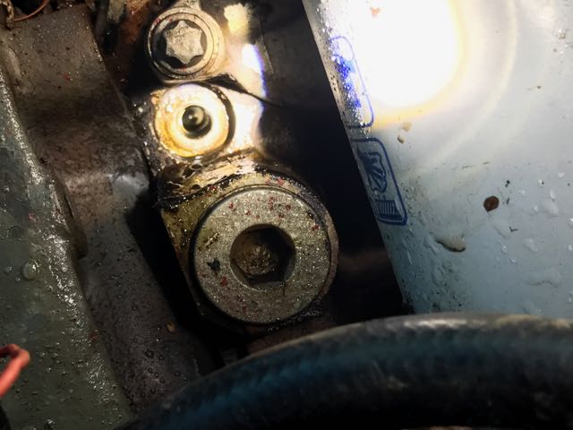

So, the belt slipped. No damage to the belt or to any of the gears that I see. It just hopped forward. In this picture, The purple mark on the pulley marks TDC (or where the pin rests on the crank). It should line up with the silver looking tab on the engine crank (this is only for your reference, not a true Deutz mark).

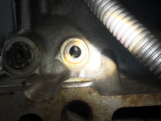

So here is the pin hole for the camshaft. As you can kinda see, its a hole. I should have taken a picture of it not lined up, but either there is nor is not a hole. And this is what the instructions say to look for.
And here is the hole for the crank in the WRONG position.
And here is it lined up correctly. There is a lot of confusing metal as you look through the hole and rotate. Keep a sharp eye out.

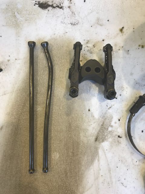

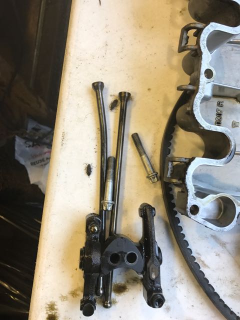

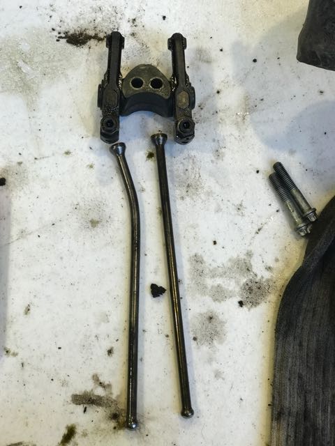

And here is what happens when your belt slips or breaks. The big thing is that it knocked the rocker nearly off piston 2. If you look at the photos you will see the bonus broken screw which thankfully came out SUPER easy. I mean like blew my mind easy.
Tomorrow I am back to the Deutz dealer for pushrods and new screws. But I now feel like I am near the end, and a lot smarter about the deutz.

Wow ,glad you finally found it. I hope,you do not have any bent valves or damaged pistons,from the extent of the damage on top ,it is highly likely depending on how fast the engine was spinning when the parts collided.

Raw. According to deutz it is nearly impossible to damage the valves or pistons. But you can see the push rods and rocker arms screws are toast
