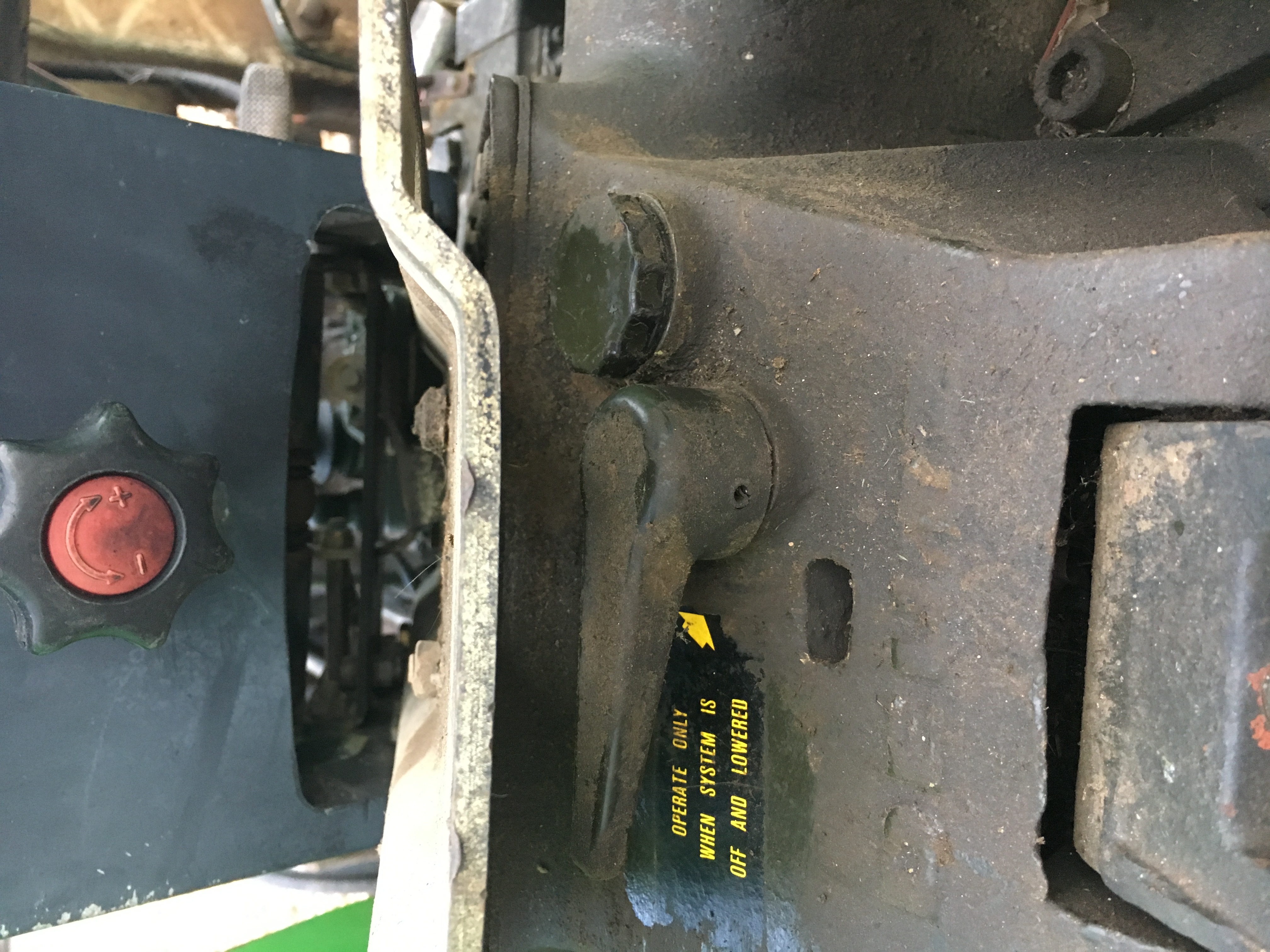

I had just gotten this Deuzt D4506 could you tell Me is that The oil fill on the lower right at the front of the engine
also were do you fill and check the hydraulic fluid ?
Thanks

I'd have to see a pict. of the engine oil fill, you are talking about...
For the hydraulics/tranny, I THINK there's a plug on top of the tranny and it has a dip stick attached to the plug...
SR

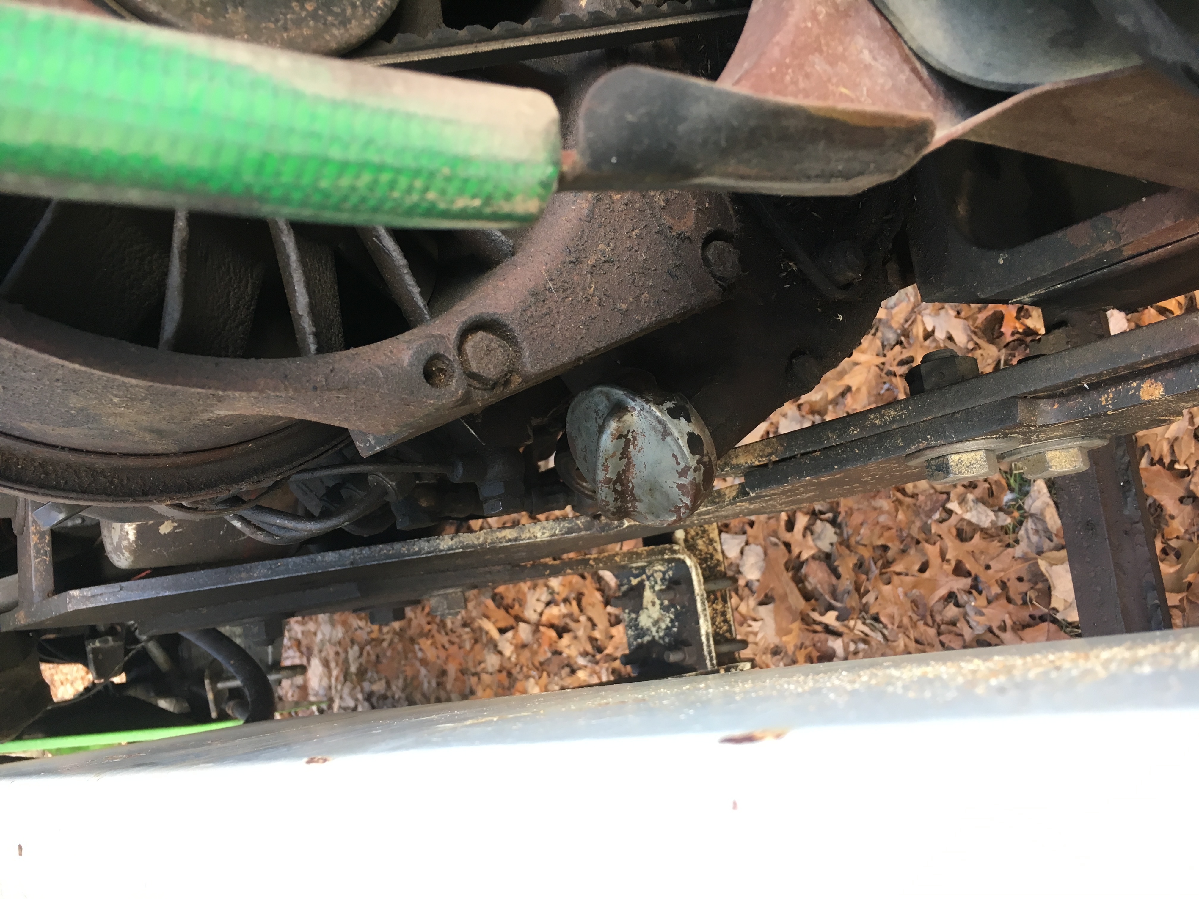

411B41F1-62E5-4906-92E9-4554CB3012DB.jpegDB178478-8986-4760-8CDE-806837FDC34B.jpegST.
SR here are some pictures of what I think is the oil fill cap
   / Deutz Tractors? #95
It looks like the oil fill to me too...
Those are pretty decent tractors, taken care of, they last a long time.
SR
   / Deutz Tractors? #96
YES.. That's the ENGINE OIL fill.. Clean it off real good w/a scotchbrite pad & either paint it red or yellow or use a sharpie & write OIL on it..

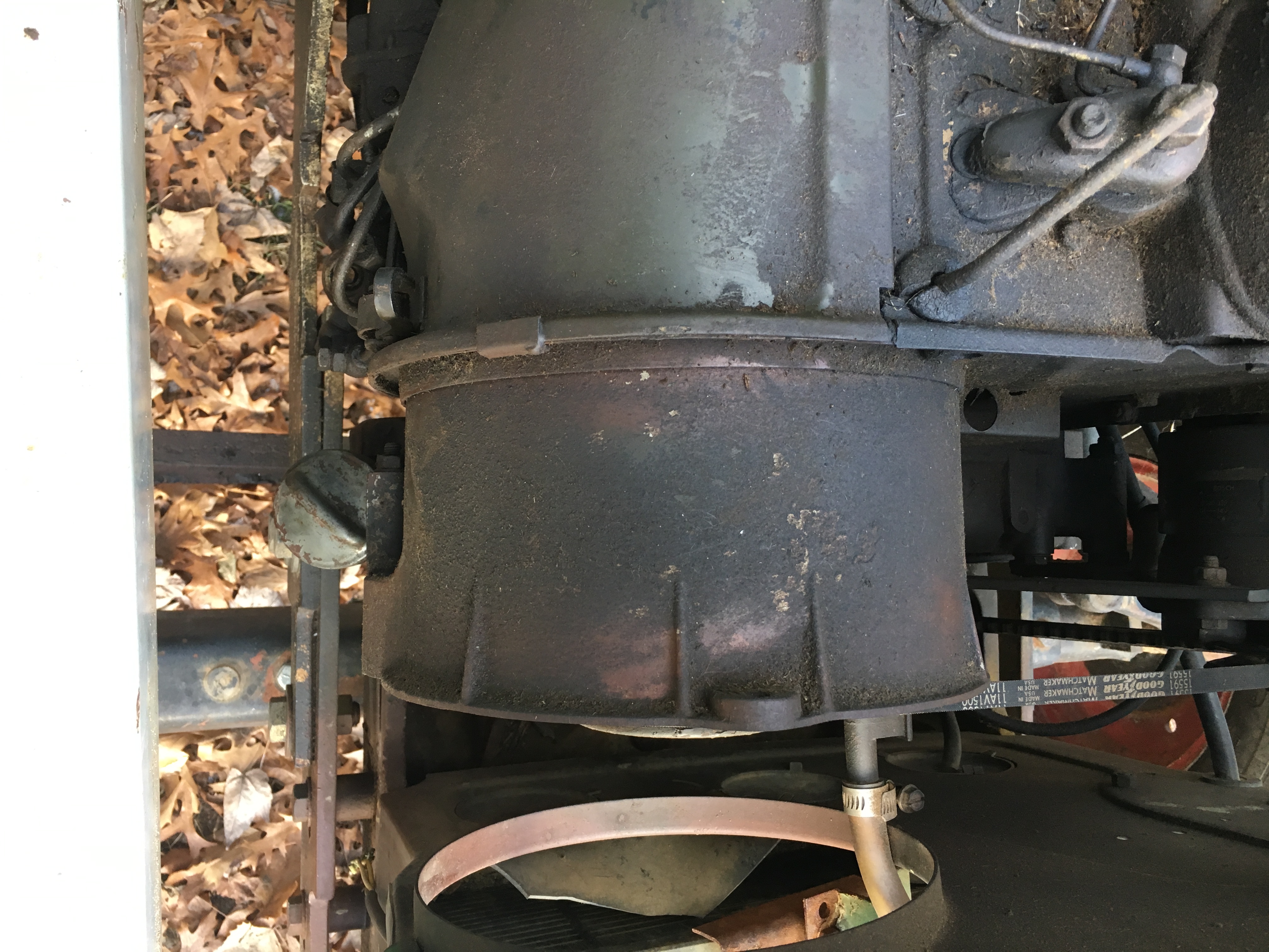

Thanks0B8C7DF5-C06C-43D3-A4FA-9B90E047E04A.jpeg. Is this where the hydraulic fluid check and fill plug,this is located under the seat.
   / Deutz Tractors? #100
It has a hydraulic filter too, it should be located under a cap between your heels as you set in the seat...
3 Allen head bolts takes the cap off, early tractors had the short filter, later had a longer filter.
SR
