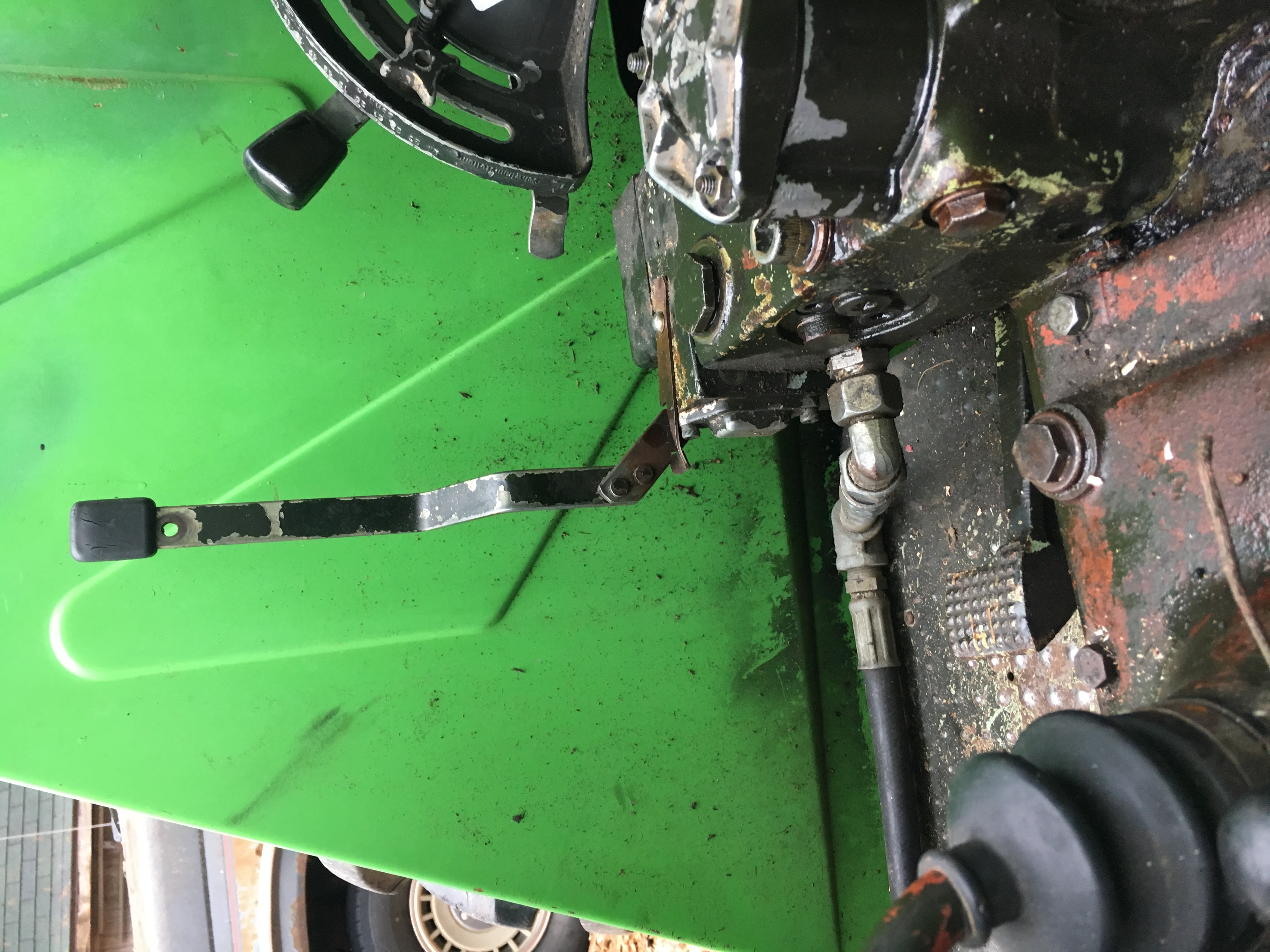

What are this lever for and what is this foot pedal do
Any ideas?
   / Deutz Tractors? #103
The pedal is most likely to be the diff lock. The lever seems to be for the remotes.
Now, if I'm seeing correctly, looks like you have a piece of galvanized pipe and an elbow on the hydraulic line going to that block. This is VERY dangerous and the galvanized fittings are not rated for the high pressures of an hydraulic system as they are made to use on water/air plumbing.
If it is indeed galvanized fittings, please replace it with the proper hydraulic fittings so you don't get injured.
   / Deutz Tractors? #104
Looks like that to me.
Yep, a galvanized line is rated for about 350PSI working pressure, not something that you want to run 2000-3000PSI through...
Aaron Z
   / Deutz Tractors? #106
They are right, diff lock and remote handle.
BTW, that tractor takes the longer hydraulic filter.
SR
