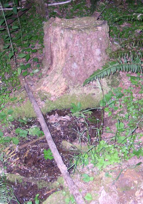

I've been thinking about trying to develop a small spring for watering my yard and garden.
The spring seems to run year-around, and as far as I can tell, the flow seems to be pretty constant at about a half to one GPM. The hill behind my property isn't a very big hill, so I would be leery about trying to get more water than it naturally provides.
The goal is water for the garden. I haven't tried to test the purity of the water (bacteria?)
It isn't a lot of water, but on a 24 hour basis, it would add up to about 1000 gallons which should be a good portion of my yard usage.
The spring comes right out from under an old fir tree stump.

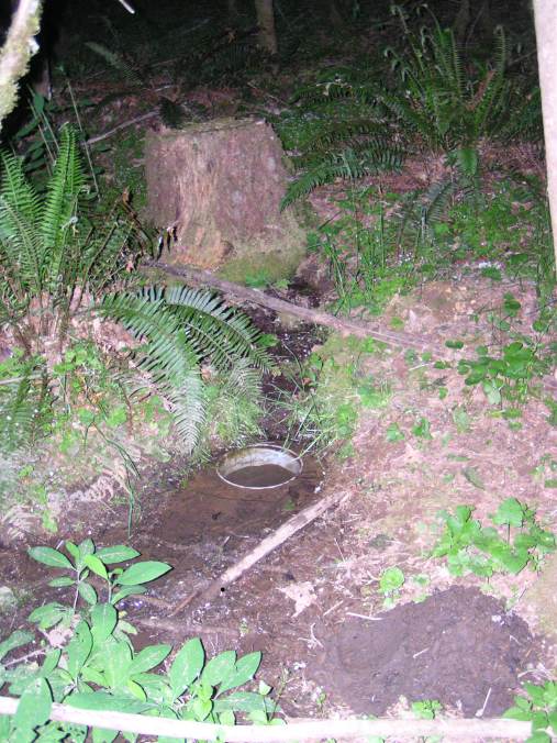

I put the bucket in a year ago so deer and wildlife would have someplace to drink, although there probably were enough pools for them to drink anyway. Other than leaves falling into it, I noticed that my bucket had silted up this spring.
I'd like to run plastic pipe, perhaps 400 feet total, and less than 50 foot rise (I think) to the highest place on my property where I'll put a 500+ Gallon tank.
It should be about 10 feet above most of what will be using it. I guess I could elevate the tank somewhat too.
I'm thinking about a small, 12V or 24V pump, solar/battery powered.
My well is about 200 feet deep, and I can definitely see the charges on my power bill when I'm watering heavily, so I was hoping this would help a bit. Plus being "renewable".
Q's & Thoughts?
Can I install a surface tank from which I would pull the water, or do I need to go with digging out the actual spring, and dumping in a load of gravel & etc? Do I risk the gravel also silting up? Damaging the spring?
What size of hose to run for maximum flow with minimum energy (for about 1GPM)? 3/4"?
For a surface tank collection tank, I would be able to just scoop it out every once in a while (or could I convince silt to drain out a drain hole?
Summers are dry here. I might be able to store some rain water, depending on the storage tank size, but I wouldn't expect to get a lot of new rain water after mid June. In fact, perhaps it would be best to assume that a large storage tank could just slowly be filled with spring water during the rainy season rather than trying to capture both rain water and spring water.

When I was a kid, my grandfather had a spring much like yours. He borrowed a backhoe, dug it out maybe 4' deep and approximately 8'x10' square. He ended up getting a bit heavier flow and we used that for all the house and barn water for over 20 years. I do know he encouraged the local water cress, supposedly it helped filter the water, but it was a pain for us kids to thin out each summer, of course we got to swim so it wasn't that bad:laughing: It was covered with wire to keep critters out and tin covered the pump.
You may be pleasantly surprised if you dig out a natural "water hole" then pick out the appropriate water pump for your needs.
BTW, grandfather didn't use a "cistern" pumped straight from
the spring year round and never froze solid in the winter, cistern may. (Northern Arkansas)

I was just wanting to use it for irrigation.
I don't know where all the drainfields are, so I would certainly want to get it tested before drinking it.
It sounds like I'm in for a lot of digging at the spring end. My thought of an uphill tank would be that I could slowly fill the tank 24 hrs/day, and then I would have the water on demand. If I put my storage tank on the downhill side, I would need some kind of a 110/220V lift pump (no solar) to get reasonable on demand volume.
Since this is a generally small hill, and this seems to be about 100 feet higher than my well water level, I don't know the aquifer size if I do manage to get higher flow. I don't want to mess with neighbor's wells (or mine) either. Anyway, so the current flow would seem sufficient.

I have a spring that serves my house and has for 100 years. Fortunatly it is a 110 feet above my house so gravity is all that is needed to get water to the house 900 feet away. The original wooden spring box had rotted to the water line and was letting silt and salamanders into the spring so I improved it a few years ago during the driest part of the summer. I dug a hole 8 ft.X8 ft. as deep as I could, about four feet deep on one side down to the ledge rock that the water comes out from under and six feet deep down to blue hardpan on the rest. I then took a 40 inch perforated aluminum culvert eight foot long and trimmed one end to fit close over the ledge at the point where the water comes out. I stood this upright and backfilled around it with screened 3/4 inch stone all the way up to ground (swamp) level on the outside and covered it with some of the excavated topsoil so the ground slopes away from the stand pipe. Eight inches or so of stone on the inside to seal it from salamanders and installed my 3/4" plastic pipe and strainer on the bottom through a hole in the pipe lower then normal water level. A half sheet of 3/4 plywood on top for a cover to keep the leaves out topped it off. (Humm , about time for a new one of those or a piece of steel.)
The crushed stone acts as a storage tank and the excess flow wells up on the down hill edge of the hole I dug and continues on it's way starting a brook which runs to Long island sound.
I also renewed the interceptor ditch that runs around the spring to catch surface runoff from nearby neighbors fields and deposit it in the brook down stream a few yards. You don't want the taste of freshly spread liquid cow manure running into the top of your spring.
You could do the same and lay a half inch black plastic pipe to your storage tank but if you need irragation water 1000 gallons won't go very far so you might consider a large cistern at the spring that would fill by gravity and could be pumped from when needed.

Well -- I think you need to dig a hole near the spring so the hole is deep enough to have water reserve and have a large surface area for static pressure. This way you can have a larger pump to pump in a shorter amount of time to get water where you need with less energy. I would make a trench from spring to hole you dug and fill it with 1-2 inch rocks to act as a silt filter. As for pipe, I am leery here, cost and size goes hand in hand - larger size gives you less friction to push more water but smaller is cheaper to setup. There is no point in going small only to get a trickle since its 50 ft pushing up and 400 ft run. I dont know the water friction losses, and I am sure you can find it via google.

I don't have a backhoe now, and don't see one in the tea leaves for a while, so I'll probably be using a shovel.
I'm not quite sure what the dirt is like as I dig down. I think it may be a real crumbly sandstone, at least for a few feet.
Undoubtedly the tree that previously was there, and now the stump has broken through whatever layer holds the water, and is now providing a channel for the water to come out. Thus getting to the source would mean either digging out the stump, or moving about 6 feet uphill, and hoping to intercept the spring above the source.
I think at this point I'll start simple, and perhaps incrementally expand. That will also allow me to see how different components of the system work together, and what works, and what doesn't work.
About where the bucket is in the photo is fairly level. I think I'll dig out and bury half a barrel just below the spring. If I do bungs down, I should be able to put in a clean out valve in the bottom with a drain further downhill. Then a pump, solar panel, and battery, and I should be able to send the water uphill. Perhaps with an annual cleaning of my system.
I was thinking of using a float valve at both ends, but if I can generate enough solar power in the summer, I should be able to design an overflow and just pump all the water I can get.

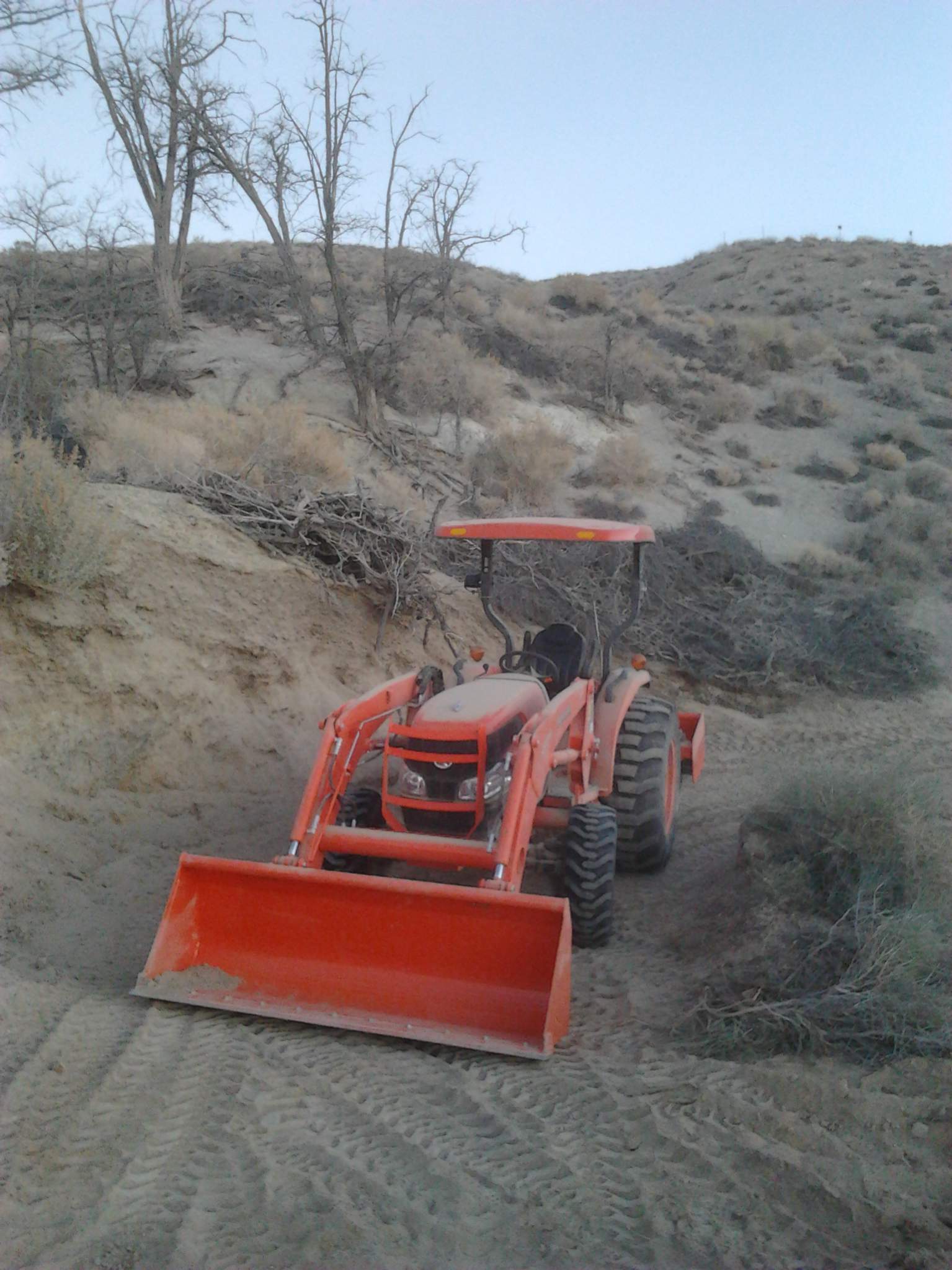

Here's a shot of my spring "project." Our spring was at the end of a 90' tunnel that had caved on me a few years ago as I was doing a bit of maintenance. Solution: bye bye tunnel. As you can see, water is a scarce commodity hereabouts.

Chances are the spring is actually uphill from the stump, and it just daylights there. if you dig a horizontal trench uphill you may get a lot more water. My grandfather did that many years ago, and developed a spring from a seep like yours to a spring that filled a 4" pipe year round. You're probably losing most of your water into the ground before you see it. I would recommend putting in a few days on the end of a shovel rather than getting wild with a backhoe.
