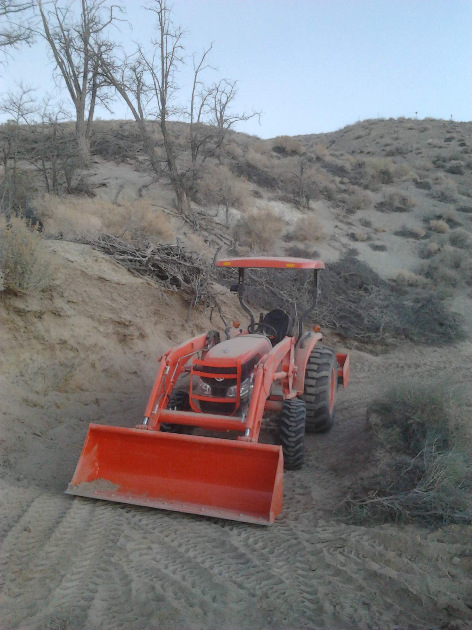

I don't have a backhoe now, and don't see one in the tea leaves for a while, so I'll probably be using a shovel.
I'm not quite sure what the dirt is like as I dig down. I think it may be a real crumbly sandstone, at least for a few feet.
Undoubtedly the tree that previously was there, and now the stump has broken through whatever layer holds the water, and is now providing a channel for the water to come out. Thus getting to the source would mean either digging out the stump, or moving about 6 feet uphill, and hoping to intercept the spring above the source.
I think at this point I'll start simple, and perhaps incrementally expand. That will also allow me to see how different components of the system work together, and what works, and what doesn't work.
About where the bucket is in the photo is fairly level. I think I'll dig out and bury half a barrel just below the spring. If I do bungs down, I should be able to put in a clean out valve in the bottom with a drain further downhill. Then a pump, solar panel, and battery, and I should be able to send the water uphill. Perhaps with an annual cleaning of my system.
I was thinking of using a float valve at both ends, but if I can generate enough solar power in the summer, I should be able to design an overflow and just pump all the water I can get.
