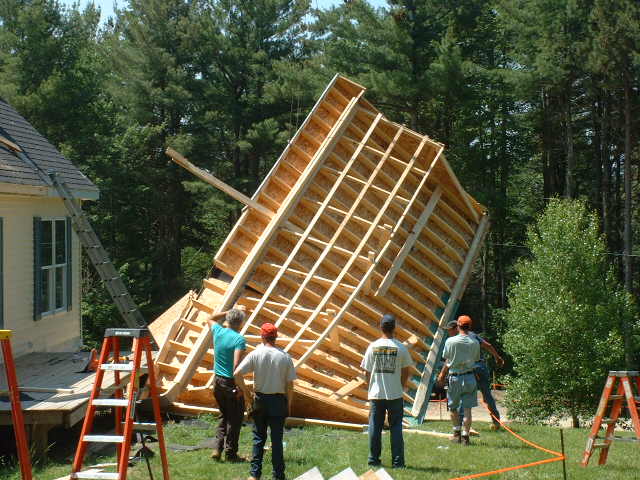

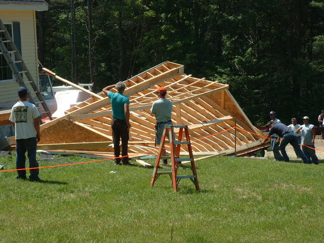

Been framing the deck all week for my new, on site stick built house. Its the only way to go, (you can see exactly just what is going into the structure) after having the nightmare modular home removed from my site, via a joint effort between modular home company and the selling dealer after filing fraud charges against both of them in Federal Court and reaching a settlement thru medation before trial where they would remove the house and refund my purchase costs. Federal court was because 3 different states were involved, the manufacturer was in PA, the dealer in NY, and the house was delivered just over the state line into VT.

By the time they were done I had a structural engineer's report that the house had to come back apart to be reset correctly (which of course entailed destructing the childs play constructed porch) and had estimates from local contractors ranging from $30,000 to $50,000 to redo everything to make it right. The set was so poor there was a 3/4" gap between the halves in the master bedroom (right over the underneath garage bay at that) only covered by carpet and the house hung off over the foundation in front. Upstairs one half was a 1/2' higher than the other but they were even downstairs, the upstairs kneewalls weren't lined up and the basement lally columns were set in the wrong locations for structural support. Now get this this, this ass**** says to me the reason they ended up in the wrong location is because I WASN'T THERE TO TELL HIS WORKERS WHERE TO PUT EM.
