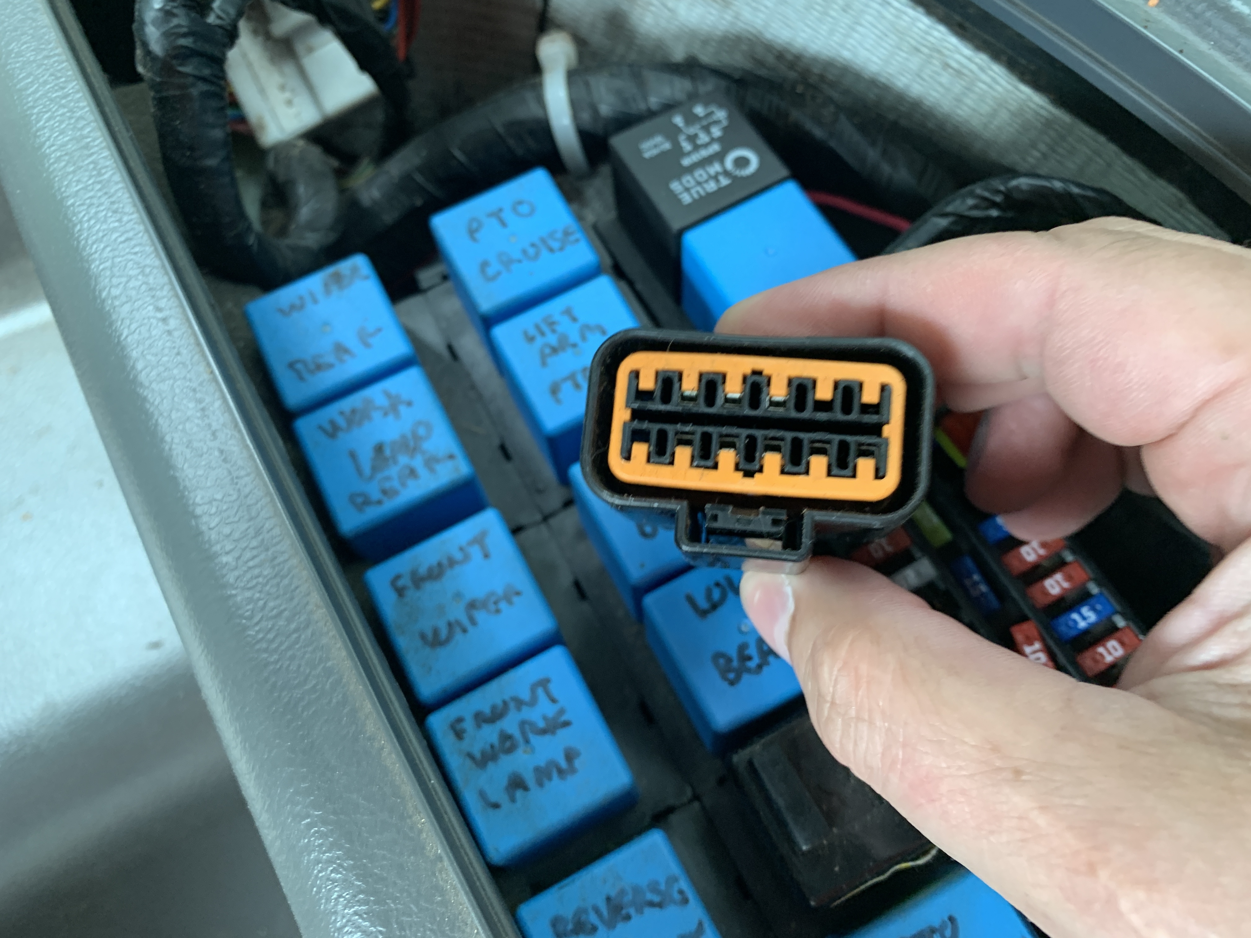

Anybody happen to know what diagnostic adaptor Kioti uses on their NXs? I have a bad injector and want to see if the computer happens to know which one using a Launch Pro Touch.
FWIW, the connector on the tractor looks like a Molex 33472-1201 MX150 12-Pin, female, without the two notch tabs on the outer connector.

So it is a no-go for having the correct adaptor. It would be nice if somebody could identify the diagnostic plug Kioti uses. I suspect it is a Delphi engine management system since it uses Delphi injectors.
   / Diagnostic adaptor for OBD2 #36
I think this is a KUM PB625-12027 12-pin plug (Korean mfr) and here is an eBay listing for the F/M pair "KUM 090 Series 12 pins Male Female Waterproof Connector PB625-12027 PB621-12020"(Pardon Our Interruption...). If you Google those part numbers you will find more examples.

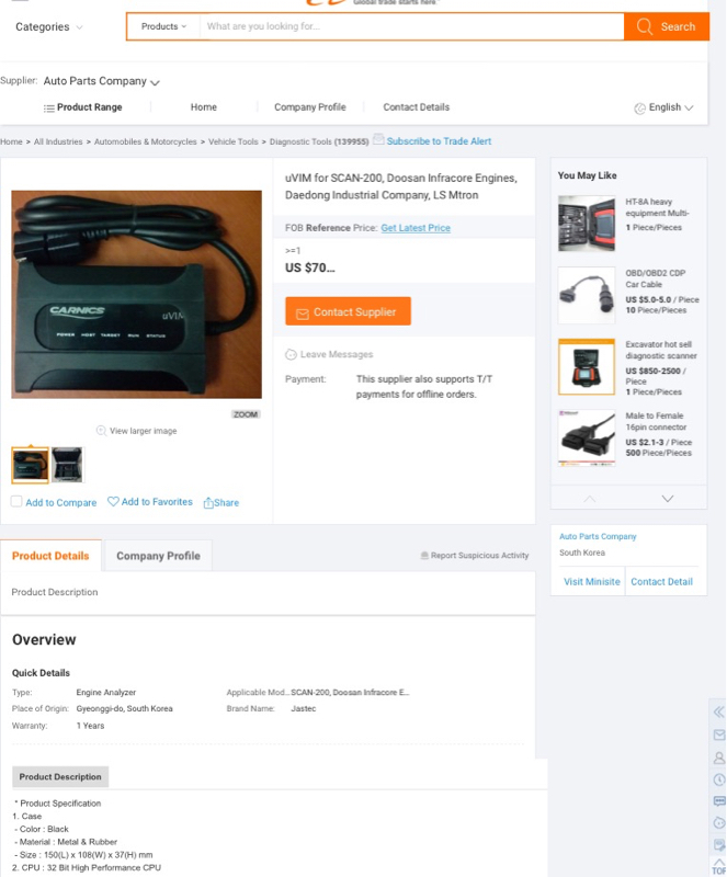

I believe the NS and NX series tractors use FT4Scan (password protected) with the Doosan (Bobcat) uVIM. The software for knockoff uVIMs won't have Kioti tractor models but they have a Tier 4 engine selection. Just a thought.
Thanks, I had forgotten about this. The password protection is what prevents communication. Not being a programmer, the password protection has stopped me from pursuing getting the FT4Scan software and the adaptor cable needed to communication with a PC laptop.

That plug a few posts back is for the transmission control unit, not engine.

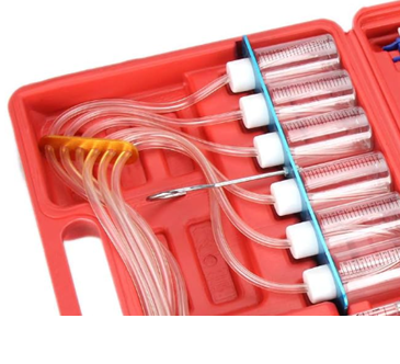

As for checking your HP common rail fuel injectors the best test you can do is a backflow test on them. Unhook the injector return hoses, pinch off the injector return line towards the front of the engine and hook up an array of bottles with hoses going to the injector returns (like see in in picture). btw you should not need to use the injector return hose clamps for this test. Start & run engine for 5 minutes with bottles attached. Watch bottles. If you get over 30 ml in 5 minutes on any bottle you have a bad or clogged injector. All injectors should flow the same amount of fuel if one is out of whack you will know it.
I've done this test with water bottles and they instantly would fill, due to clogged injectors.
