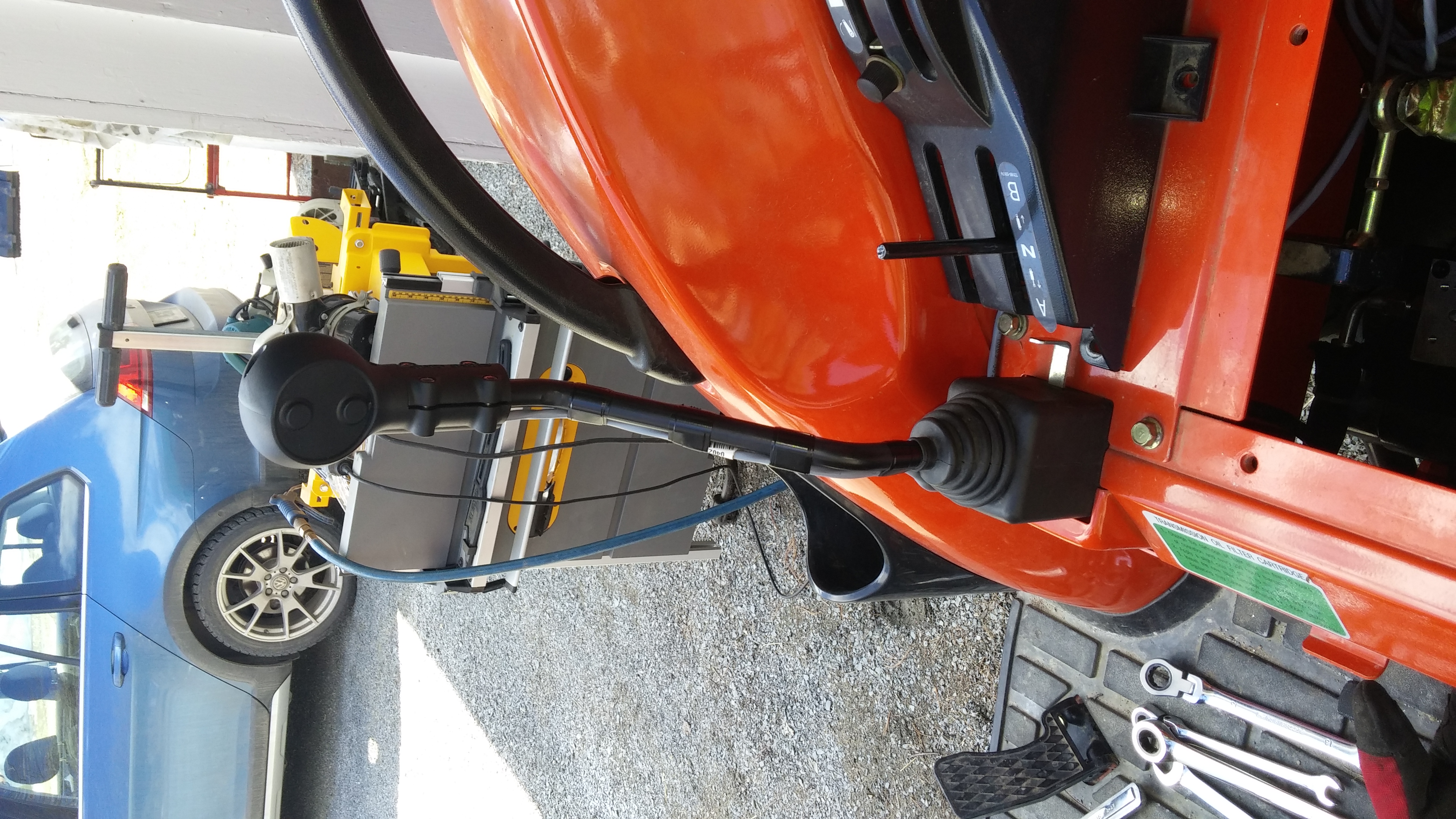

Hi Steve

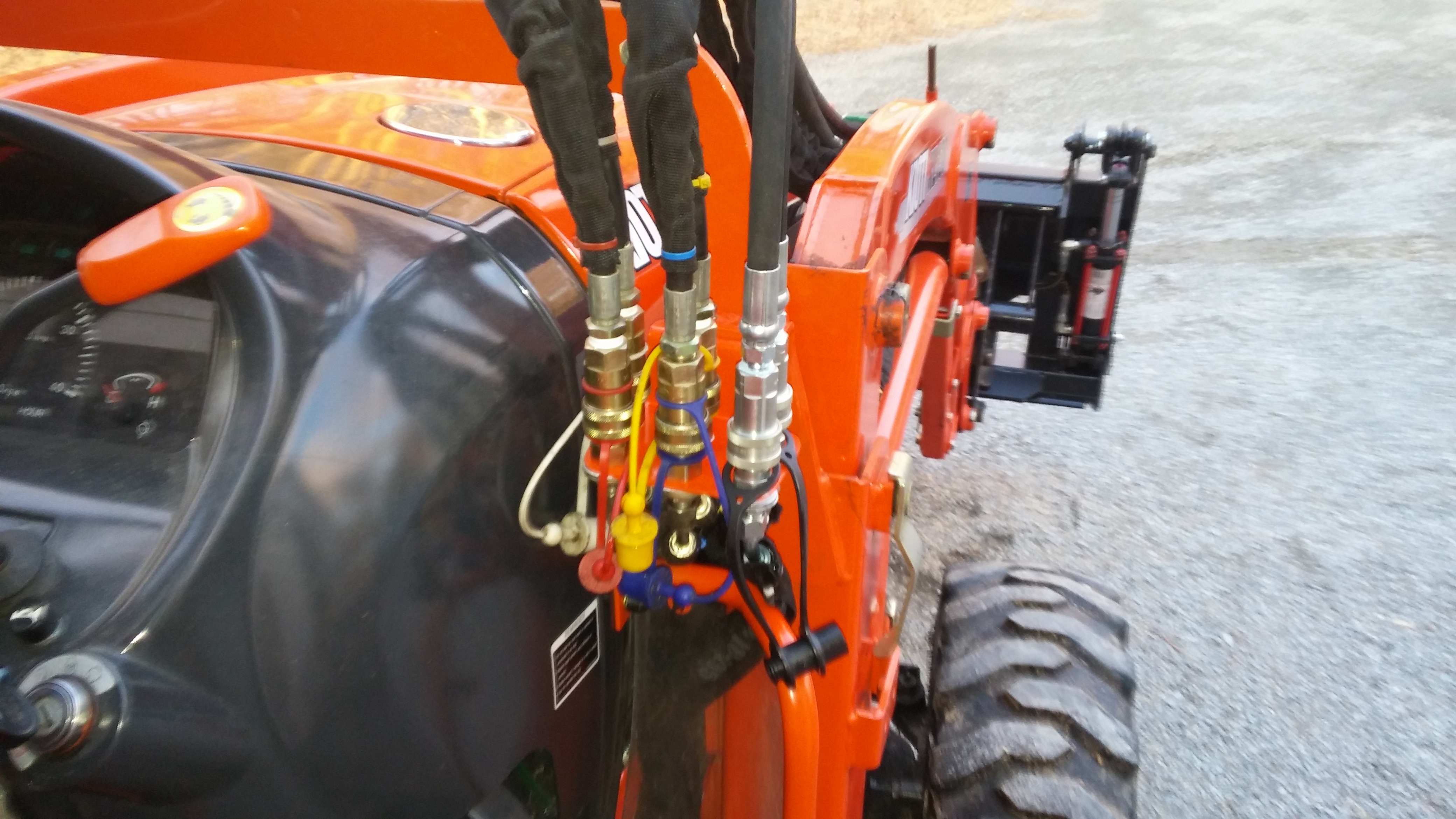

Thought I would post how I am making out following your method, got most of the plumbing done today and also made up my QD attachment plates, almost looks factory!
I am mounting my valve down On the bracket that holds the hydraulic filter it gave me good access to run the lines forward to the loader valve and also tie in 1/2" steel HYD lines for the power beyond circuit. Next weekend I will get the steel lines run and the electrical done. Don't think that I will need to use relays the valve only draws 2.5 amp at 12v and the switches on my handle are rated for 3amp at 26v so I will see how it goes without them. I ordered up all my fittings and hoses from Discount HYD online, all of the hoses worked out good on the length I measured them out with Air line before I ordered. I ordered the valve and manifold plate from surplus center and got the Handle from sure grip controls through a local dealer, it is their new AU handle.

That is looking great man. I looked at that same mounting position and I really liked it, I was just afraid we didn't have tools beefy enough to deal with that thickness on the bracket but I sure wanted too. That should make running lines a LOT easier. :thumbsup:
QD plate and the plate on the loader tower both look awesome! I looked at the specs on that handle last week (I think you had posted about it somewhere here) - Looks great and I agree that you shouldn't need relays with that one.
I'm looking forward to seeing the rest of the work once you're done. I appreciate you following up & adding your take to the thread.

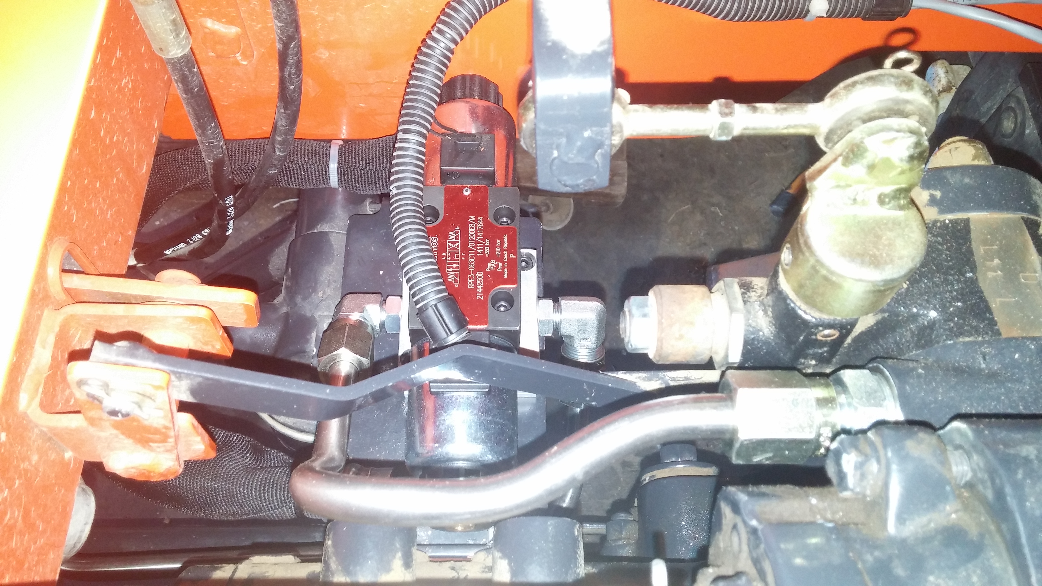

The bracket actually wasn't to bad to deal with. 4 bolts to remove it then I drilled and tapped 2 1/4-20 holes to mount my manifold to it. The fun will be bending the hard lines, not a lot of room for checking and measuring, luckily I have a bunch of leftover tubing at work so I can do multiple tries!

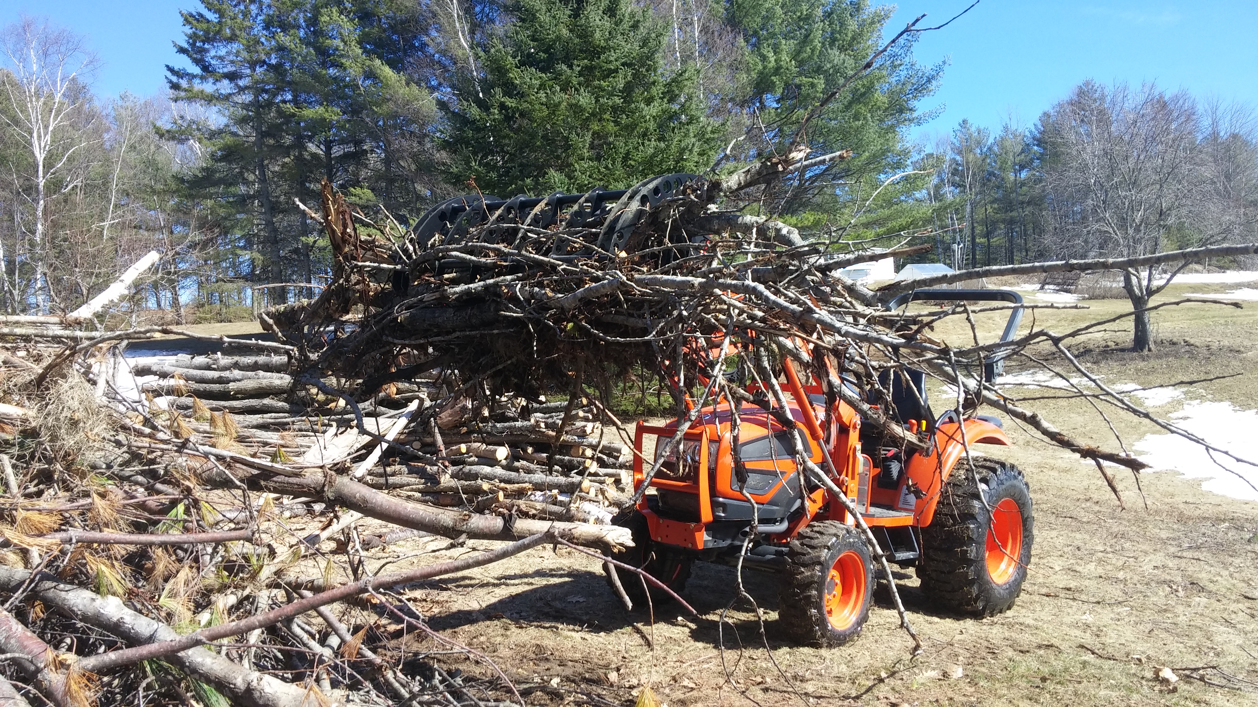

Well finally got my install wrapped up and the grapple works great spent a couple hours moving an old brush pile in my field to the burn pile I have on the edge.

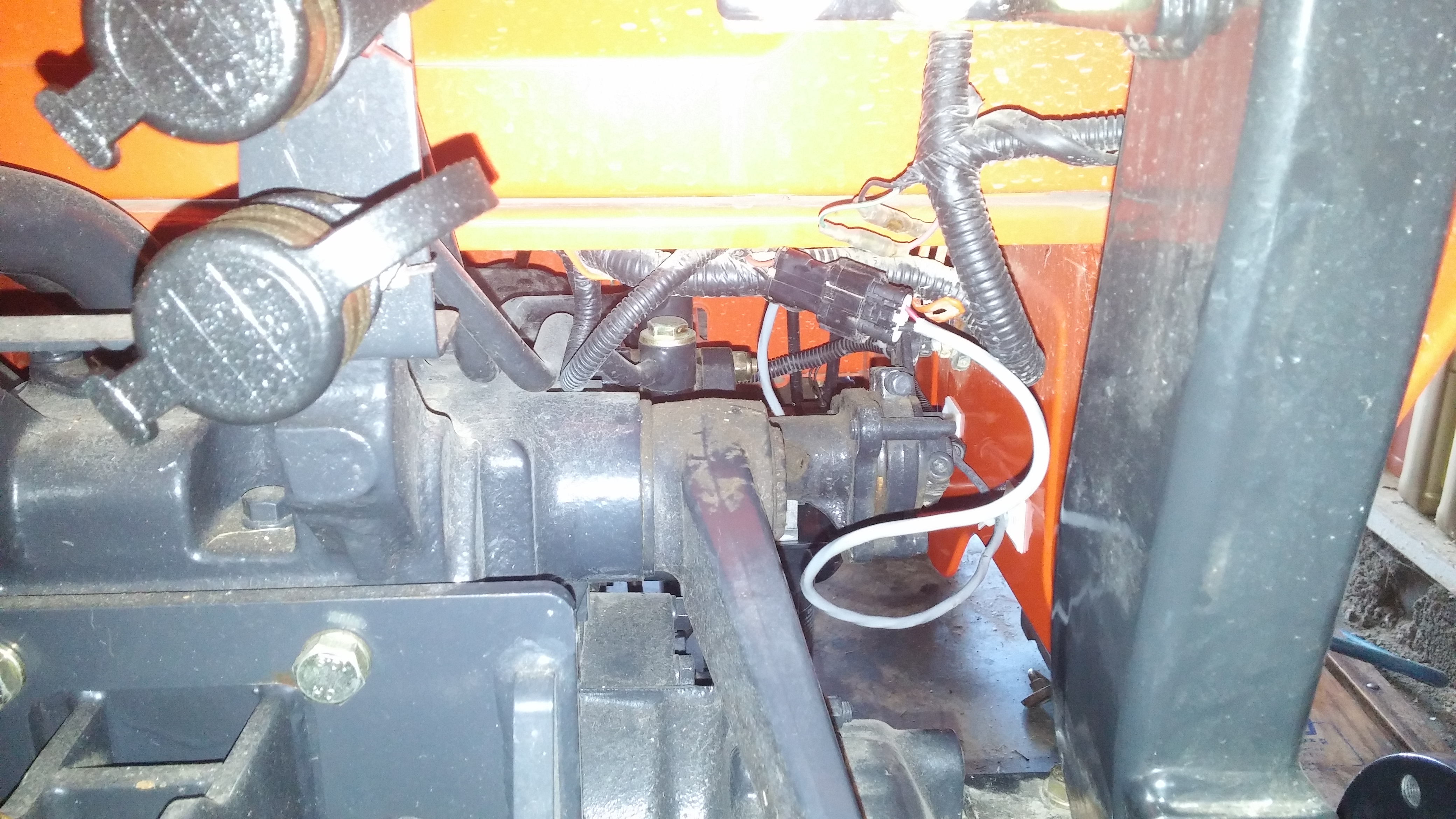

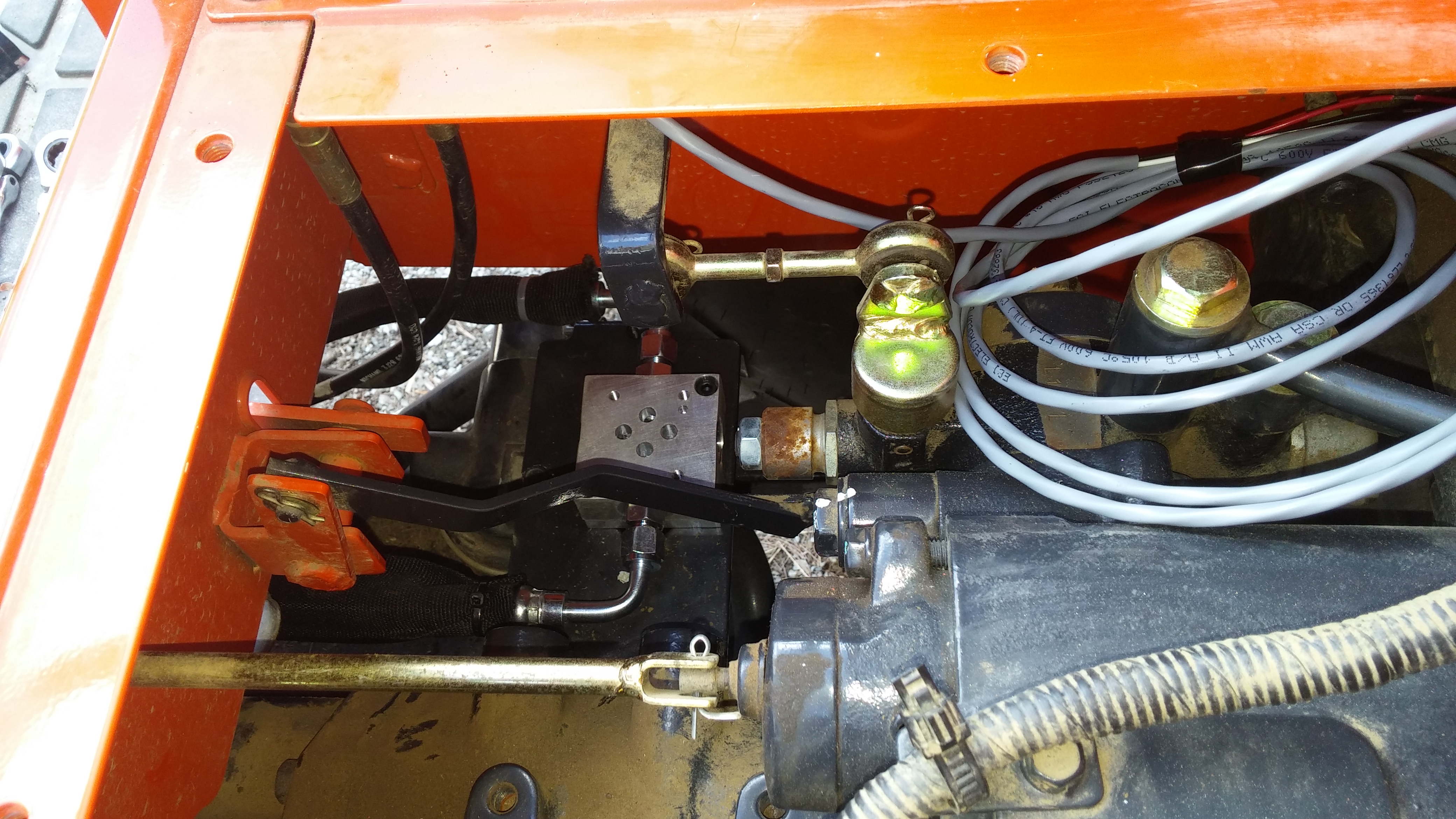

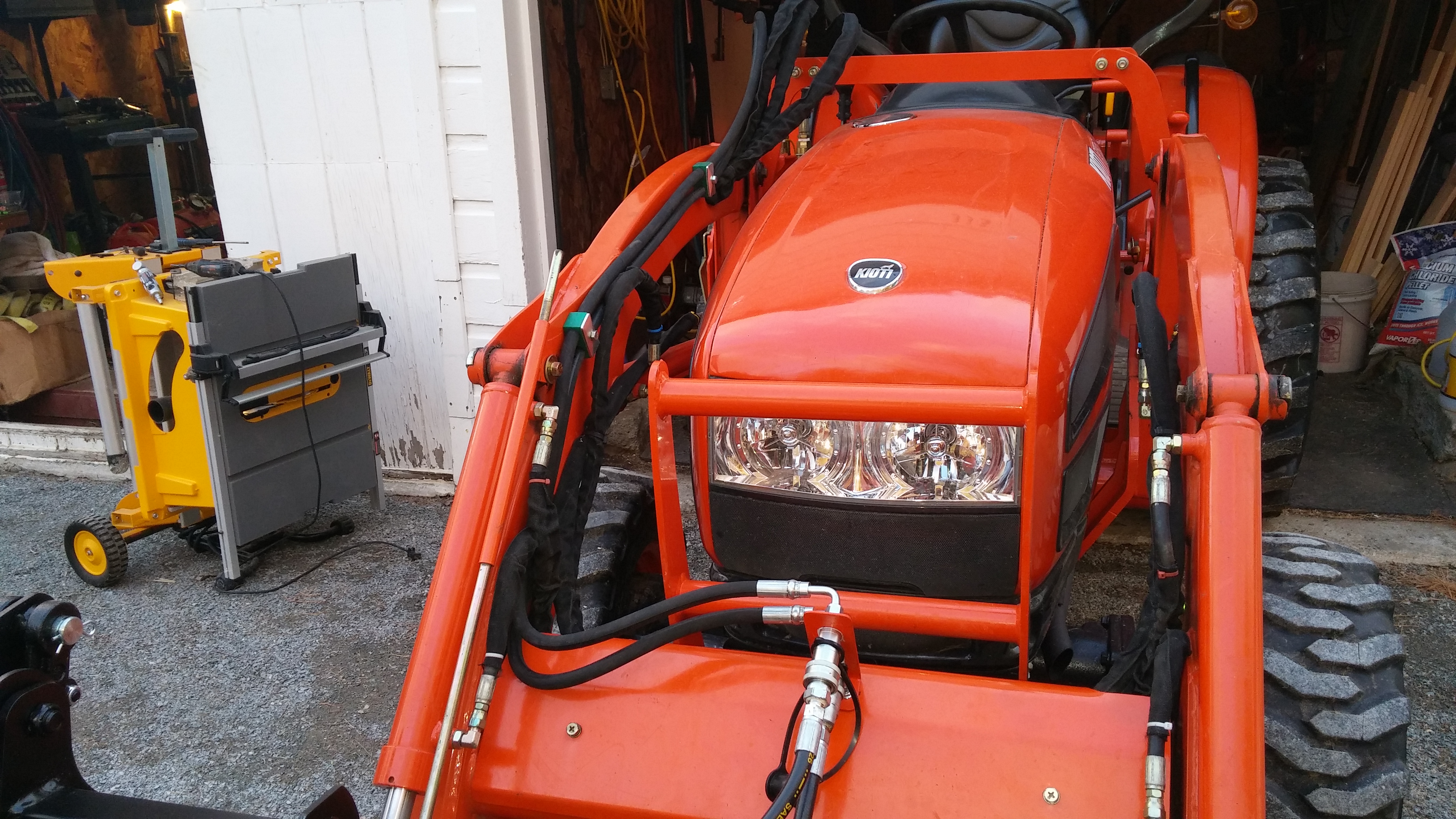

Most difficult part was getting the 1/2" steel tubing lined up and bent correctly to line up with the fittings in my valve block and the fittings on the tractor. In the end it came out very clean and should work well for a long time. I was able to find the correct connector to fit the user electrical plug on the back of the tractor so it was easy to tie in for the valve power and as a bonus it was already fused.
Valve block installed and plumbed Hose from Tport on valve block to the rear-end, was fun getting it around the diff lock linkage.
From loader valve power beyond to my valve block
With the valve installed and power
User elec connector

Man that is awesome work. I wish I had the tools / skill to put in hard lines - it looks so much neater / cleaner that way.
And isn't that diff lock linkage a B****ch ?!?! Even with soft lines I had a terrible time getting around that thing in our mounting location.

Thanks Steve, It was a fun project but wouldn't want to make any kits it took me 3 tries to get the bends correct, luckily I have all the tools and spare tubing I could borrow from work. The other big challenge was getting the correct fittings, the place I order them from sent me the incorrect tube fittings 3 times, finally I gave up and was able to find something that would work local.
