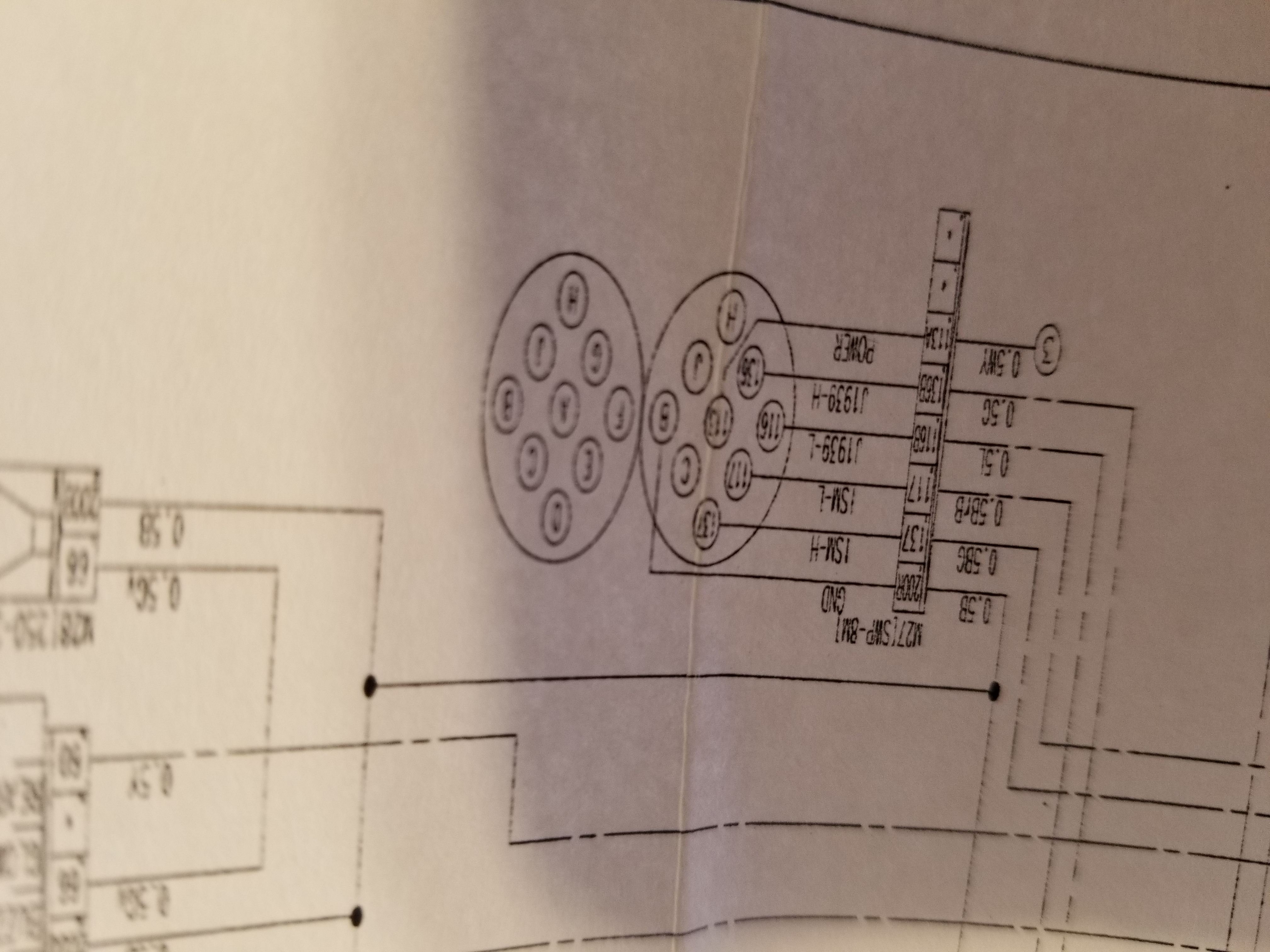

Have adaptor on order , power checks out with meter and diagram from service manual shows it should ...Will post out come.....

Wire diagram looks right , voltage + 12 and ground on the right pins ...data stream listed in manual as J1939 . Standard diesel ecu format......should work will know by this weekend.....

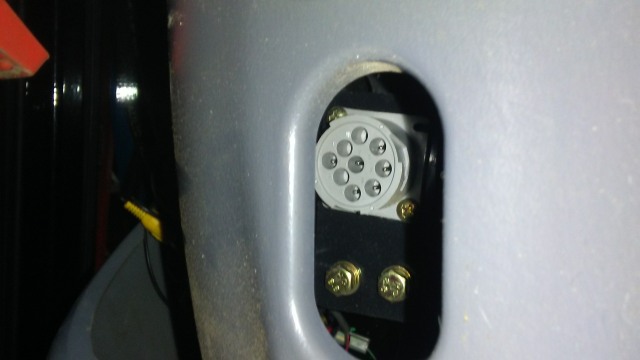

Can confirm it will read/clear DTC , only works with HD OBD ... i created faults read live , read codes and reset codes than read and cleared history this part works great ...a basic HD OBD with a DTC library is all you need , mine READER includes HD DPF, HD SERVICE and standard OBD/EOBD These functions are not available on this tractor. My other scanners would,n't connect,

Basically as long as it is an HD-OBD scanner and has a cable that fits the obd2 plug on the adapter I would think it would work ...did notice that the company we ordered the adapter from will make custom adapters...
...one more point. this should work on any equipment having the catobd2 Deutsch 9pin unkeyed plug (UNKEYED being the KEY word )New Holland, cat industrial and such ....(most HD Truck.. ....scanners will come with muti plugs mine has obd2 /a/ keyed 9pin Deutsch and a 6pin Deutsch) AND now with the adapter a UNKEYED 9pin Deutsch
