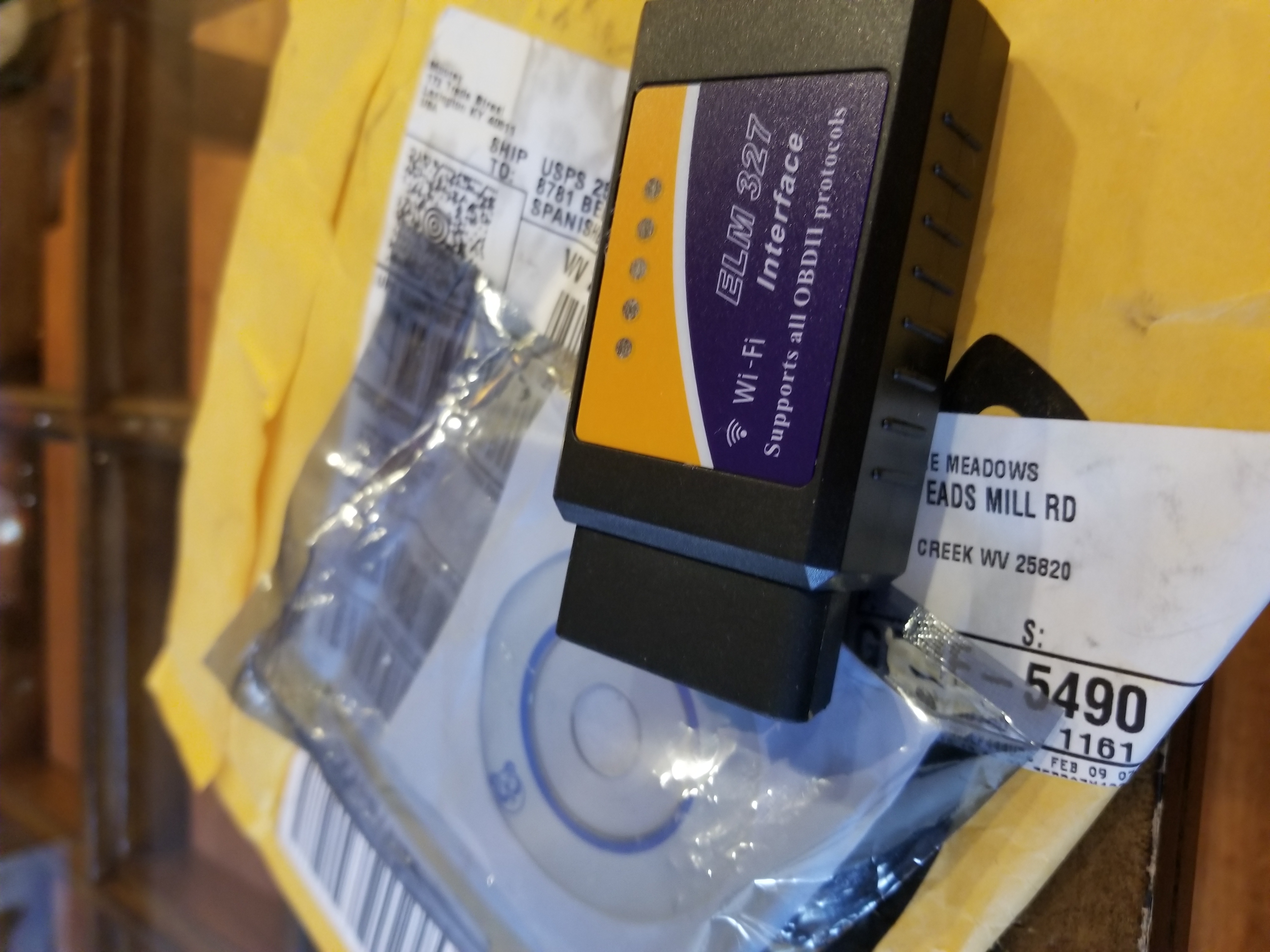

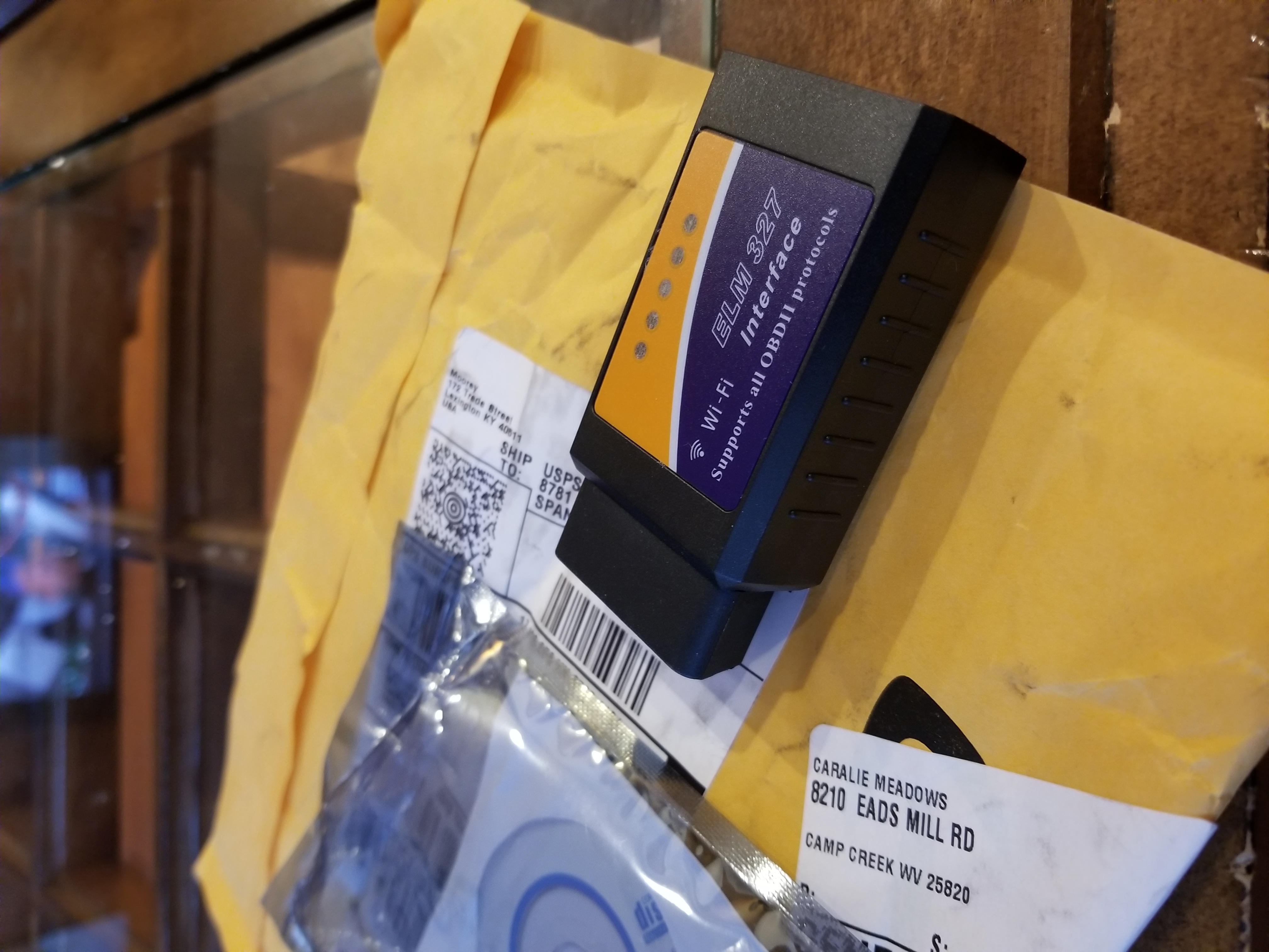

I'm really late to this party, but I know I'm not the only one reading this thread for info, so I want to chime in. Like @George2615 , my 2016 LS XR4145 has an automotive-style 16-pin OBD2 connector hidden behind the center kick panel. I'm guessing it does use the J1939 "heavy duty" protocol, though, because my normal OBD2 scanner (Innova 3140) won't talk to it.
On a whim, I plugged in my little $15 Amazon Panlong bluetooth OBD2 dongle:
and connected to it with the Car Scanner Pro app on my Android phone. I'm not sure if the $6 "Pro" upgrade had any effect.
To my surprise, the app connected right up to my LS tractor. I was able to scan codes and view live data. I'm not having any problems with the tractor, so I couldn't do any exhaustive testing, but it seems to work at least for that simple stuff.
