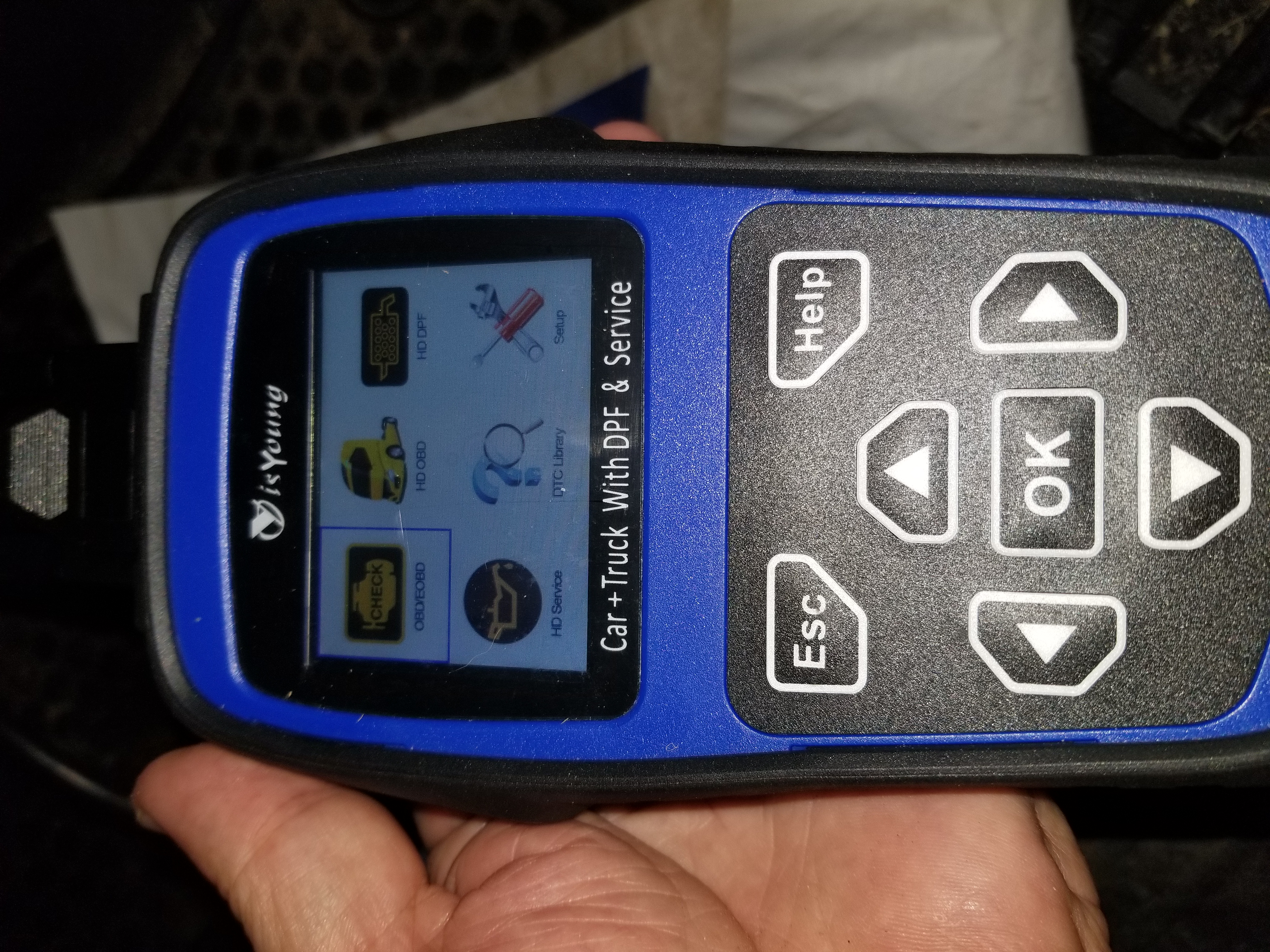

Checked adapter on some CAT engines with the NL102 scanner ...worked well could reset/read as well as view live data ...
   / Diagnostic code reader #72
Now if the NL102 will do the same on your LS we'll have something.
If it works I see the NL102 isn't too expensive and would buy one.

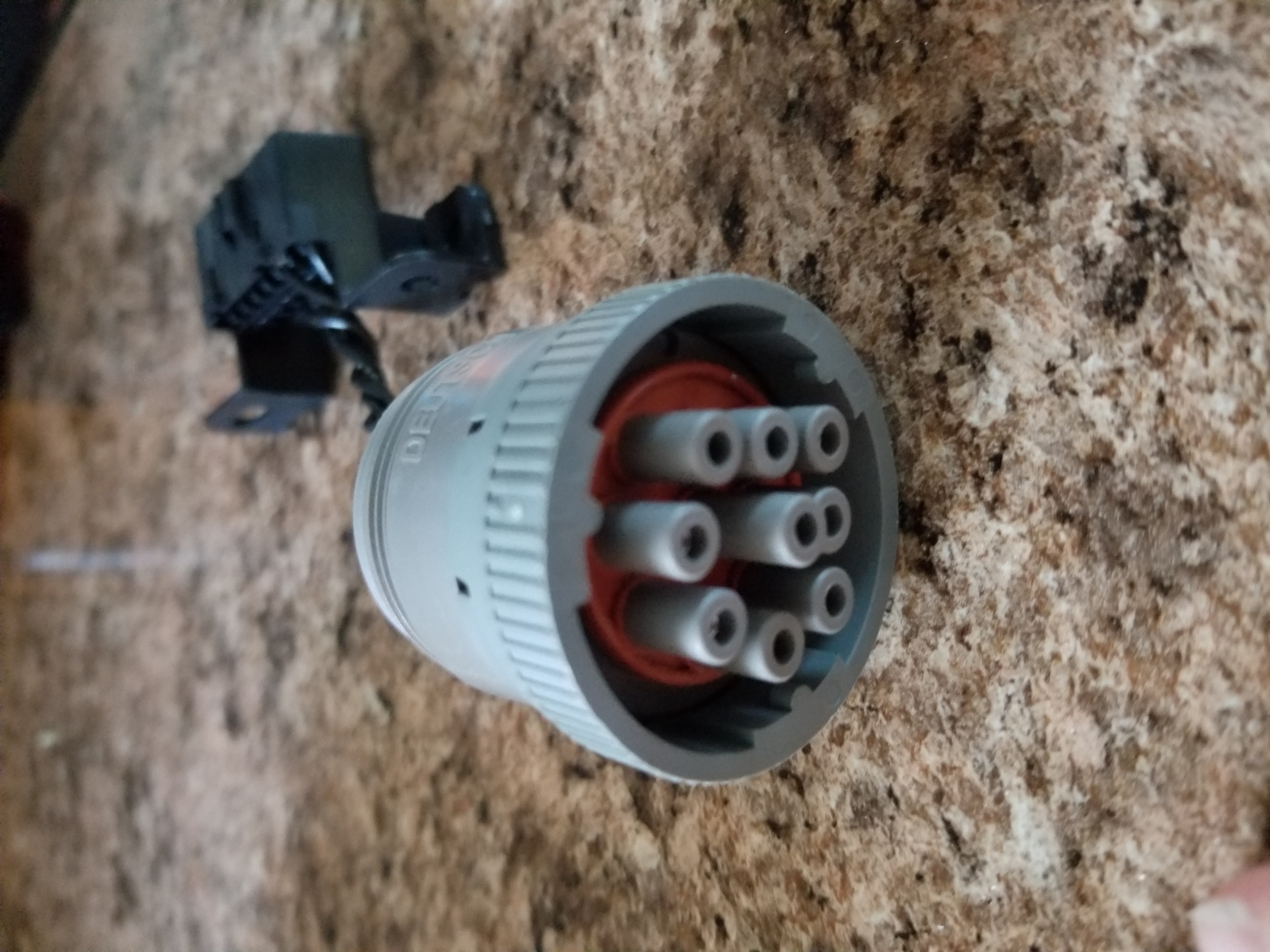

hi guys,i have 2014 xr4046hs,trying to get code reader to work.i found on my tractor connecter the pin A is 12volt and pin B is grd.according to all the pictures i found online pinA is grd and pin B is 12volt.this is the 9 pin connector.can any one tell me if pin a is power or should it be ground.its the middle pin.. thanks

I did not need to do any work with pin out's or anything of such sort. I just plugged in the reader with the OEM OBDII cord and it worked fine. I'm out of town until Sunday but when I get home I can take a picture of the reader I have and post it so you can see which one it is. it was really incredibly simple to use.

thanks mines the nexlink nl 102 it should work
my duetze 9 pin connector on tractor is probably odd ball j1939 type 2?dont seem be any info about this one.its possible this is the year that they went from 6 pin to 9 pin.not sure what ill do now.hate buy another reader
