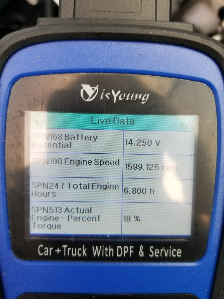

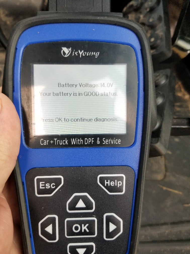

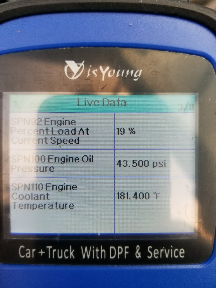

just a snapshot of my hd truck scanner

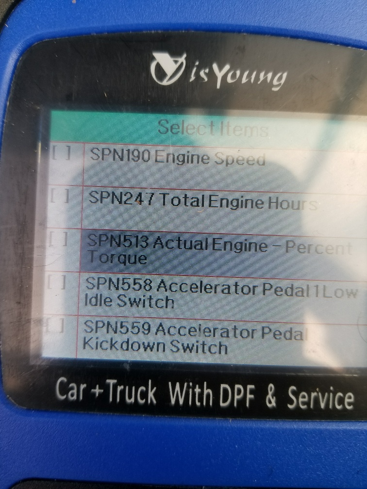

ELM324 scanner wouldn't read live data on my tractor , May be able to reset trouble code but that seems to be about all , recommend an HD truck scanner that can read J1939 protocol

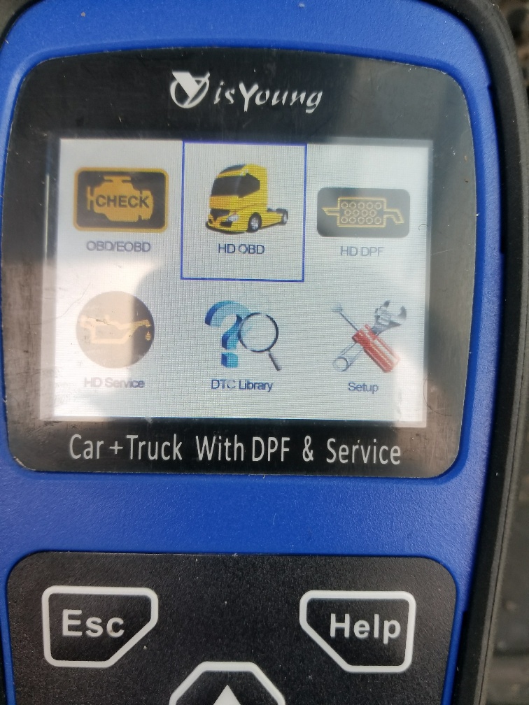

Use the HD OBD for the XR4000 Models LS Tractor
   / Diagnostic code reader #55
Pretty much the same snapshot readings I got using the Cummins app and ELM.

   / Diagnostic code reader #58
I didn't get any live data. just a snapshot. Here's what it found on mine.

   / Diagnostic code reader #60
The only things I typed in was my vehicle name LS XR3037HC which is shown in the first line at top of page and engine size of 1.5L. The program found the rest. I took 5 snapshots to make sure it was seeing changes such as coolant temp. etc.
