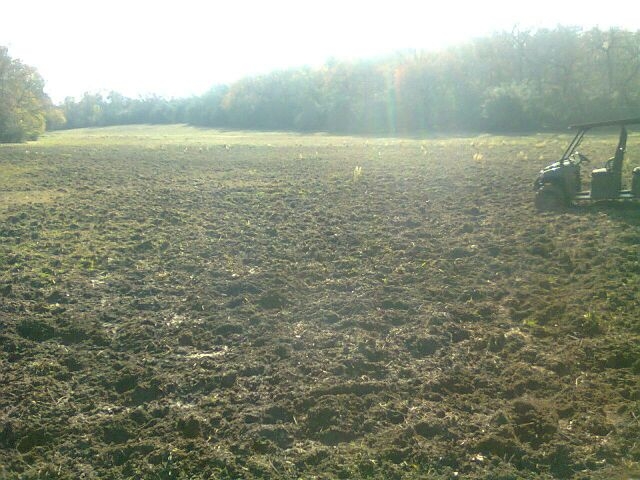

This one of the places I replanted hog troubles.JPG I done did the part they tilled earlier this year,I done the far green in picture this past weekend in common bermuda.
You think you got hog troubles:DDont wonna even see the bad spots....
Trappers working on them 22 so far this year

This one of the places I replanted. I done did the part they tilled earlier this year,I done the far green in picture this past weekend in common bermuda.
Foreman, was the tilling for another crop or do you always till when planting hay? Are you mixing in manure or fertilizer?
Sorry I ask alot of questions:ashamed:.
I didn't quote the second half but are the hogs wild, you mentioned trappers. Can you "eat them"?

Wild hogs is what destory the pasture(in picture),run tiller over it to bust up clumps of grass,then I seed then run my 12ft drag, gives it a smoother/even surfice and then run my 12ft roller over it. As for the other pastures the NRCS states prepared seed bed and couldnt get the guy that was to no-till drill last month,to return a phone call I had to till it instead but it was thin has some coastal in it in spots. Guess I will have to find someone to no-till the 40acres next year cause im not discing the whole thing up and starting over,just getting the bare spots this time around...
I will liquid fertilize/2-4d myself,when it starts coming up and a chance of rain.Looking for chicken litter but with fertilizer cost you cannot find any that isnt already spooking for.
Dont worry about the question,I ask several myself,always nice to talk and learn on here...

This one of the places I replanted View attachment 266127 I done did the part they tilled earlier this year,I done the far green in picture this past weekend in common bermuda.
Looking good ... hard work and time will reward your efforts ... keep after it.
I'm lucky ... no wild hogs around me !!!

My opinion ... any crop, including hay must have a seed bed prepared properly. I have the best luck putting my fertilize on when the new crop is has a good start and then I apply the fertilze per the soil test for that crop. I live by the weather forecast and try (key word) try ... to put the fertilize out when the rain is forecasted.
