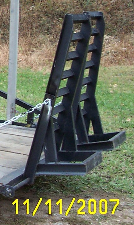

Posts on TBN made me aware of the danger of the process of loading a trailer when a ramp fails or moves. Does your trailer have anything that locks your ramps in place when you are loading or are you planning to add something?
   / Did I purchase the right trailer?
#55
No, we have a channel that the ramp lays in but this is unreliable. It is a must to get proper placement of ramps, wheels of tractor and latch your safety belt when loading and unloading.
   / Did I purchase the right trailer? #56
My trailer had a similar set up. I modified it like this. The tube holds the ramp in position to the trailer, but the weight is carried by the leg extension on the ramp.
Someone else may have a less invasive method to keep those rails in place.
