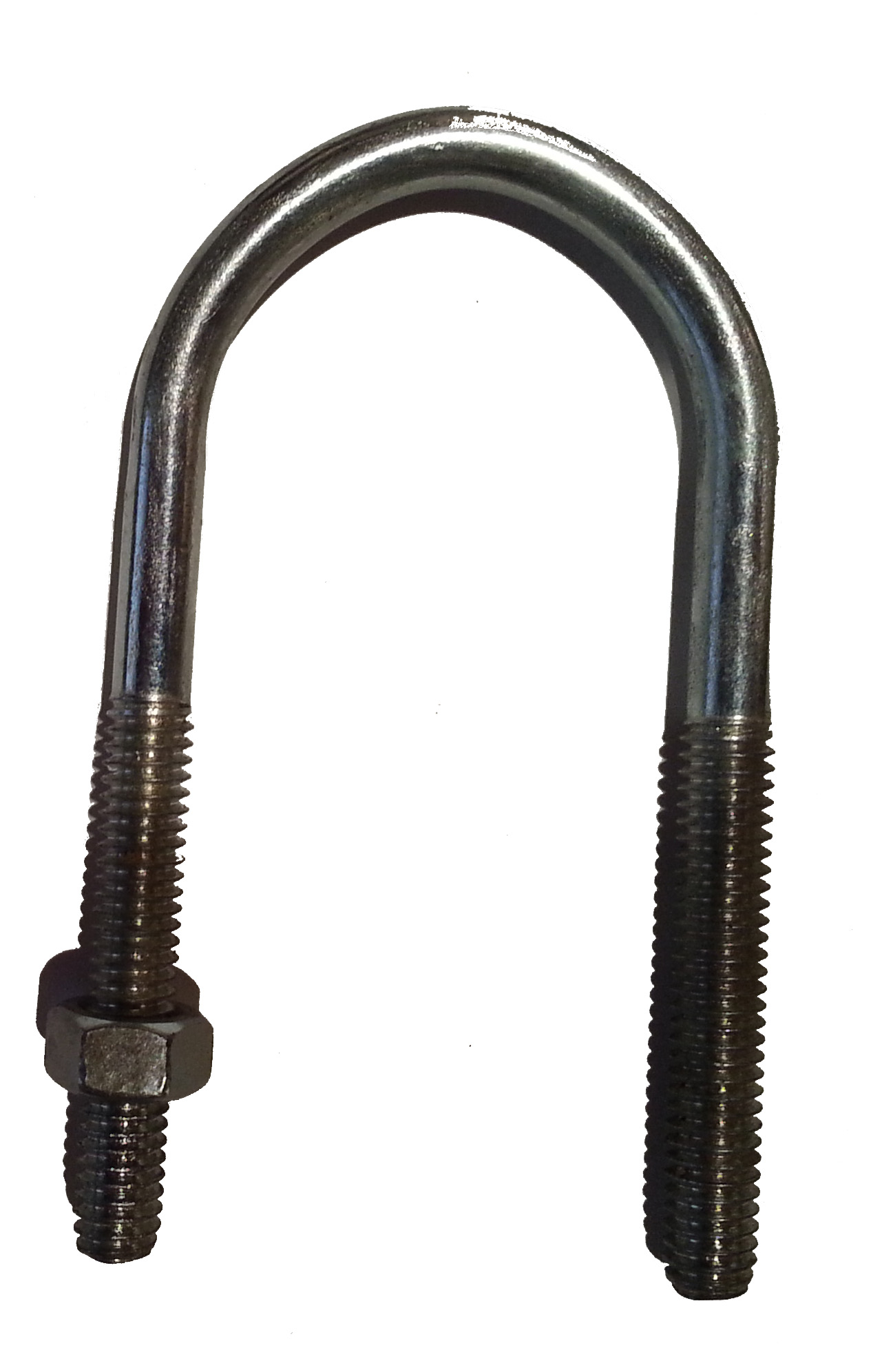

I spent a couple of hours today getting stumps out and found this 4" u-bolt on the ground where I was working. I can't imagine what else it could have come off of besides the tractor or backhoe, but I also have no clue where a u-bolt would be used. Any ideas?

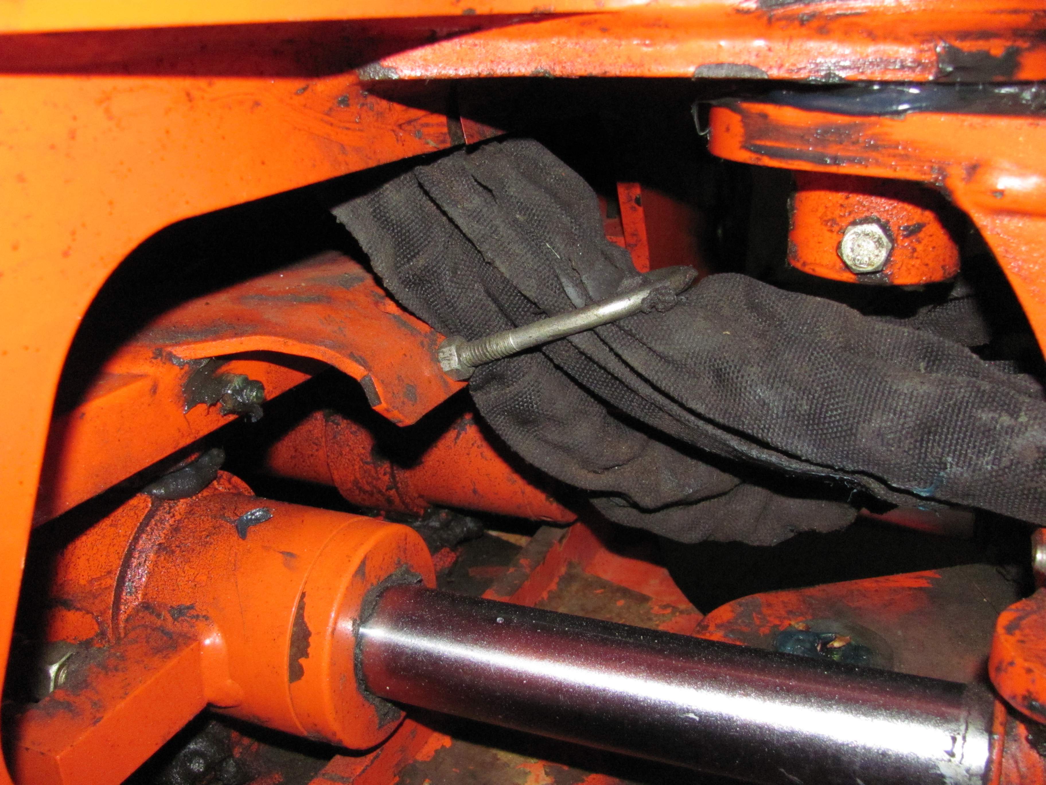

It looks like the U Bolt that is used to corral the hyd hoses near the back hoe hinge pin. MY DK35 hs two of them, guides the hoses from the tractor to the back hoe hyd cylinders.

Thanks to both of you. With the help of the picture I was quickly able to find where it goes. The hoses covered the holes, so I doubt I would ever have figured it out without the picture - 1000 thanks for taking the time to post it.
