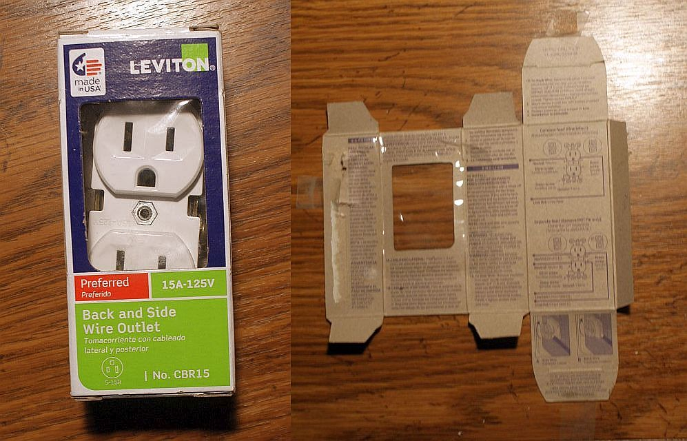

Did you know Leviton has instructions inside the box on how to install receptical
   / Did you guys know this about outlets? I didn't! #49
The instruction illustration is ground down. The diagram on the box cover is ground up.
Bruce
