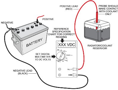

Finely got around to changeling out factory antifreeze. Not for sure what type was in in from the factory , .Manuel calls for an "PG" low tox but this stuff was green ? Going on my third year and the antifreeze was already reading ( .6 ) volts DC .notice a small amount of slime , antifreeze had only been topped off during dealer service , so not really sure where the slime came from...my Manuel did called for a fluid change after one year to remove contaminants from system which I didn't notice until I was looking for coolant specs ... ...anyway..flushed three times with distilled water and refilled cooling system with Peak Final Charge it's a reddish/orange in color ... ran out of time for today after letting tractor run for 20 minutes or so to mix coolant I shut it down for today , will check voltage and refractometer readings tomorrow after work , would like to thank the everyone that shared information , really helped a lot in making my decision as to what type of antifreeze to use.....

Proper way to check antifreeze condition
I have never checked coolant with a voltmeter, but would like to look into it. Do you have the reference chart referred to in the picture posted?
I do check the concentration with a refractometer, which I find to be much more accurate.

I will generally check for DC and AC voltage ....many things can cause stray currents to flow within an coolant system , dissimilar metals and out of range PH balance , missing block ground ,faulty alternator can induce AC currents. Just to mention a few .....its a simple test used along with test strips and refractometer...cheap Insurance just my humble opinion ...
