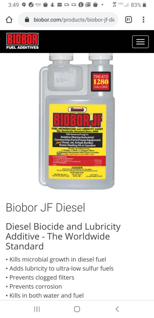

I didn't know any product would kill or dilute the algae after it was present in the system.
Here you go now you do think of it as a fungicide for fuel. I bought a 300 gallon contaminated tank a long time ago. Drained, shocked it , and fillled it and per Bio Bor's recommendations and keep it it treated never had a problem
Biobor JF DieselView attachment 651143
I may switch to this next time. I just used the last of my Killem Biocide. I've been adding 1 ounce of biocide and 8 ounces of Stanadyne Lubricity formula per 55 gallons at every fill so maybe the Biobor can do both for the price I was paying for biocide alone.
Just had my drums filled this week. The bottle of Killem lasted me 3 years so it's not a bad deal at $29.99 but the Lubricity additive was costing me another $10 per fill.
