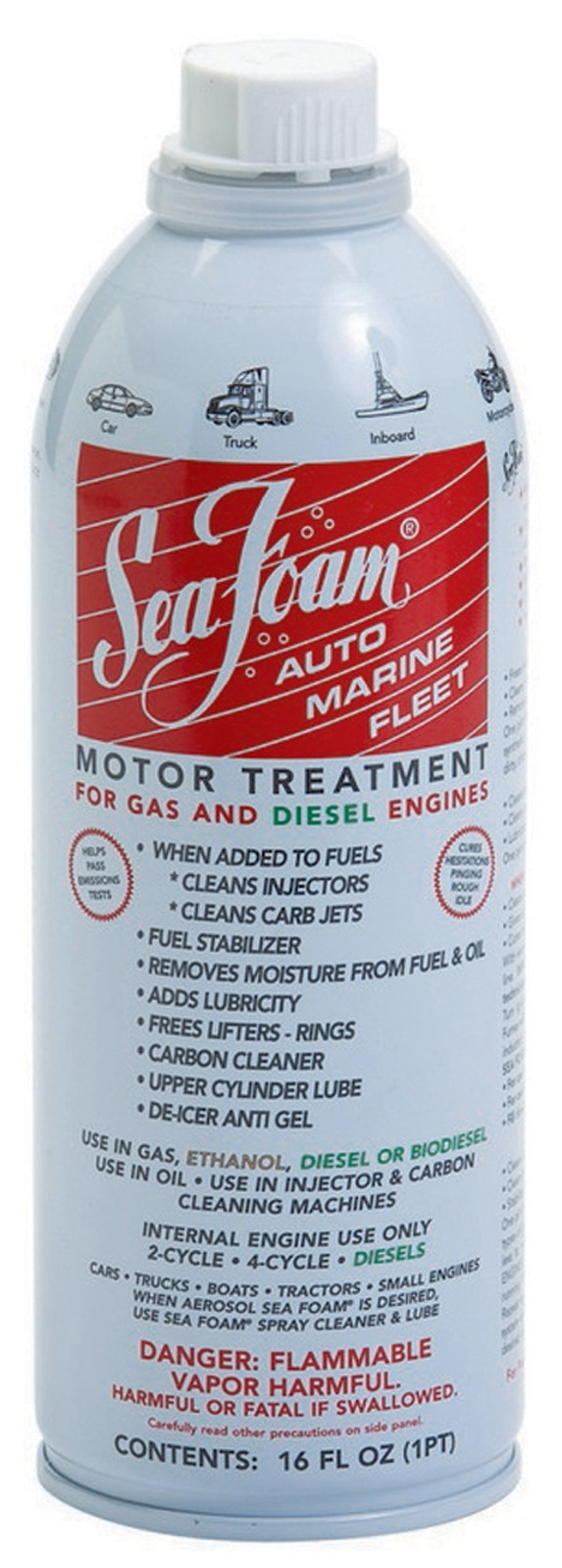

SEAFOAM :)
Best anti-gel I've witness for diesel fuel in a fuel tank. It will ant-gel 5 gallons in under 1-minute. Not so with PowerServe. And it doesn't take much either.

Really?!! Well that's good to know. I know PS does have a gel-buster you could use after the fuel gels, but I've never had to use it yet luckily.
