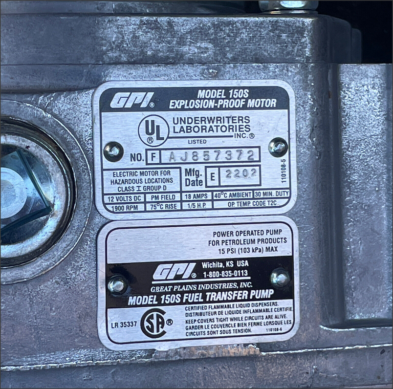

I use little over 50 gallons a year on mowing, wood chipping etc. and bought several used 55 gallon plastic drums and a 100 gallon steel tank over 20 years ago, the intention being buying off road Diesel fuel when the price is low and storing it in my barn.
I am currently using fuel I bought for $1.56 / gallon, and have enough for several more years.
!2V drum pumps like this are little pricey, but well worth it in the long run.
GPI (Great Plains Industries Inc.), and other brand 12V drum pumps can be found used on the eBay etc.
This is identical older but unused pump I bought for $200 last fall just to have an extra pump:

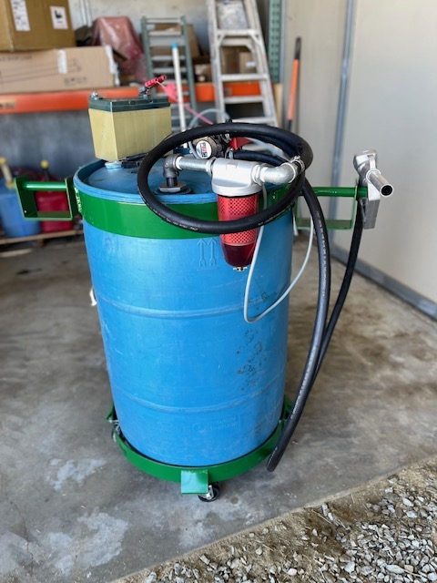

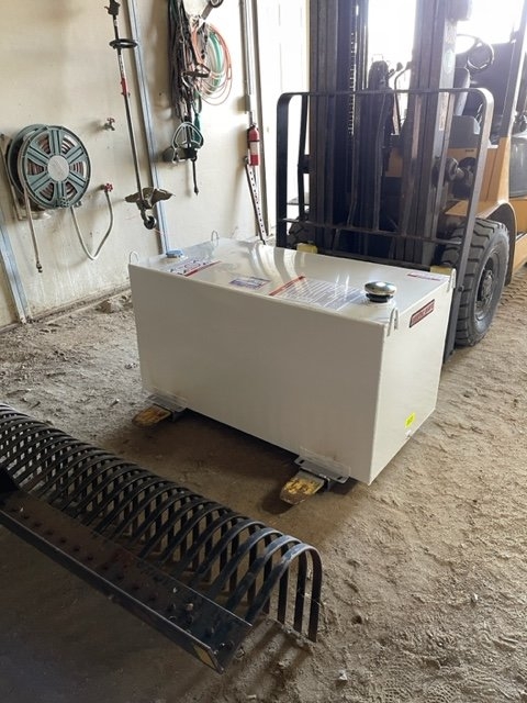

If you can justify the expense set up a tank or barrel with a 12 pump and auto shutoff nozzle. I was using a 55gal barrel but now use a 100 gal portable tank. Easier to transport than a tall skinny barrel.
