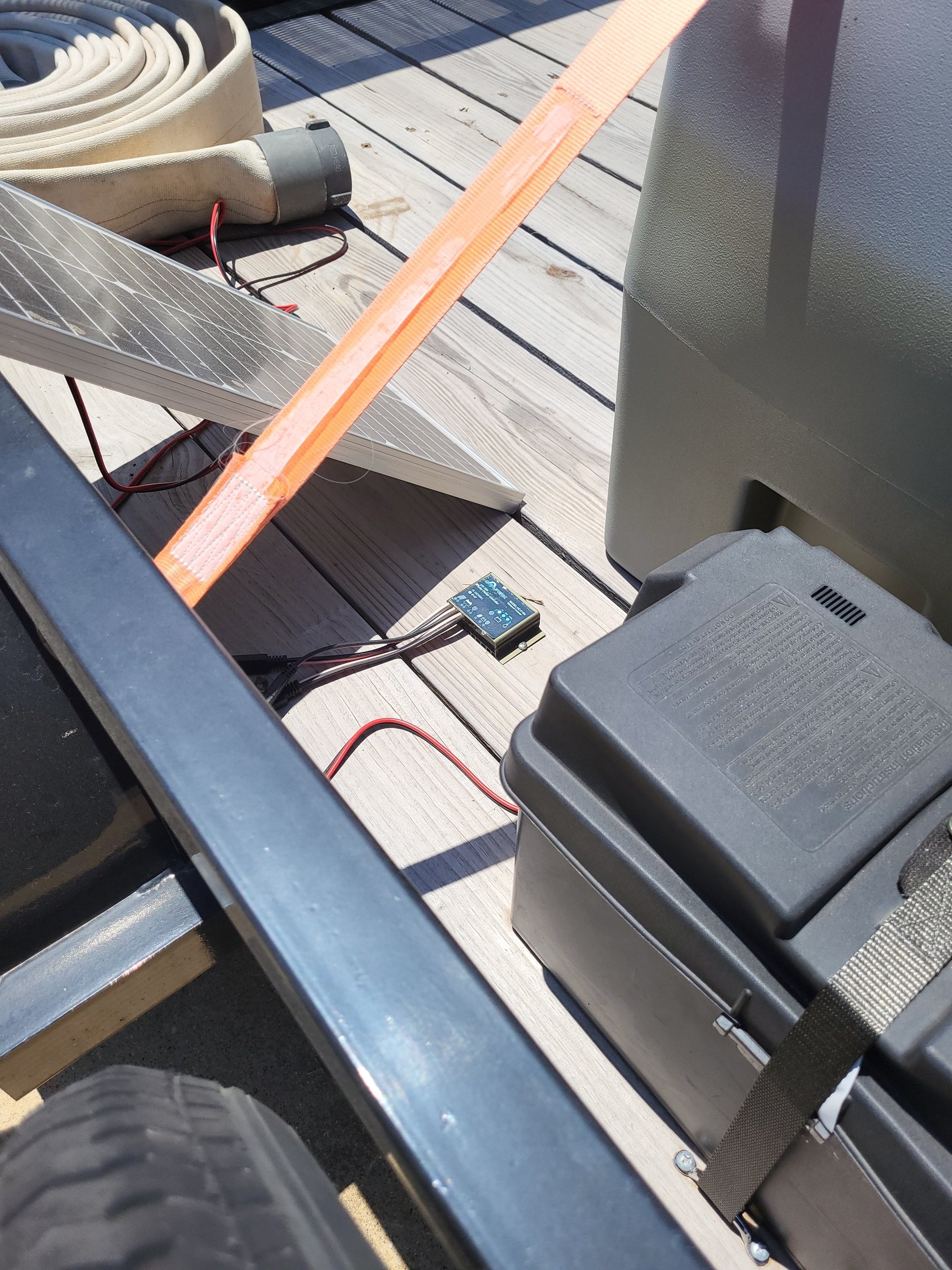

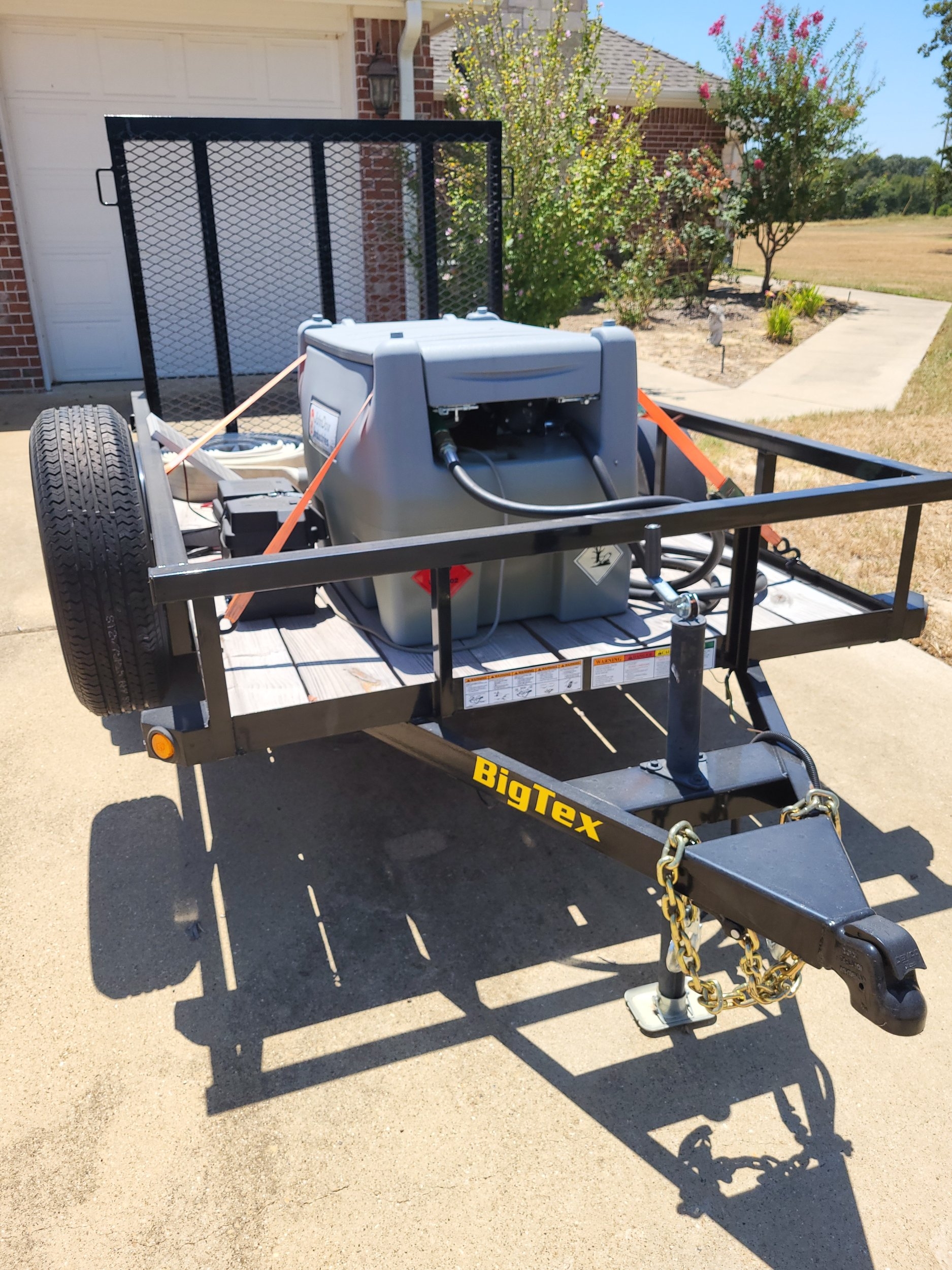

I went the small trailer route. I don't have enough faith in myself to not ding up the bed of my pickup with the FEL forks. I want to preserve that grocery getter look as long as possible.
Self-contained with the 58-gallon tank, pump, 13' hose with auto shutoff nozzle, a battery, solar panel, and a waterproof solar panel controller. I left the solar panel loose so I can take it inside during bad weather. The fire hose is not part of the package, the local FD had just dropped it off for me to cut up for strap and chain protectors.

That is the most elaborate fuel transfer system I've ever seen.
You could have some fun at the fuel pump if you pulled out the fire hose and asked the attendant where to hook up before you pumped your fuel.
