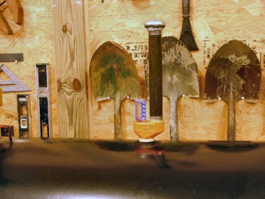

cowboydoc, how do your air vents prevent moisture from getting in? I am talking about the moisture in the air (humidity).
   / Diesel Fuel & Storage Questions
#122
This is a standard oil tank vent with screen, gage, and vent alarm combination. It won't do a thing to prevent the oil tank from breathing and inhaling moisture laden air.
