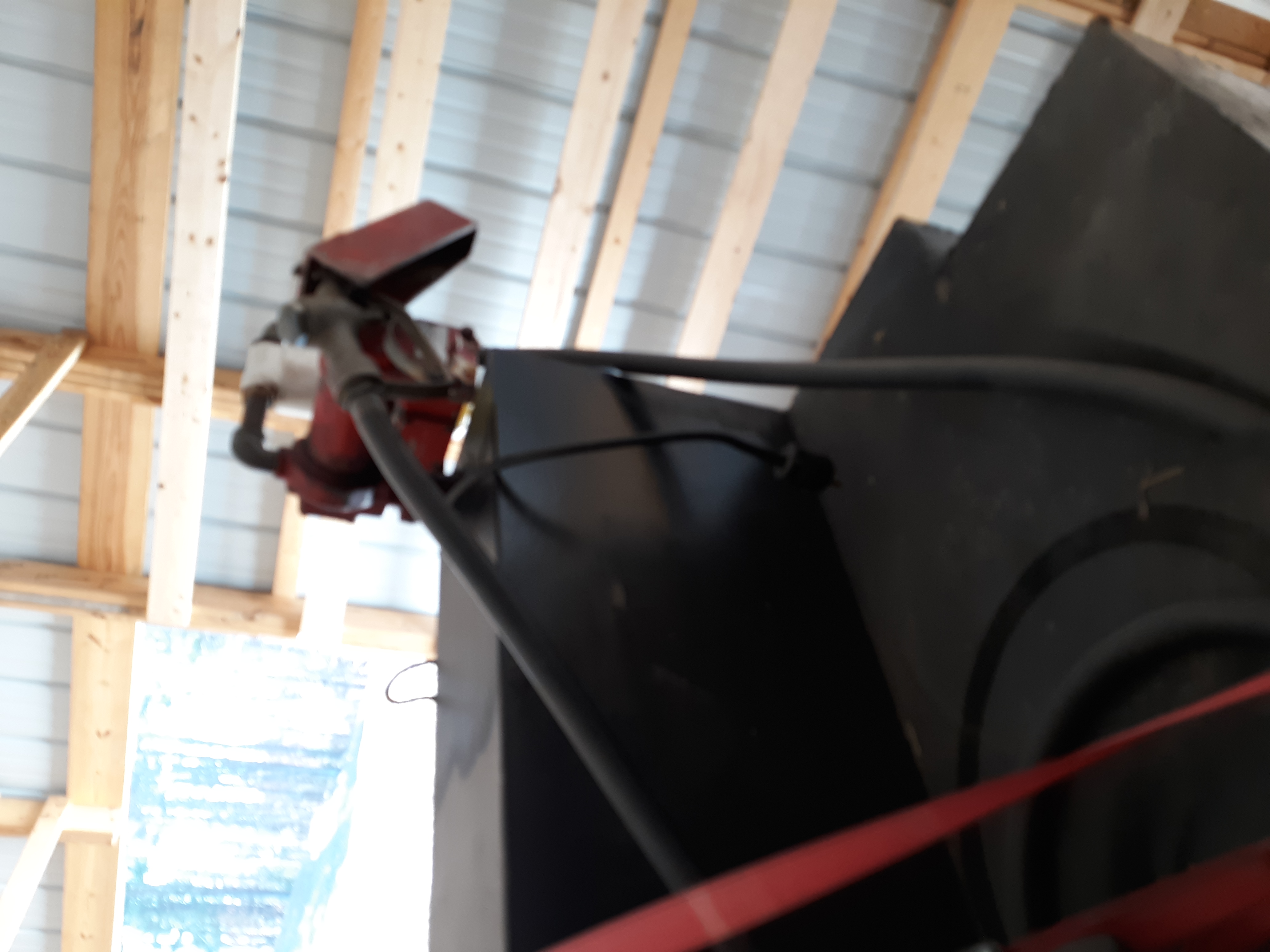

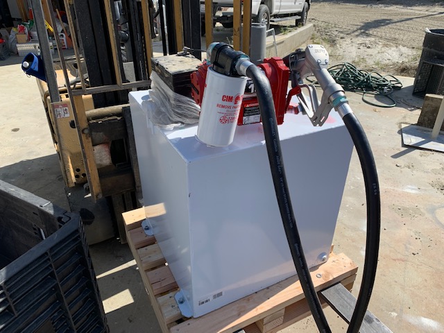

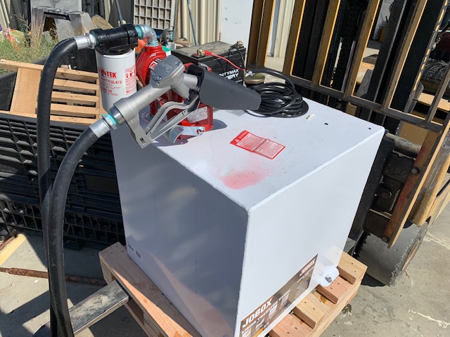

Got it all finished. Built the pallet, waited for some Gasoila Soft-Set Pipe Thread Sealant with PTFE Paste to come in.
Put it all together and just hooked up a small 12 V and she works beautifully.
Filler the tank up with 50 gallons of red diesel $1.84 a gal in Ca. whereas reg #2 is nearing $4.00 a gallon.
I first tried using the NOCO battery pack but the pump brew too may amp because the NOCO kept shutting off.
The small 12V battery worked fine.
At 15 gal a minute, I filled everything up and nearly drained the tank. In the past using 5gal fuel cans would be miserable.
Holding the heavy 5 gal tanks at weird angles because on the excavator the fuel area is hard to get at and I would always lose a gallon or so every time I filled up.
All in all the best money I ever spent.
I still need to maybe get a battery box and do a final attachment for the battery, but I wanted to see proof of concept and all worked
as planned. No real hiccups except for the NOCO battery pack not being able to handle the load.
