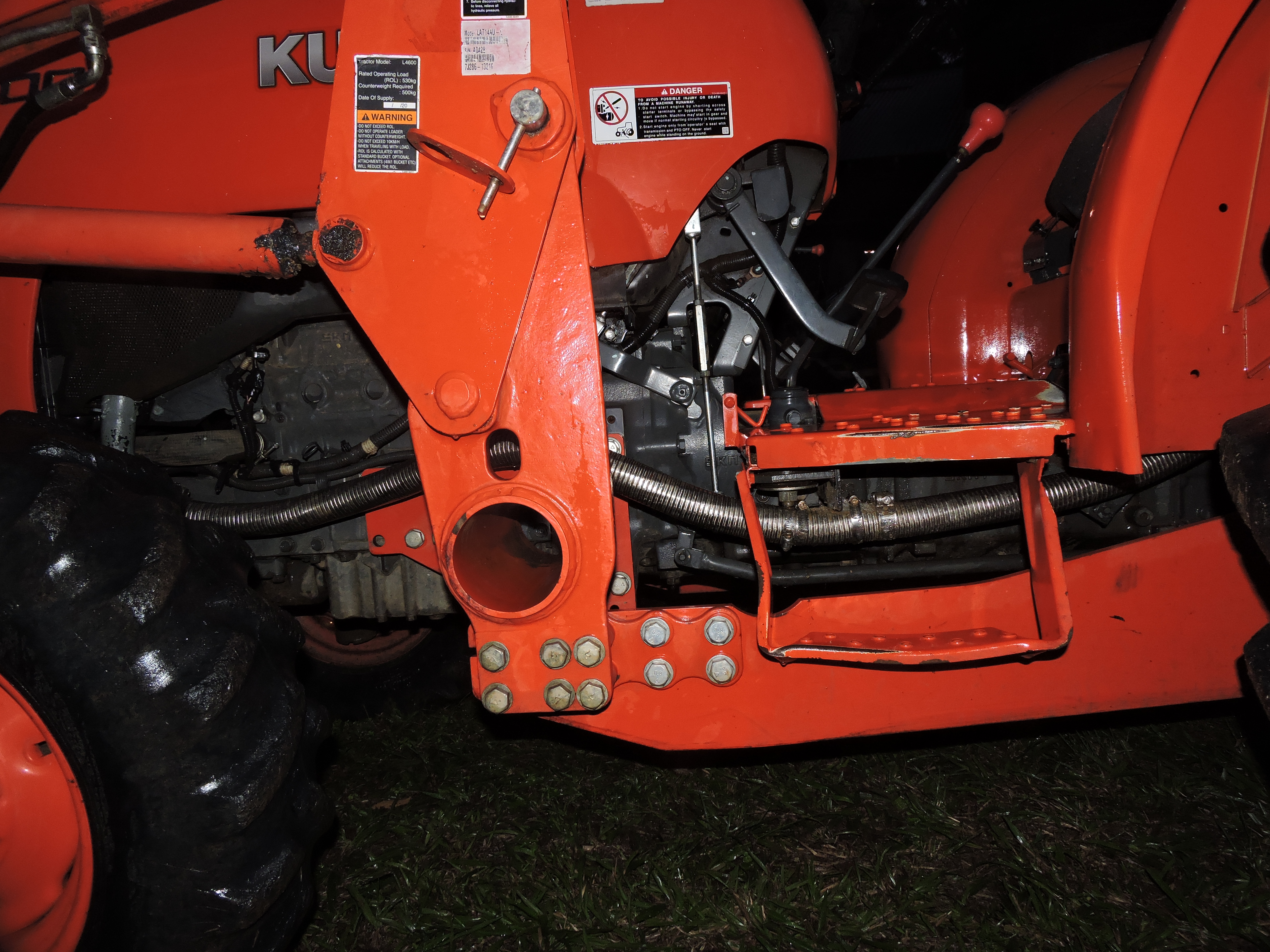

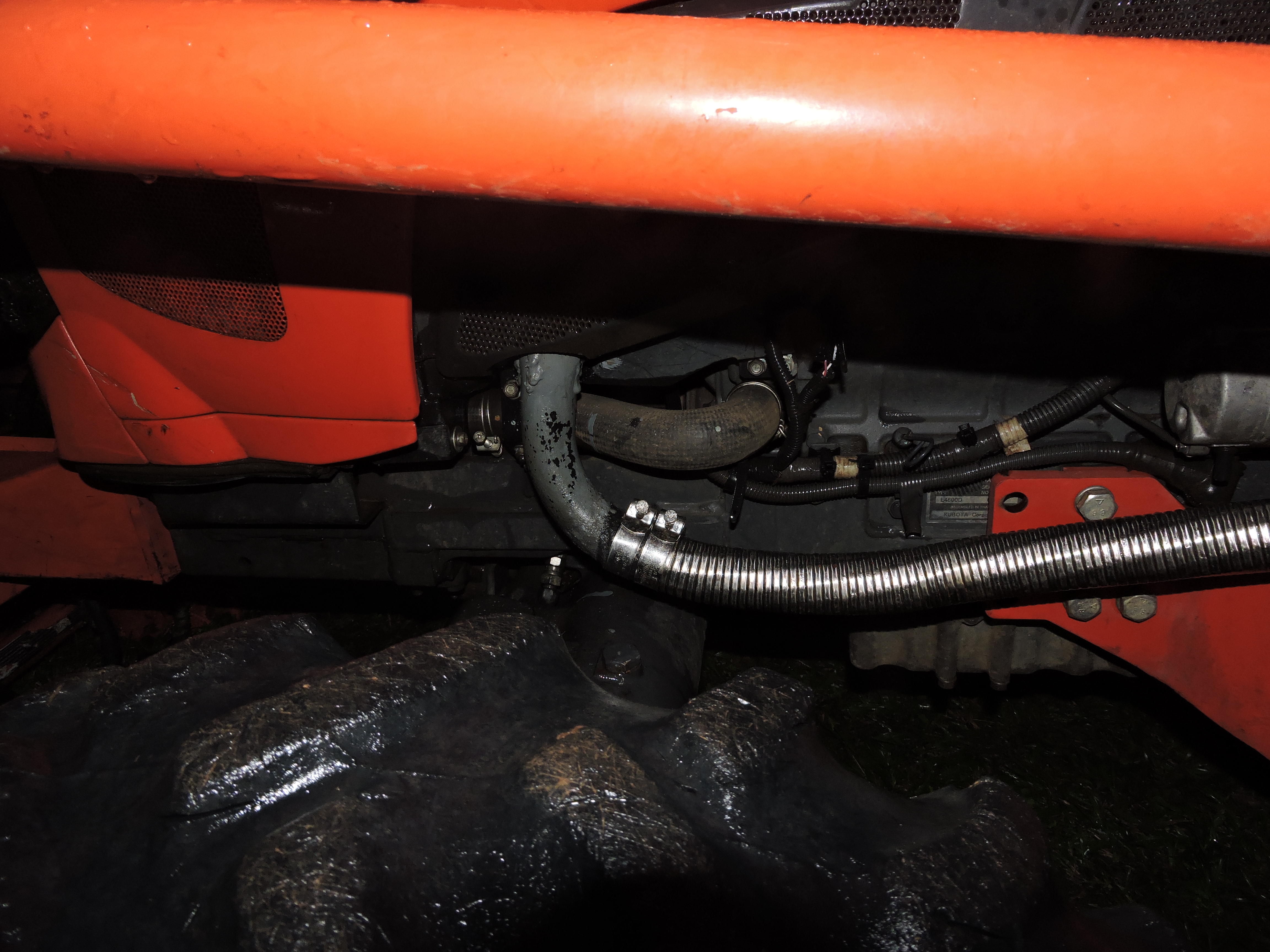

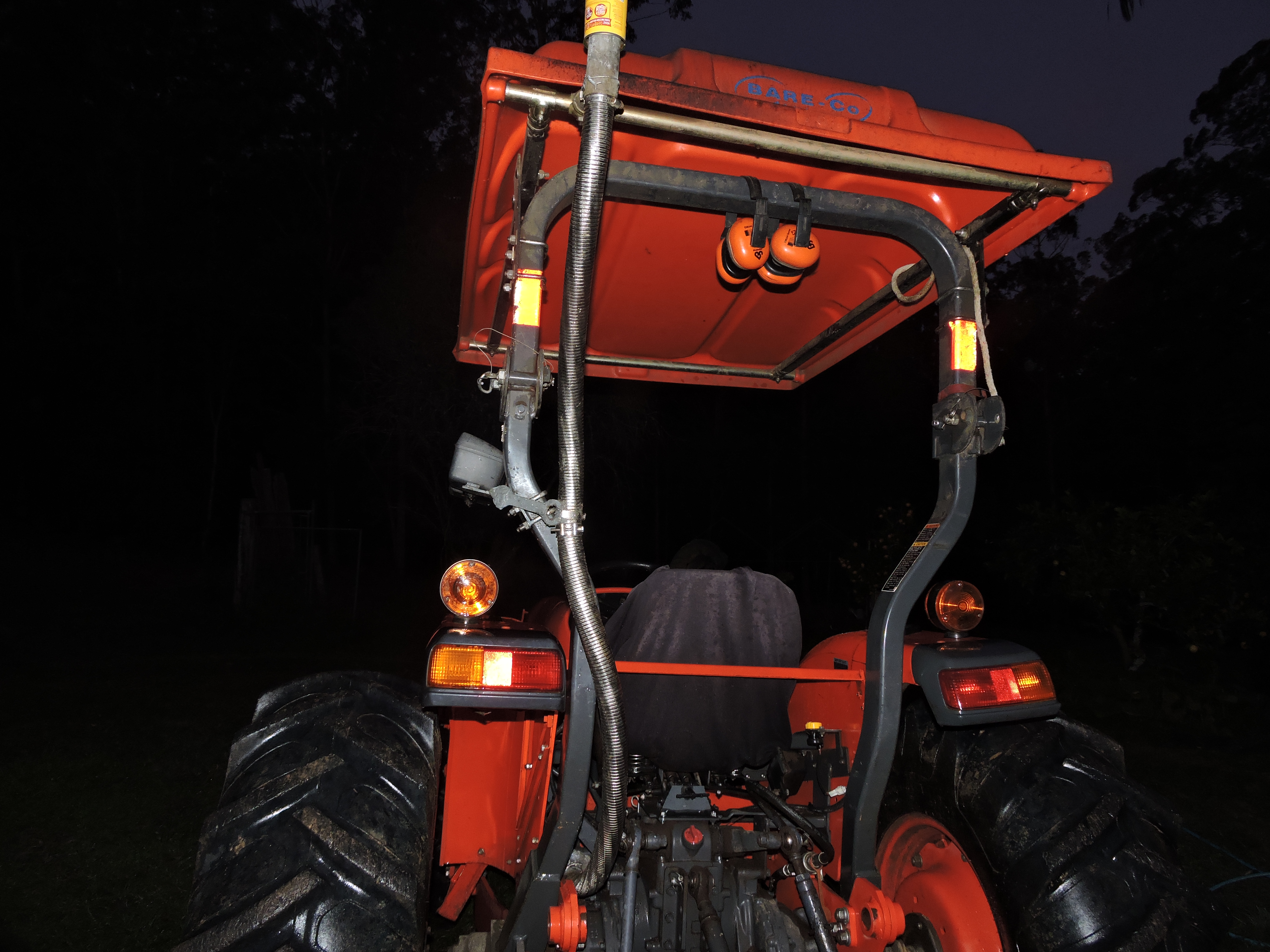

On occasions when I was traveling at just the right speed getting a lung full of diesel fumes straight from the engine has been enough to make me dry reach, that is I almost threw up a couple of times. Other times I wouldn't really notice it at all, just a warm air flow past my head when it was a bit cold, but if I had been slashing all day then at night, I would pick grey gunk out of my nose that I never got when I drove the old grey Fergie with a vertical stack. I decided that I want to see my grand-kids grow up, not too particular about lung cancer, so I fitted an extension pipe to eject the diesel exhaust up above my head and well out of my breathing air. I have only just fitted it and the difference is really noticeable, clean fresh air in my face all day, I only wish that I had done the work when I first noticed the insane new design of ejecting the hot rising exhaust gases at a location where the operator is pretty well guaranteed to breathe in a fair percentage of the engines emissions.
The flexible stainless steel hose that I fitted to my Kubota L4600 tractor cost me a couple of hundred dollars. Well worth the money for clean fresh air and likely a longer life! A couple of photos tell the story about the 14' (about 4 metres) of stainless steel flexible hose. The flexible stainless steel hose I used is about 1mm (0.03937008") internal diameter larger than the exhaust outlet on the tractor. I simply cut the exhaust outlet pipe off about 2" above the bend at the exhaust outlet point and welded it back on again facing the back of the tractor and then clamped on the flexible stainless steel hose.
Can't say that my clothes ever smelt too bad, at least wife hasn't said anything but I agree when I use the chainsaw I end up stinking of 2 stroke exhaust and I go and have a shower also. L4600_ExhaustPipe_Re-route_3.JPG
I have a BH92 Kubota Backhoe attachment that I haven't put back on since I fitted the exhaust extension pipe but I'm fairly certain that it will be well clear of all the connections.
All the best and good luck with whatever option you go with!
