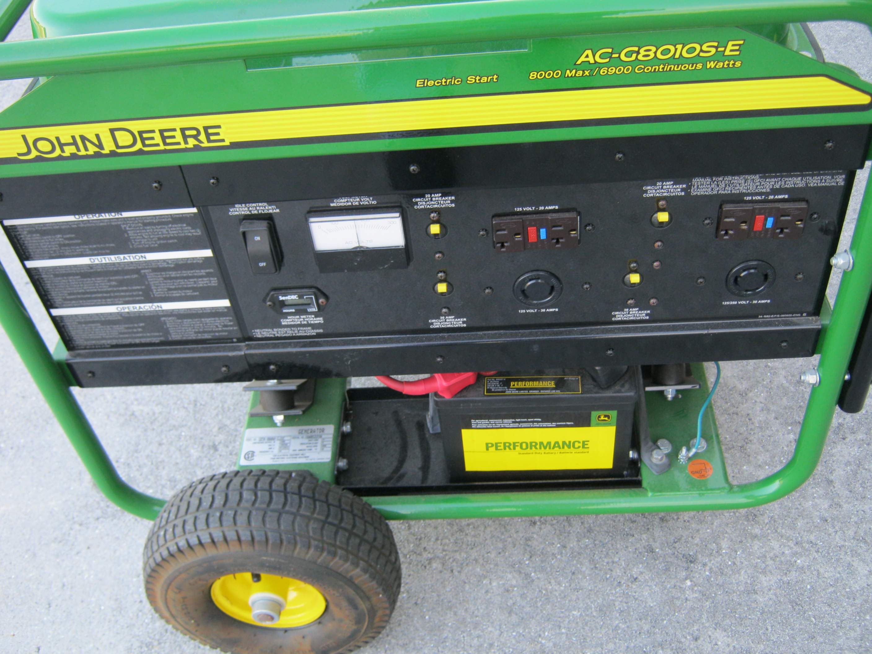

Been enjoying thread , I realize pto mounted genny has its advantages in certain applications , but two things I don't like about it is leaveing tractor running unattended and even though they tend too be short-spinning PTO shaft even w/cover and I'am not around. As for hrs my tractor even though well cared for is a tool. I don't care about hrs on it. Even at resale or trade-in. Just my :2cents:
gas Subaru powered !
