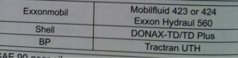

This is what my manual says for the HST.
