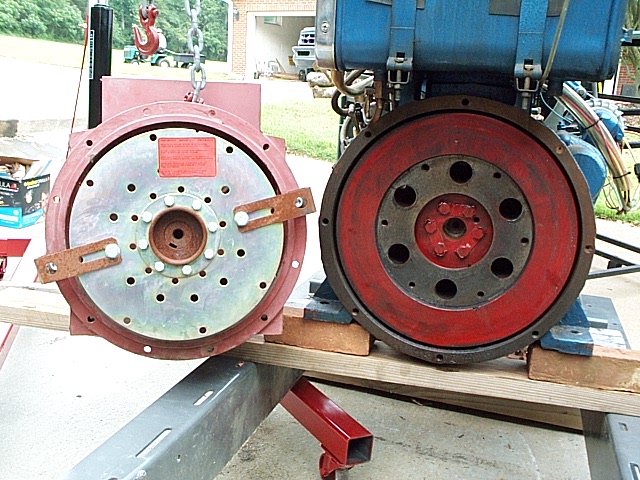

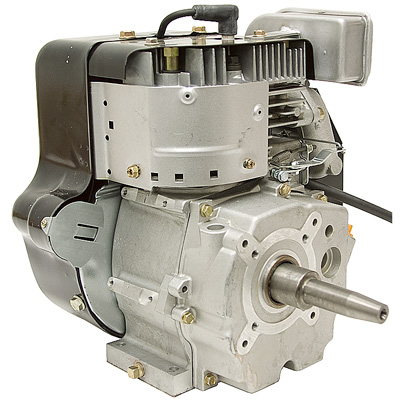

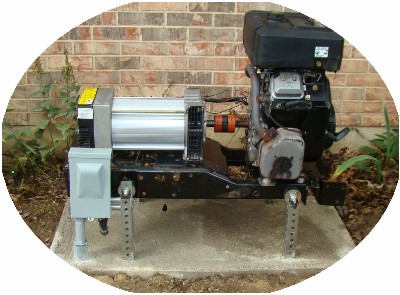

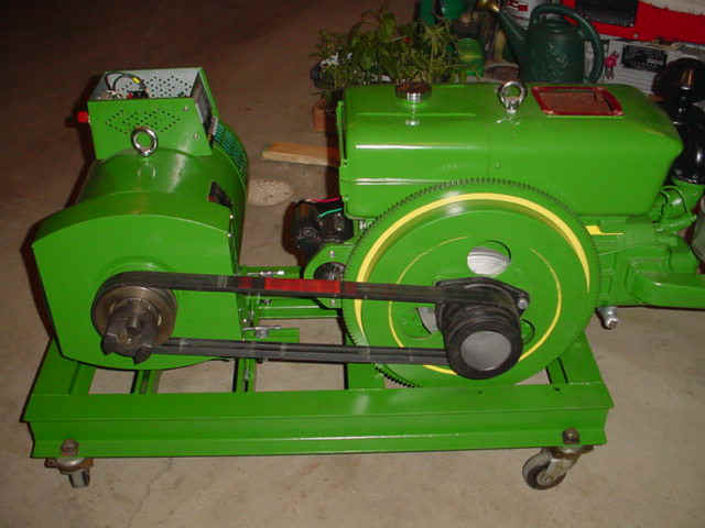

small generators some times used what is called the generator taper, under 20 HP usually.
(the shaft of the generator is hollow, and a bolt or draw bar, is used to tighten the alternator to the engine via the taper).
many larger units use a flex plate attached to the flywheel of the engine, if the engine has a SAE bell housing most likely one can get a one bearing generator to bolt directly to it, some what like a automatic transmission hooks up to a engine,
but if one wants to use a flex coupling one could use a two bearing generator.
not really sure how the pictures will line up but the taper, the flex plate, the flex drive, and the belt drive, these would be your basic choice types, the flex coupling could be a few different types,
