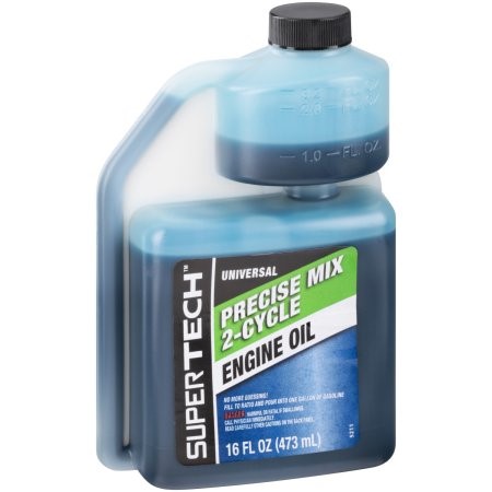

Measuring the Power Service can be a bit of a hassle - I broke the glass measuring cup I found just laying around in the kitchen but you need not mention that to my DW. I use 5 gallon cans and a rattle siphon to fill my tank until I get my diesel stoves hooked up in my shops and start buying 300 gallons at a pop. Anyway, recommended is 1.6 ounces per 5 gallons hard to get precise huh - but what, heck just pour some in, right? Well what I do is save those nifty 2 cycle oil jugs with the measuring container on the top - squeeze the bottle and the oil fills the graduated container so you can pour it into your gas for the proper mix. I refill the empty with Power Service and get a reasonably perfect measurement each time.
Sorry, there are two types of oil bottles, you want the first one as you can easily refill it. The second photo requires the removal of a little valve in the bottle's neck and then replacing it again - all with a long nose pliers.
