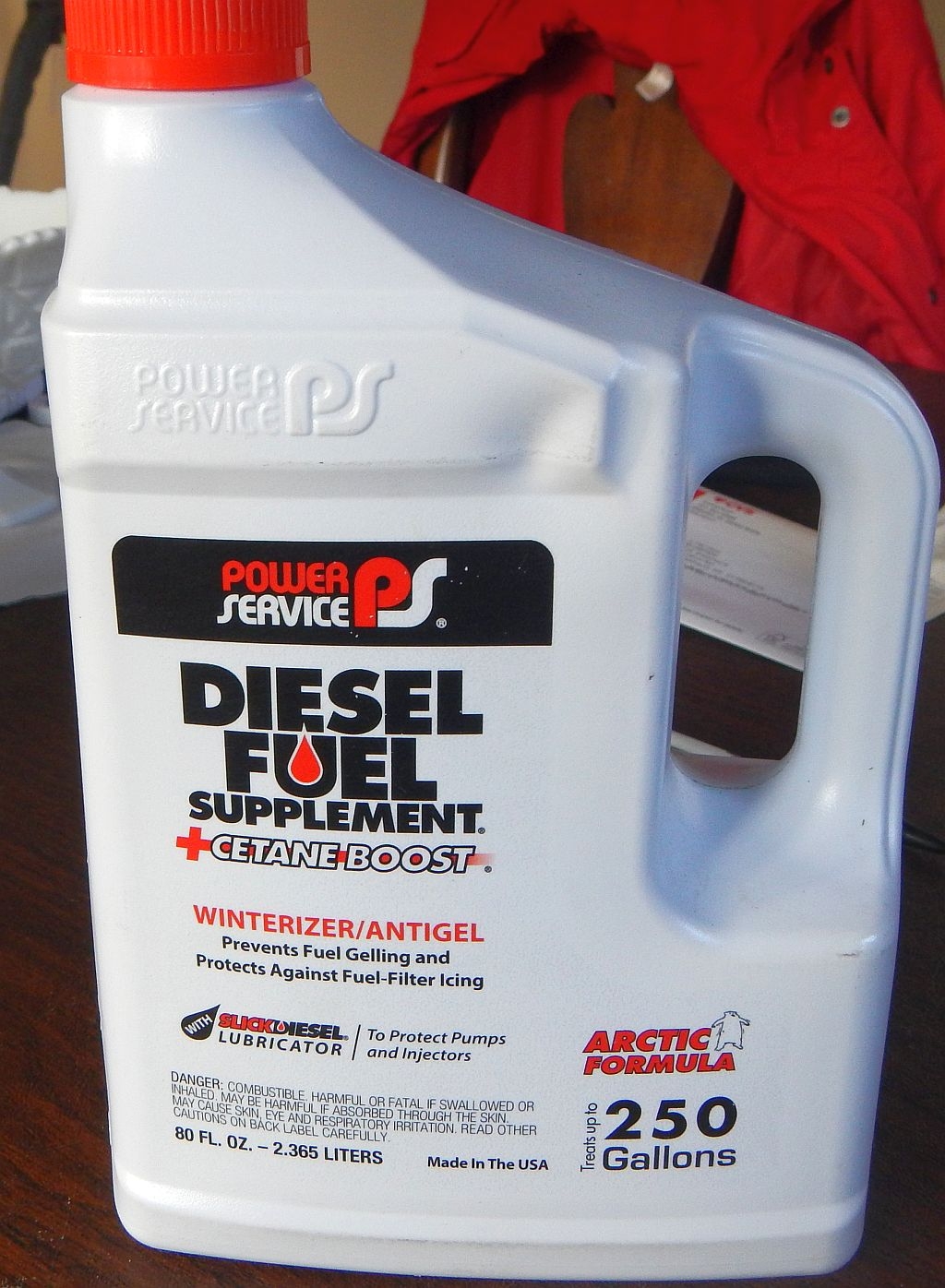

This is what you want to add to your fuel...best price is at Walmart

I have found that an additive and running #2 will still gel when it gets near zero. If you have a tractor made before they took the sulfur out of diesel you might worry about the lubrication factor. Anything made recently I think people worry too much about the lubricity of diesel. That said I probably wouldn’t run straight number 1. That for north they are almost certainly blending in number 1 so I’d just make sure you are getting recent fuel and you should be good.
