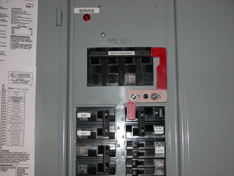

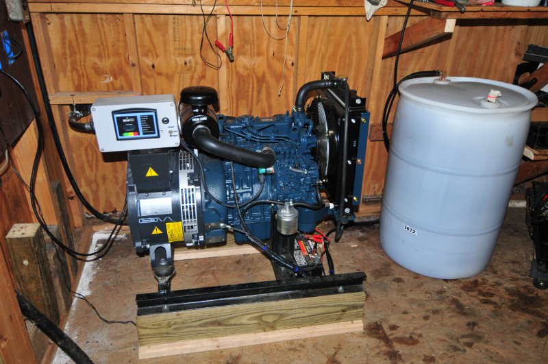

I too have the 9,875 Kubota powered genset referenced in post 32. I replaced an aircooled Deutz powered gen. Diesel and plastic barrel is the way to go. I did have a steel 50 gal before, but the steel rusted at the fuel level, and plastic for sure will not rust.
They make 15kw and 20kw units as well. Bigger the set, the more fuel you will use. With this unit I can power the house. Just can't run the stove and heat pumps at the same time, but this is not a problem. Also using a manual transfer/interlock on the main panel. Similar to: Generator InterLock Kit but homemade.
paul
Great job with the home made interlock. the interlock option is the way to go, for manual switching anyway, brilliant, simple and safe.
I can't do it on my panel unfortunately, since my panel is considered remote (more than x number of feet from the service entrance) so I only have a main outside at the meter, not in the inside panel :(
