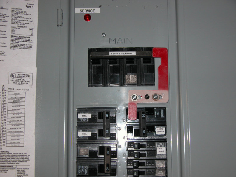

I don't agree with the separate panel, I would rather have the ability to run any circuit in the house, not every circuit under full load at once, but any circuit I needed. Not sure what would be needed to have an auto switch for a set up like that, they have the manual switches that switch between utility and generator. It's a big switch and not cheap, but we are not talking about doing it cheaply.
It can be done very simply with a manual interlock, but that is manual.

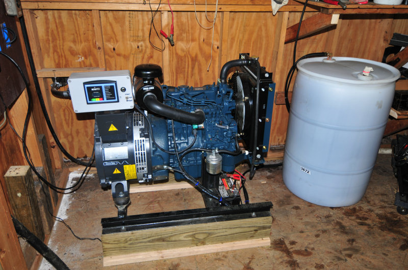

I too have the 9,875 Kubota powered genset referenced in post 32. I replaced an aircooled Deutz powered gen. Diesel and plastic barrel is the way to go. I did have a steel 50 gal before, but the steel rusted at the fuel level, and plastic for sure will not rust.
They make 15kw and 20kw units as well. Bigger the set, the more fuel you will use. With this unit I can power the house. Just can't run the stove and heat pumps at the same time, but this is not a problem. Also using a manual transfer/interlock on the main panel. Similar to: Generator InterLock Kit but homemade.
paul

Check out this unit:
Kubota 9,875 Watt Diesel Generator
It's a 3 cylinder, 9kw, remote start, about .4 gal/hour, and quiet.
Those 4 pole (1800 rpm) are my dream machines, yeah they are the most expensive initially, but in the long run are the most cost efficient.
I'm not saying the brand specific, but that design.
In a survival situation, that's the one I want.
paul
Great job with the home made interlock. the interlock option is the way to go, for manual switching anyway, brilliant, simple and safe.
I can't do it on my panel unfortunately, since my panel is considered remote (more than x number of feet from the service entrance) so I only have a main outside at the meter, not in the inside panel :(

That looks like a great unit you have, and you give it a good review, but that being a 2 pole (3600 rpm) I don't think it will have the life expectancy of the 3 cylinder units. More portable though.
Not sure what's up with the kubotas you have seen broke down? but in general that design SHOULD be the most reliable and durable.
