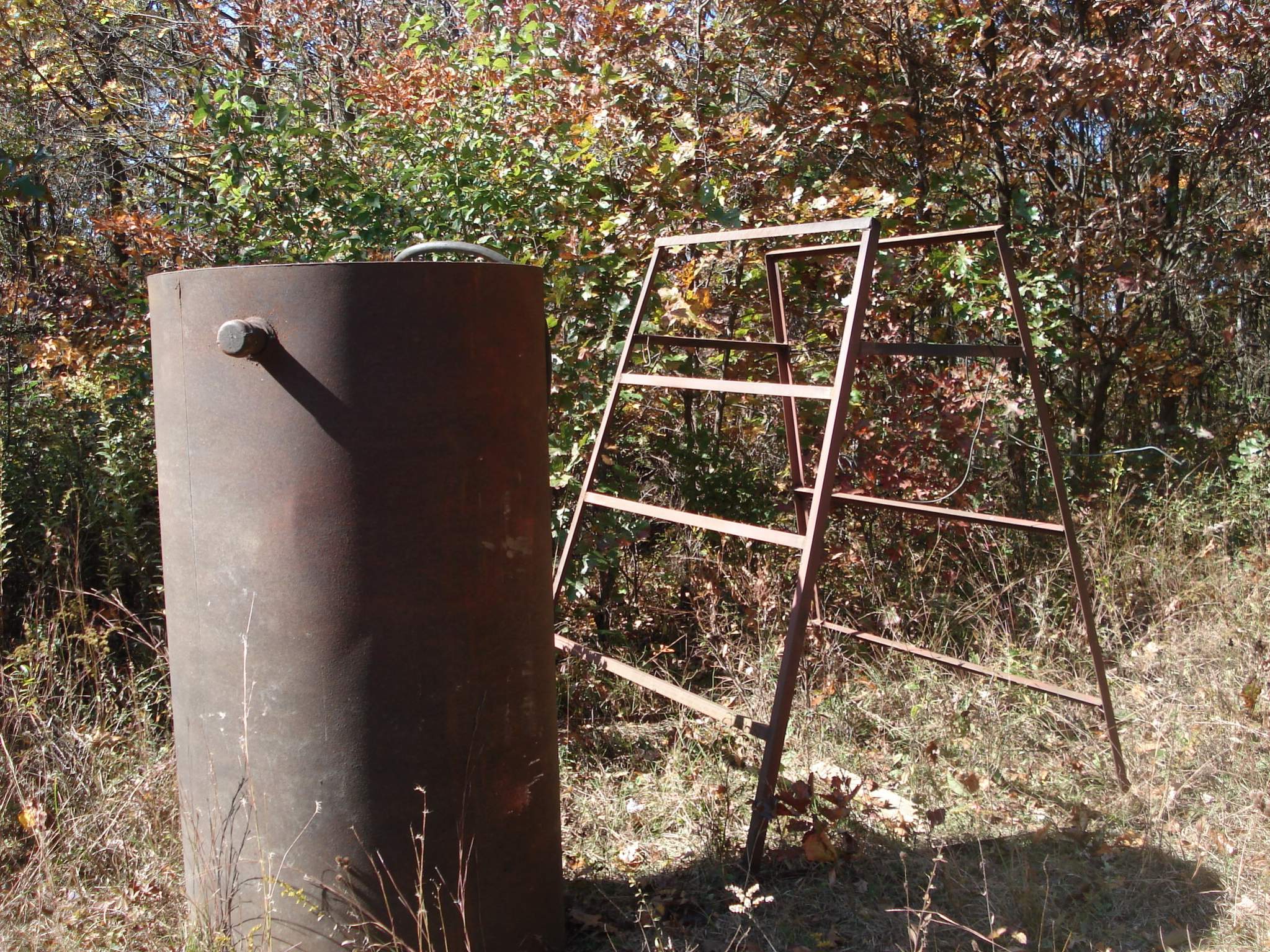

This is my setup I bought for $140. I recently bought new hose, pump, and filter, just need time to get it setup when i get home. I'm thinking I will like gravity feed - pretty foolproof.
Of course, as I was bragging what a deal I got on it to my concrete sub, he told me one of the local oil distributors will supply a free tank for off-road....:mad: I'm assuming that's if you order a LOT of diesel....
