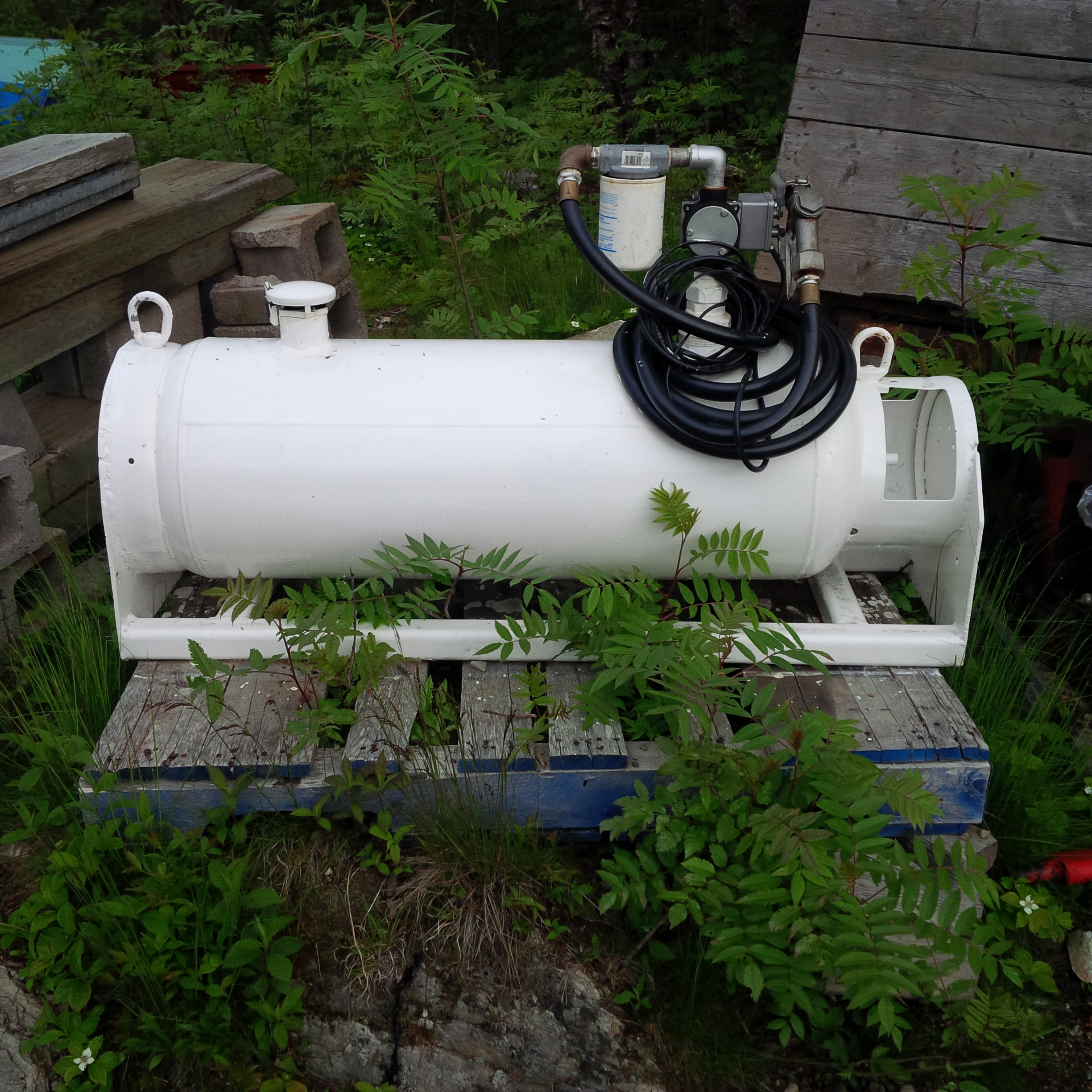

This is my reserve tank, it holds 25 gallons which seems to be the volume that best fits my needs, has a 12 volt pump and is stored outside.
