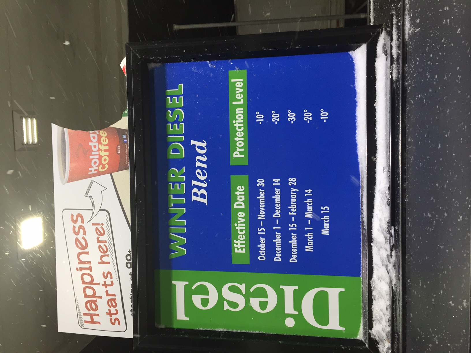

In northern WI and the UP of MI this is what the gas stations sell by date.. having had my 1620 gel up twice on me in bitter cold I always let it warm up and if it starts hesitating or loosing power head for the shed.. it is no fun taking all the lines and filters off cleaning and re-priming in below zero weather with it snowing outside. in fall I run down as much as I can and wait till December to top of tanks.. I also always add Diesel Service fuel supplement when adding fuel and have a bottle of 911 on the shelf as well.
Wow good for that station to disclose a standard!
