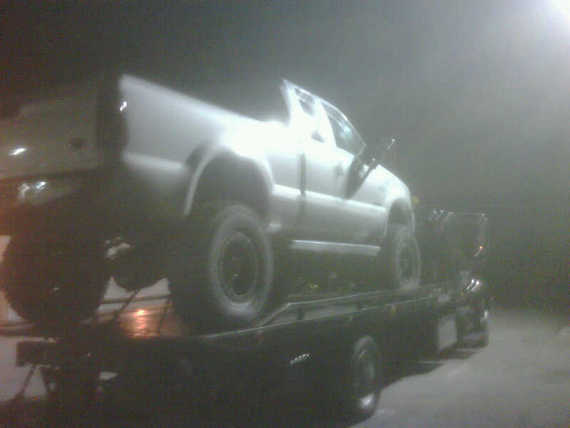

The above is a Ford F250 that got 200 miles on zero gallons of fuel...:rolleyes:
   / Diesel truck with best MPG #93
PaulChristenson said:
<img src="http://www.tractorbynet.com/forums/attachment.php?attachmentid=280603"/>
Hey! My neighbor brings his ford home like that all the time!
