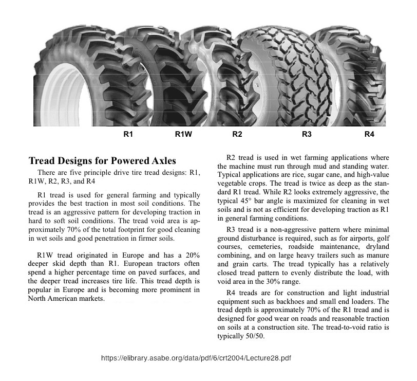

   / Diff between R1 and R4 tires? #129
On our north Florida farms we use rice and cane tires. Deep, wide spaced lugs throw out mud.
   / Diff between R1 and R4 tires? #130
When did the R numbers become common? We always referred to them by name only: ag, rice, turf, construction.
Bruce
