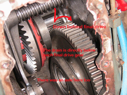

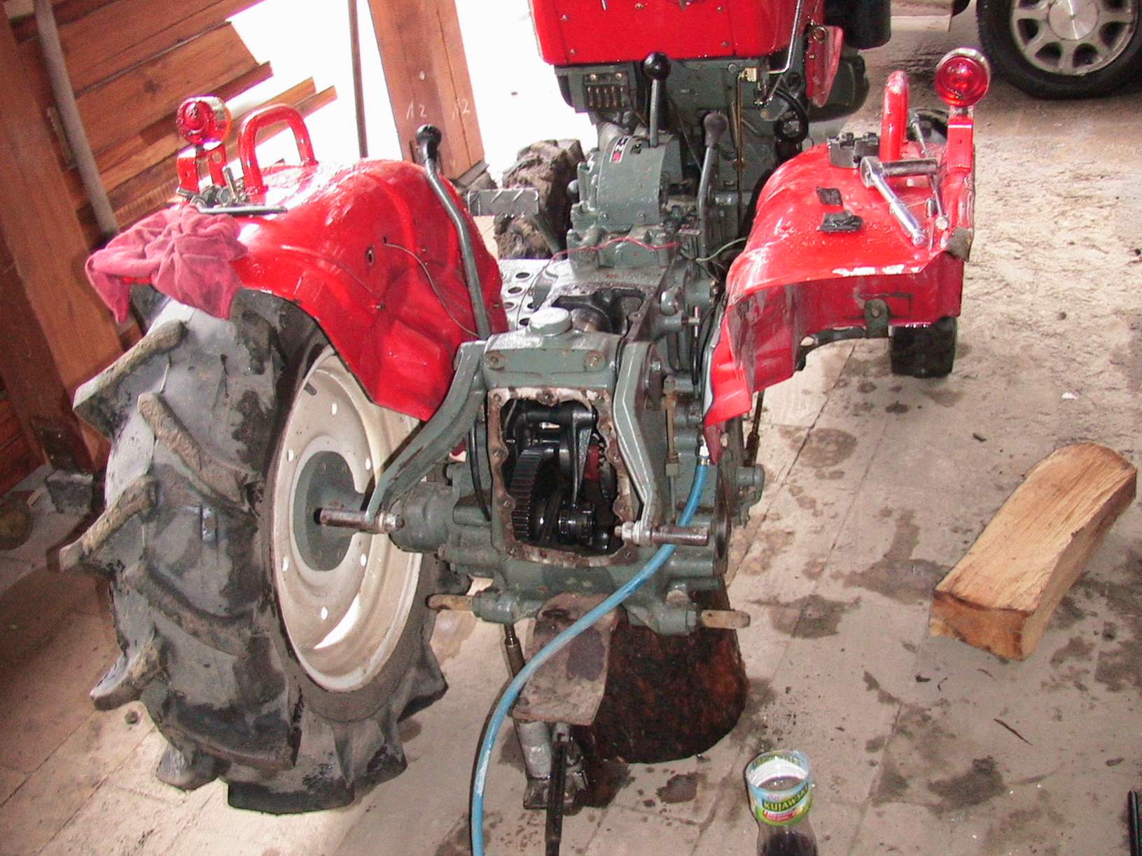

Exactly. But I normally do not engage mine until I need to extract myself from a situation (I use them like my buffer--not to do more, but to get me out when I tried to do too much).:eek: I Usually hold light pressure and start to try to move, when one wheel turns a little it pops right in. I had mine apart this past summer because the shaft was rusted in the hole and it would stay in whatever position I left it until I physically moved it to another position; down, half down, up. It was that way from when I bought it, but now it works as it was supposed to (spring loaded to return to disengaged.)
I took these pics when I was searching for the little ball that fell out when the 3 pt lift control broke. It took some digging. The second square cut engage pawn is sitting on the fender and the right hand axle is out. I was in a hurry to finish a job or I would have fixed my diff lock at this time.
I have had that back PTO section out so many times now that i think that it ought to be installed with a zipper to make it easier. :D
Mike
