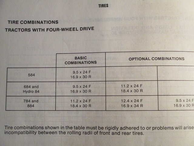

When would you say this occurred? My local dealers of all brands always called a 2wd tractor a 2wd and the same tractor with "front wheel assist" a four wheel drive. I think the line got blurred many, many years ago, and it wasn't the dealers catering to the city folk. See a page from my 1984 International Operators manual for 84 series utilities, a farm tractor that isn't a "four wheel drive".

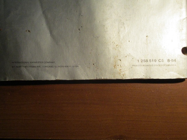

Haha, must be regional, we don't call it hydro in these parts eh? :) More like "power goes out and I start up the generator" IMG_2258.JPG
Check out the back page of the 84 series operator manual. IH US book and printed in USA so technically my Canadian dealer would be right calling it a four wheel drive when selling these in the 80s. Weird since we bought an England built IH in Canada that came with a USA operators manual.
