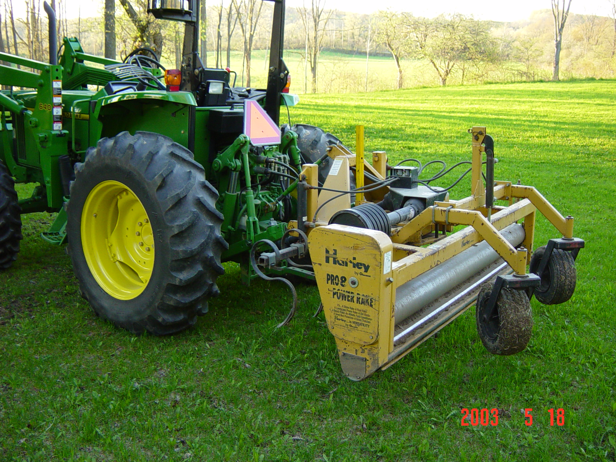

I am fortunate enough to have an old style Harley, Pro 8 rake. It has two rollers and S tines which make it a different animal (and far superior) from the current Harley rakes.

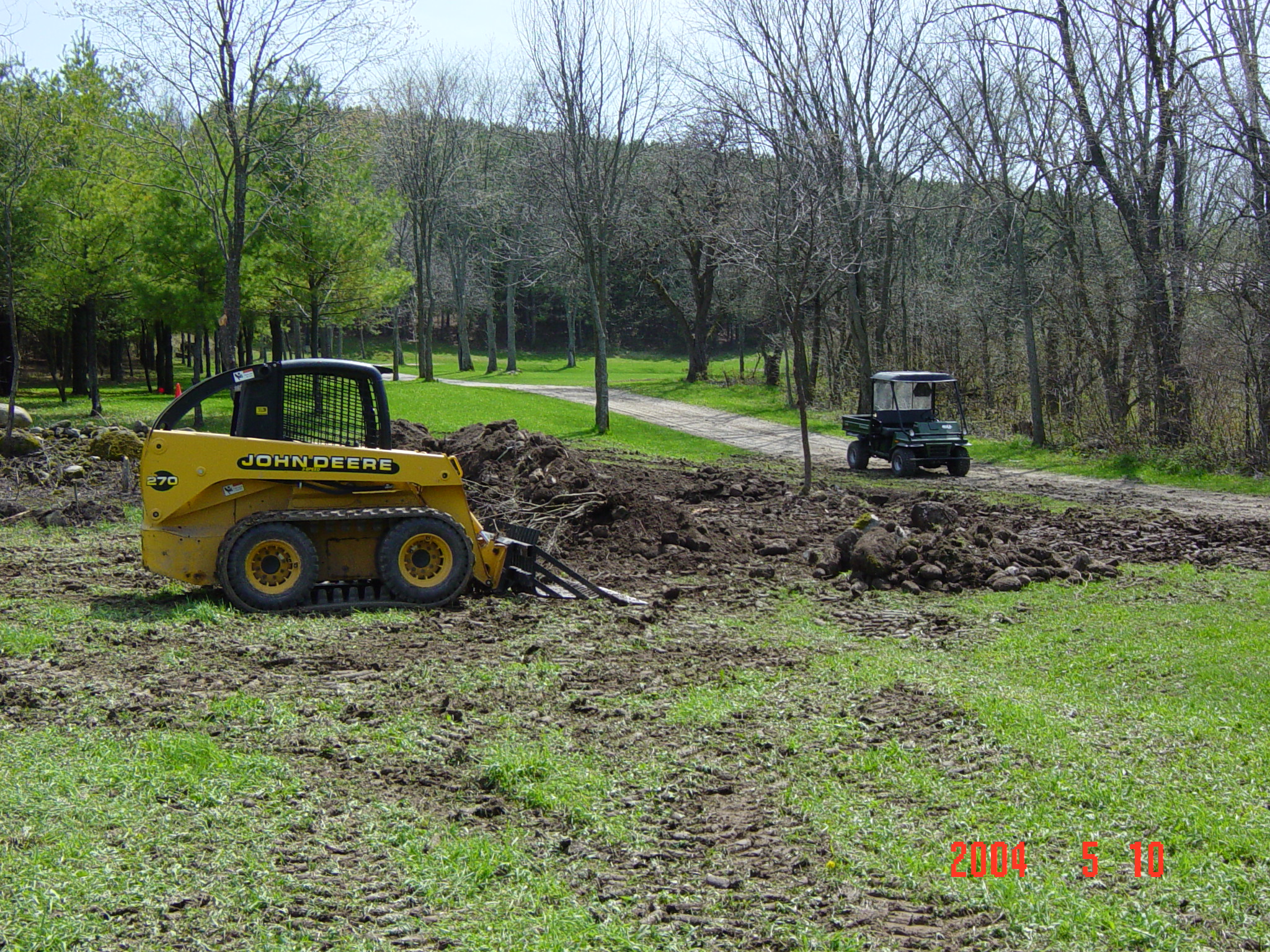

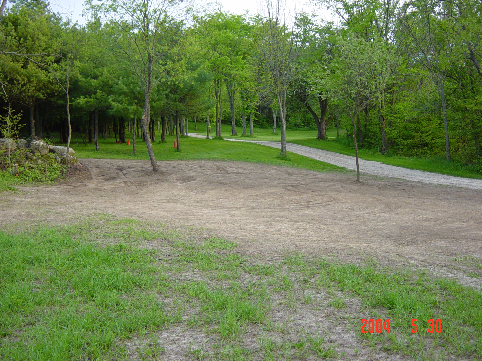

Before and after pics using Harley rake. You can't stick a spade in the ground here anywhere on account of rocks. Area was rolled.

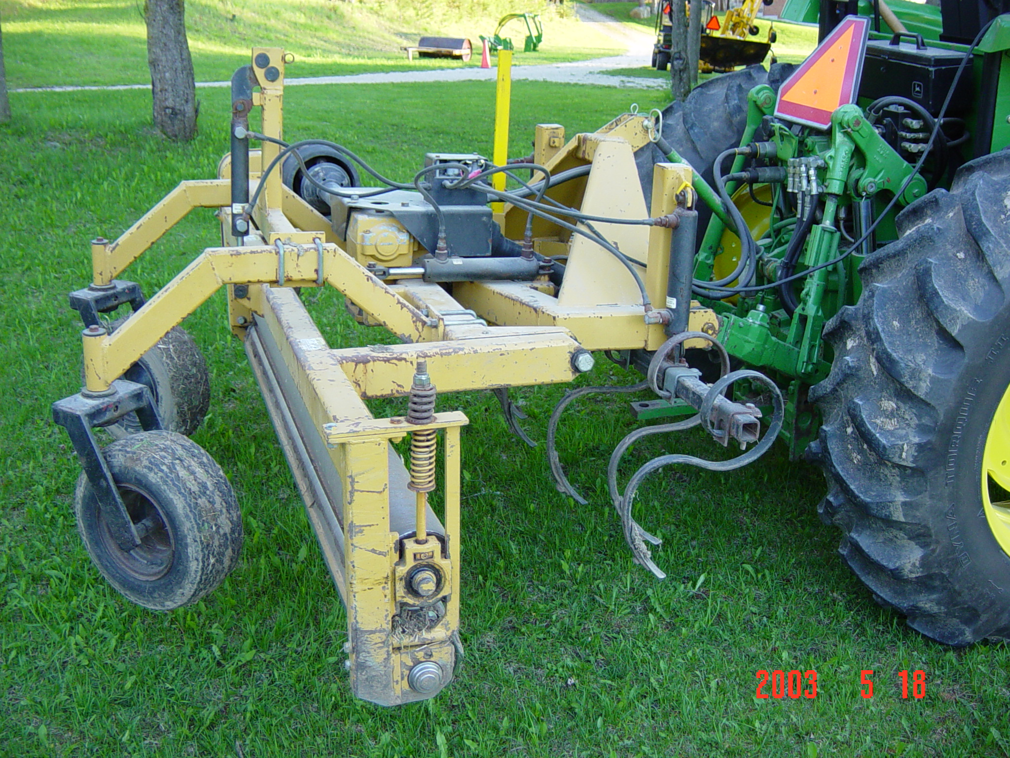

So Industrial Toys, what in your opinion makes this earlier style better? Here's what I see. Old style has bars on the bottom drum vs new style with teeth. Bars wouldn't be quite as aggressive as teeth but teeth don't need the s-tines to loosen up the soil.
What's the purpose of the second drum?

The S tines do a remarkable job of scratching at hard packed material. They also claw up stones.
You can adjust the spacing between the two rollers to determine how course a material comes out the back and the rest gets pushed forward or windrowed if angled.
In a way, I guess anything you spin will do basically the same thing with minor variations. Just like, a hundred different things can be used as a drag.
I'm guessing, my old rake was the culmination of years of R&D. In the end, it was just too expensive to manufacture and was scaled back in design.
