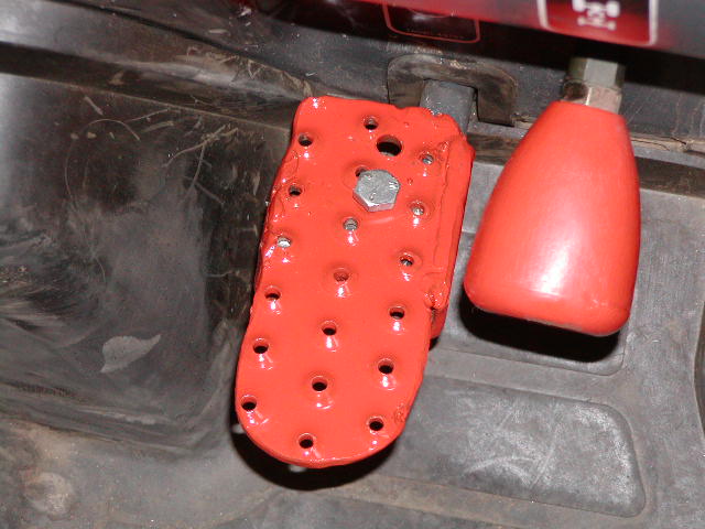

I expect the differential lock on most mid-sized Kubotas is placed the same - on my L3410 it's darn inconvenient. I like the extra leverage afforded by the custom made gismo.
