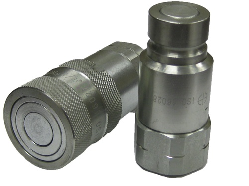

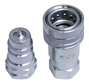

On the question of the connections being "flat face or Ag style" well I don't know the difference. They look like a simple air hose connection where one fits into the other.
For future reference, the first photo is of flat face connectors and the second is for Ag style. The reason I asked is that using a piece of board one can tap the end of a male AG style connector and release a small bit of built up pressure in the system that may have developed from temperature or other conditions, one cannot do the same thing with the flat face style and they seem more prone to this condition.
