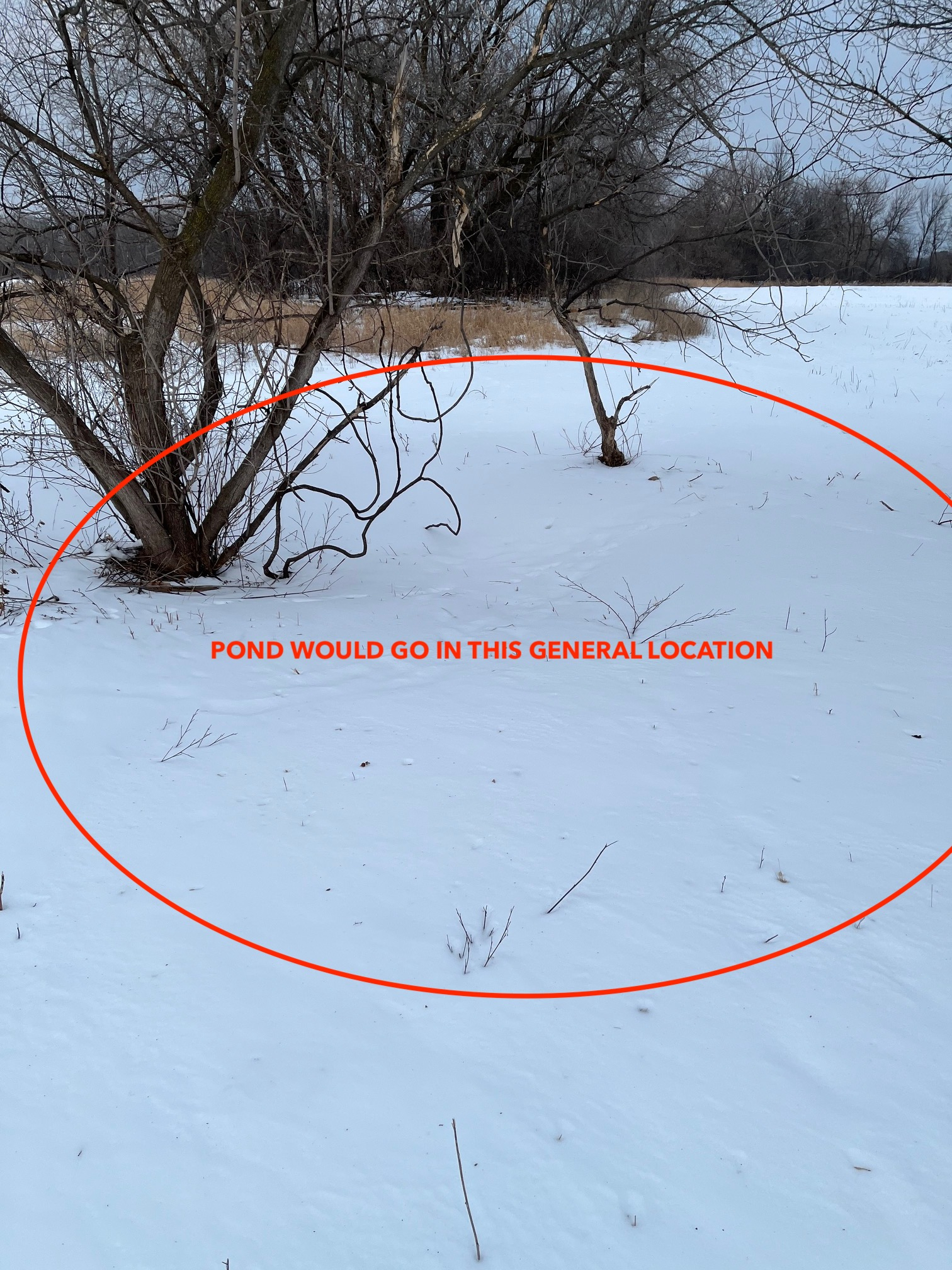

Here in MN I'm looking to dig a small pond (like 30' x 40'), up to 10' deep. I've watch a bunch of videos and read on how to do this. Anyone had experience with this and luck with fish (bass and sunfish)? Here is pic of current land (tough to see with snow, but is already a little low ground).

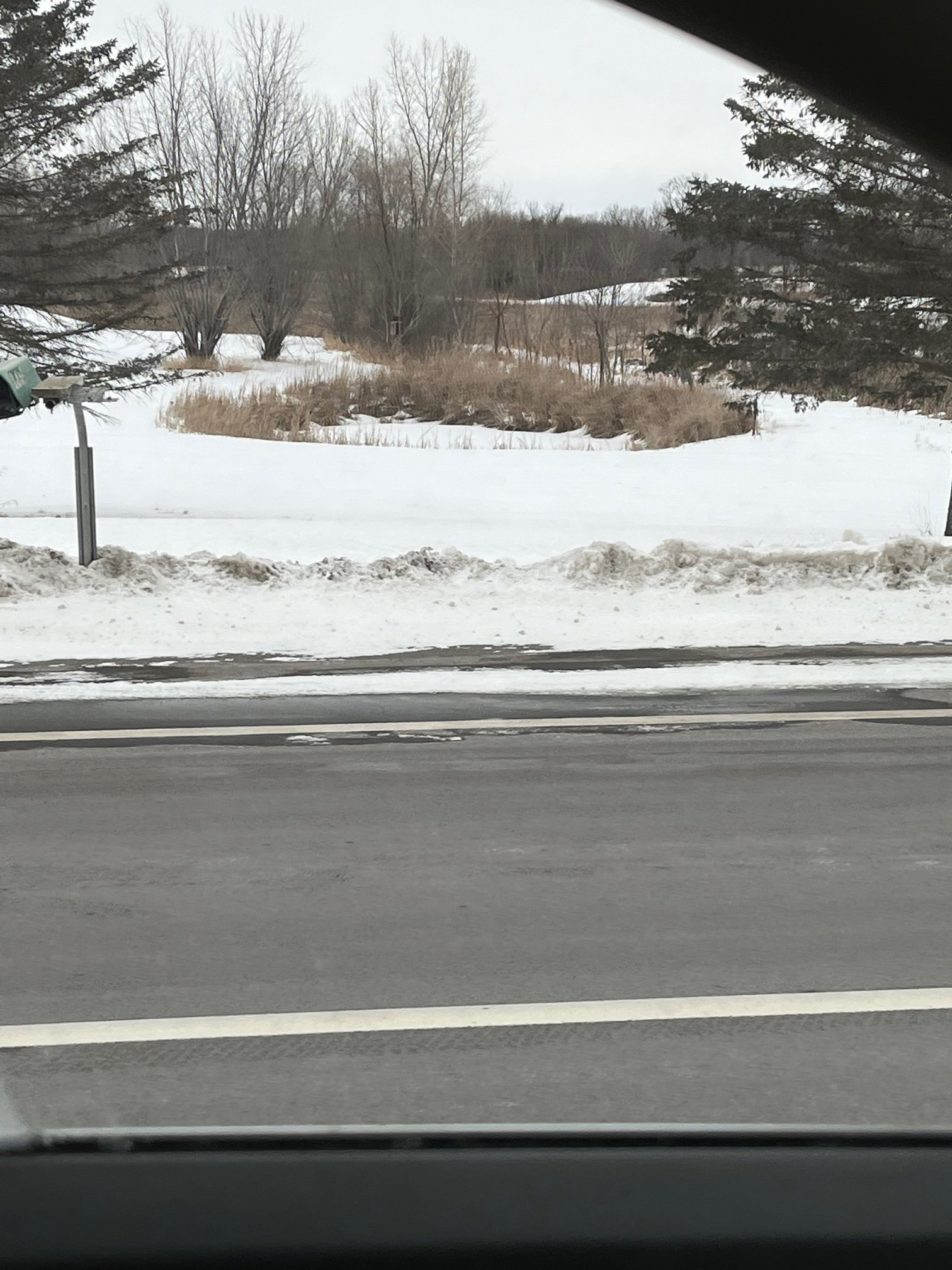

Here is a local farmers pond i drove by that looked like something similar in the end I would expect:

Your big problem with a pond like you propose. Winter ice cover does not allow surface water aeration which will in turn aerate the entire water column. Organics in the pond will decompose and reduce oxygen to zero. At that point the fish will die.
You must have surface aeration. Keep the pond open - do not stir up the organics on the bottom. Some type of floating surface aerator.
Being that you are in Minnesota - the winter temps can be quite a challenge.
If you can develop a system that keeps the pond open during the winter - I would recommend bass.

The information I received from the local Soil nd Water Conservation district was that 50% of the area should be at least 6' deep. With typical sloping, that requires about 100 foot in diameter.

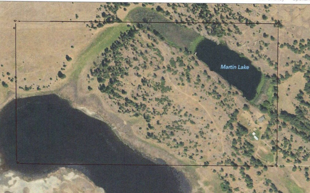

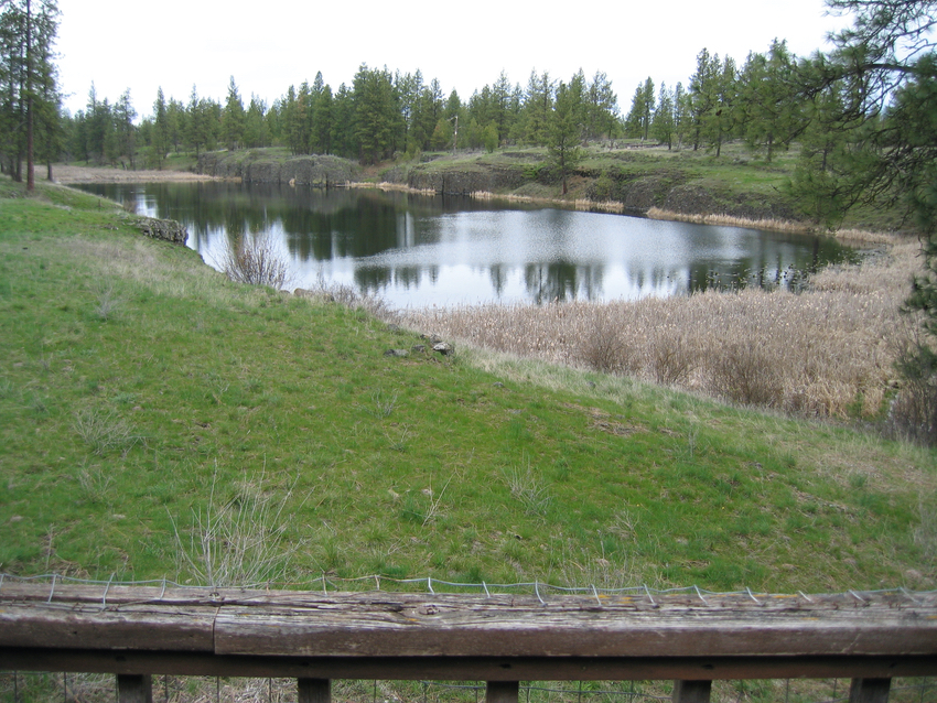

This is my lake. It's 5.2 acres of open water and down at the far end - another 5 acres of shallow water and cattails. It's a small version of the typical lake around here in the Scabrock lands. The lake is 80 feet deep. Right at the interface of the water and the basaltic lava cliffs it's 40 feet deep.
About every 15 - 20 years or so - even my little lake will winter kill. Long extended ice cover and low output from the many springs on this end of the lake. Gives me a chance to try something new in the lake. However, with the way things are going - these warm winters - winter kill could be a thing of the past.
Right now it has both large/small mouth bass. I enjoy sitting on the cliffs and watching the schools of bass parade past.
