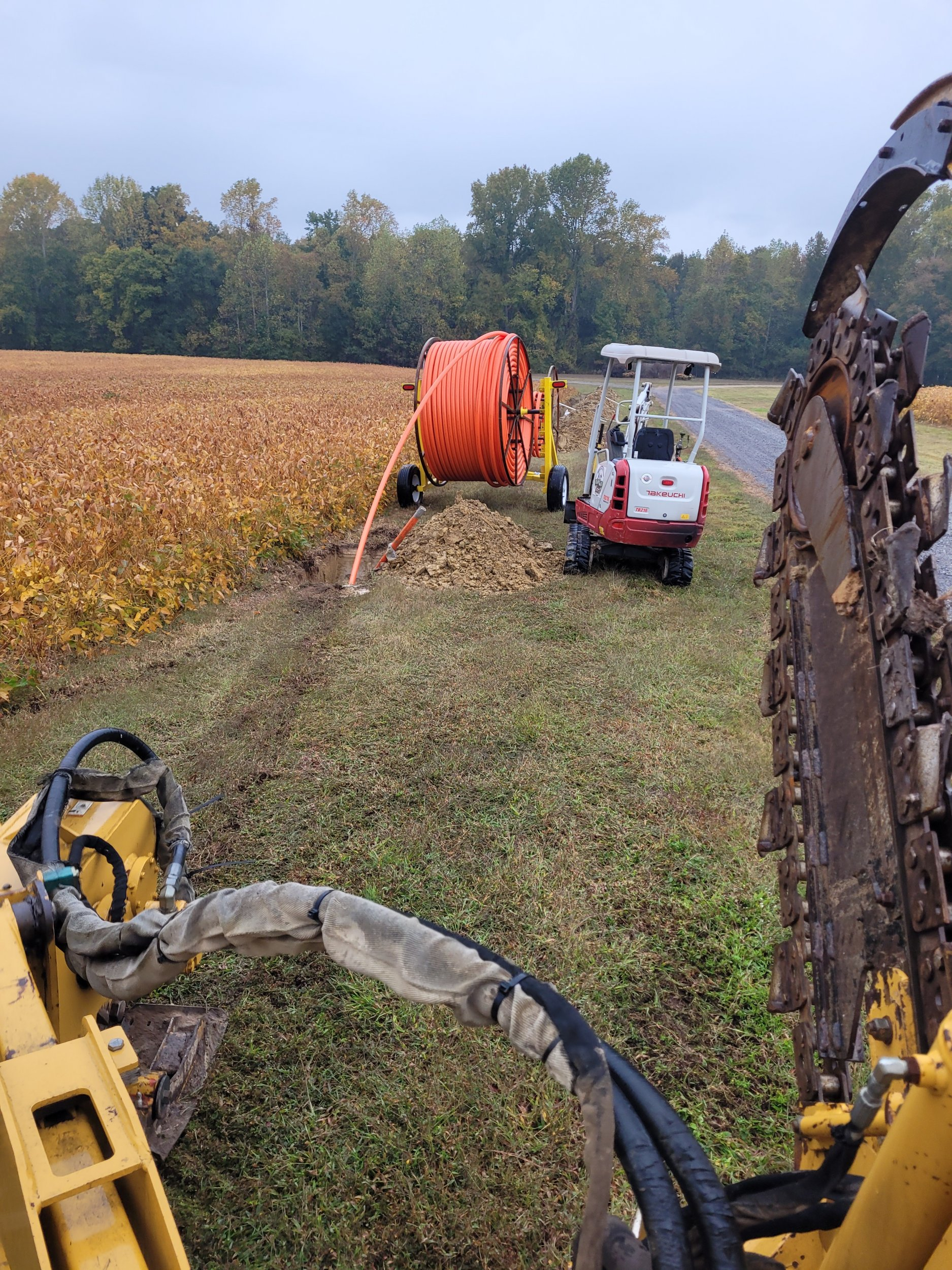

You need one of these! Pulling it in straight off the 2500ft reel.

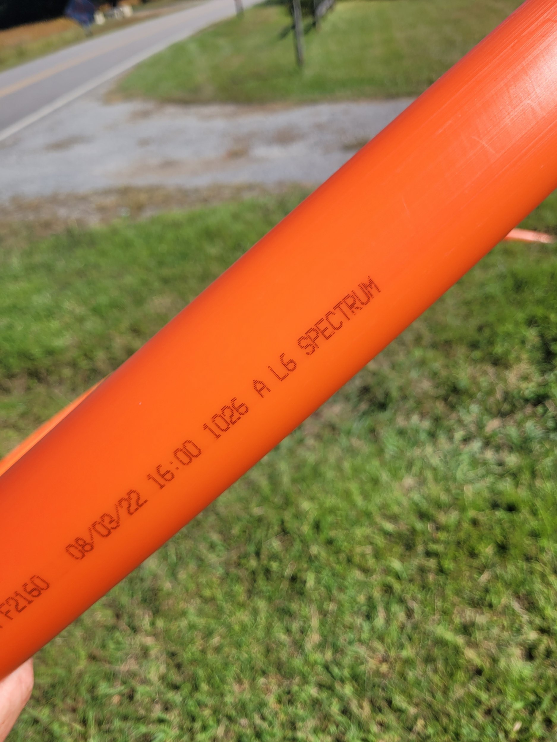

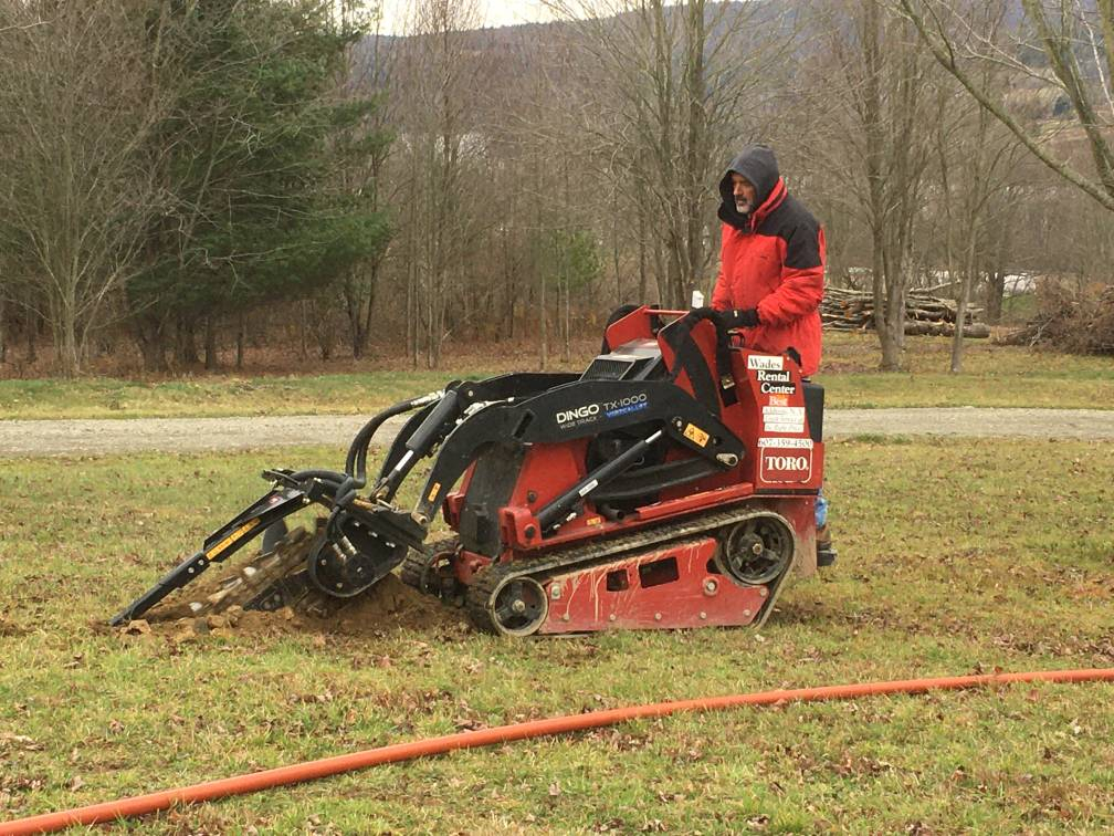

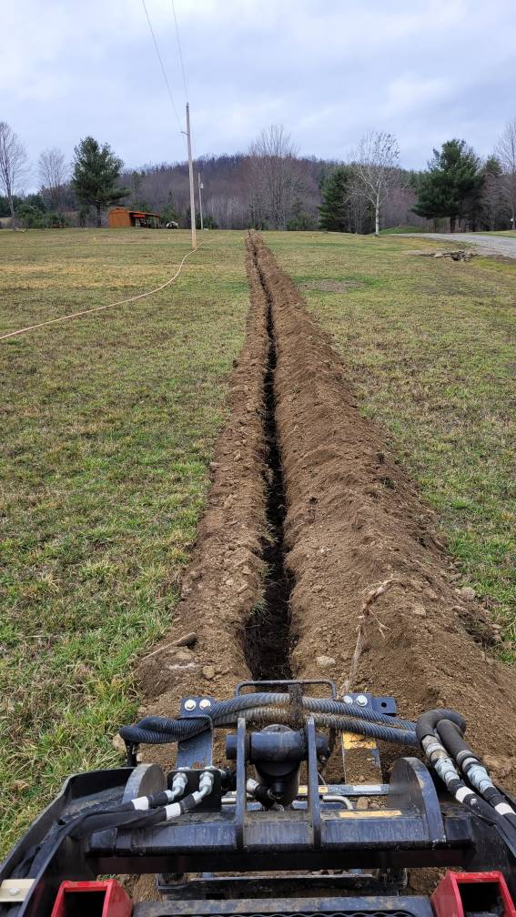

Spectrum here. Similar situation, 800 ft direct burial.
Called 811 for flagging anything underground along the path.
I rented a Dingo stand-up trencher for ~$200 a day. Dug it in 3 hours.
I have scattered fist to head sized rock, but was able to get it to dig 18" down.
Spectrum had already pre-delivered the coax, rolled out along the path, already inside a 2" conduit. I flopped it in the trench and covered it up. Key was the pre-delivery of the cable, which made it simple and timely.
Spectrum came back and connected the ends about 2 days later.
