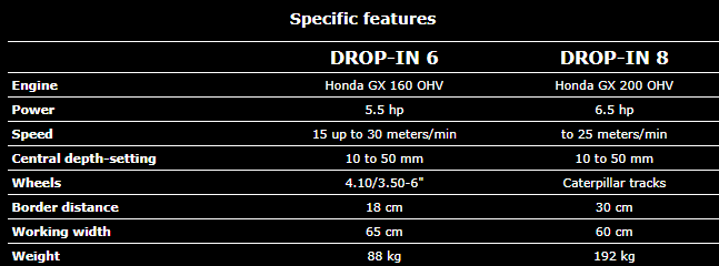

I have a lot of CAT 6 cables just laid in by a mole. Best trick was using the unit that they use for laying the robot lawn mower guide lines.
DROP-IN 6 Honda GX160​
Even better would be to lay some standard poly water pipe as your conduit with a mole something like this. WRP1 - Winton Ripper & Pipe Layer 4.5cm Pipe - For Compact Tractors
Plenty of tricks for adding a pull through cord. This is not like you are burying power.

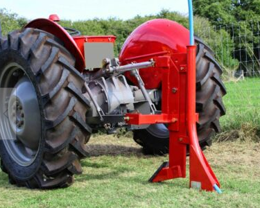

But I made a variation of this 3PT Ripper with Pipelayer, 3-Point Hitch Tractor Pipper for pipe laying for laying pipe. Works good but you need a heavy tractor to pull the thing at 2' and more depth, shallow is a walk in the part. Then over it with a roller and you can barely tell you were there. Granted, to make life easier I dug holes at my start/stop points. I haven't run it through heavily compacted soil yet so no idea on how it'll pull through that. Don't think this is legal if a pipe inspection is required.
