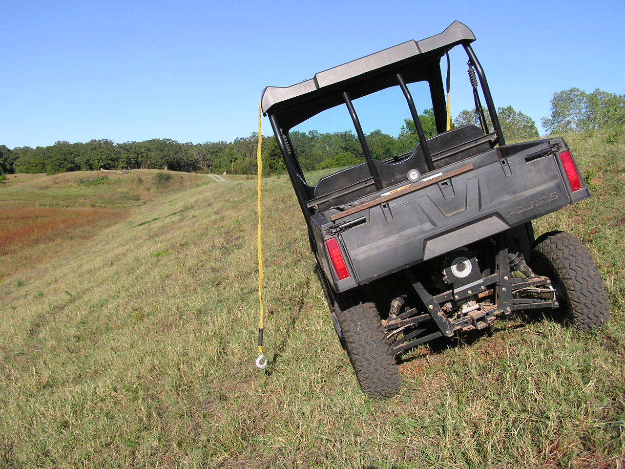

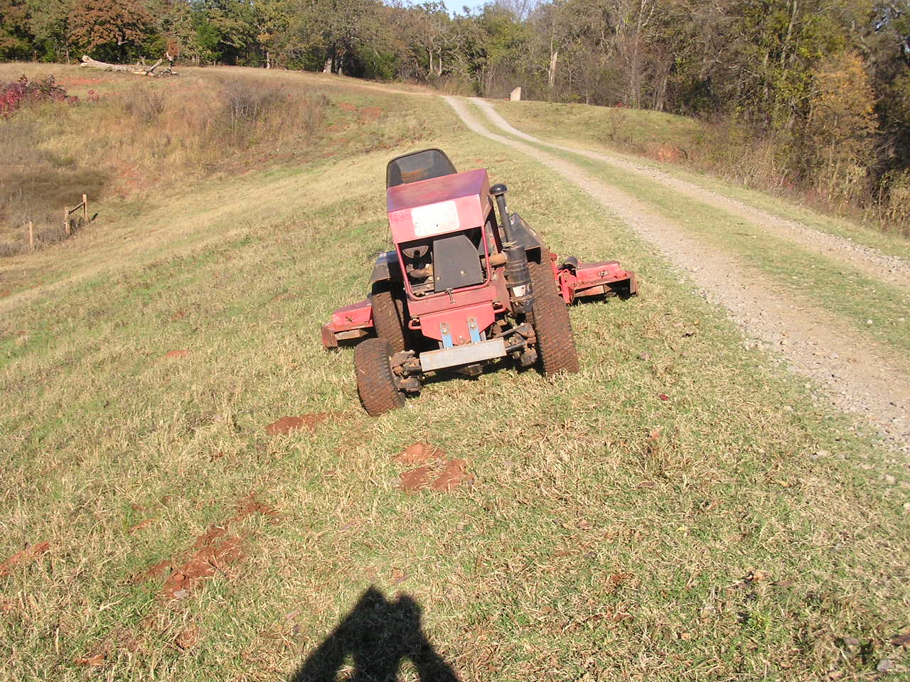

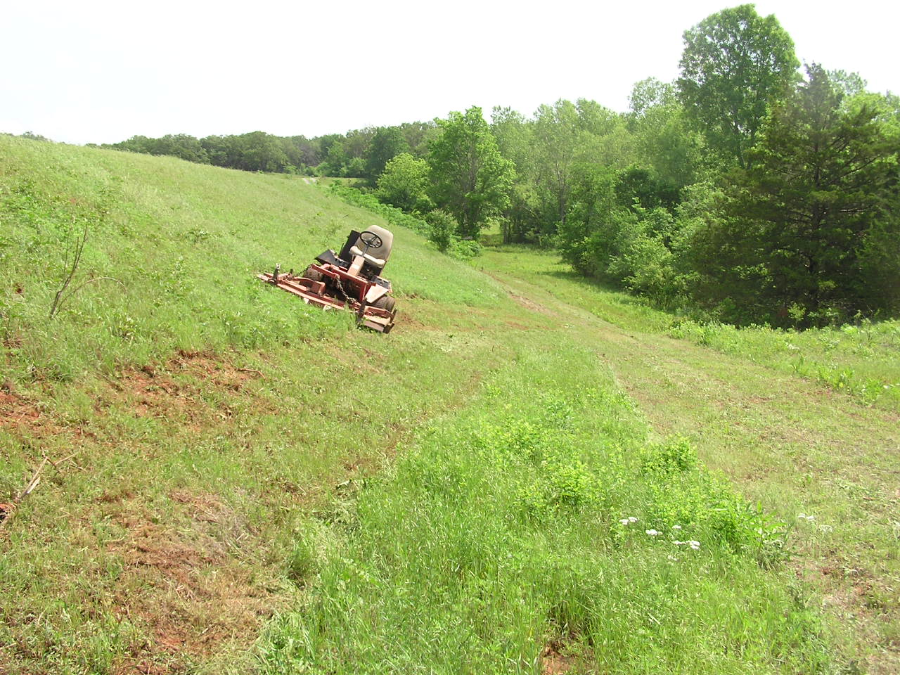

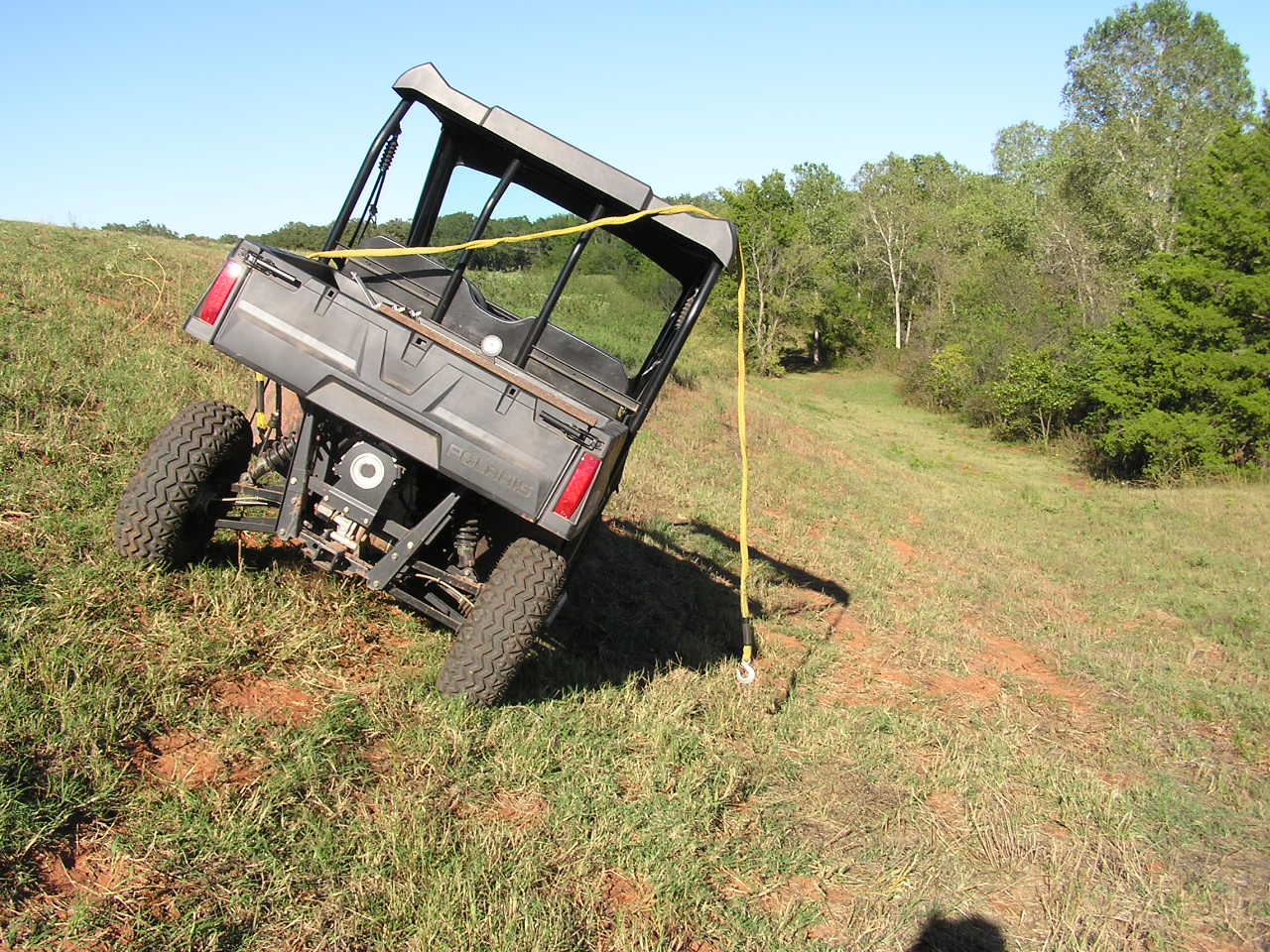

Here is what 3-1 looks like.
Not too bad to mow, but have to have 4WD.
And 2-1 on the back of the dam.
Even with 4WD, the mower tends to slide sideways downhill. :eek:
