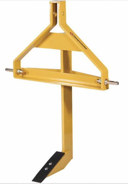

I use this for running pipe underground. Removed the foot, drilled a hole and added some metal straps to connect the pipe. Of course you have to dig out the ends of the run for the pipe (I have used PVC but flexible pipe would be even easier). When done run tractor over it and for the most part there is no back fill.

You make it sound easy but I don't fully understand the process. Can you be more specific?

So I use the backhoe to dig out 8 feet at each end of the trench (because I was using 8 foot pieces).
This works best with a helper.
Run the trencher through a couple times just to break things up a bit if needed (I hit some hard pan on my last one and ended up having my helper stand on the trencher).
Connect a piece of pipe to the trencher at one end of the run.
Helper can let the operator know when to stop and glue on the next piece of pipe.
As mentioned I think this would work great with a spool of flexible pipe but I haven't tried it.
Also when you get near the end you may need to turn the tractor around (if close to building or some object you don't want moved), flip over the pipe connector on the trencher and backup.
It is easy and fast. The longer the run, the more time saved versus using a backhoe.
On my last install I connected 2 pipes to the trencher. One for electrical and one for water (I believe code says to put electrical on top, at least that is the way I did it).
Lou
