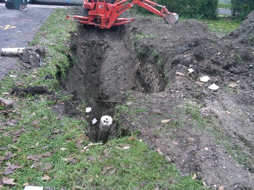

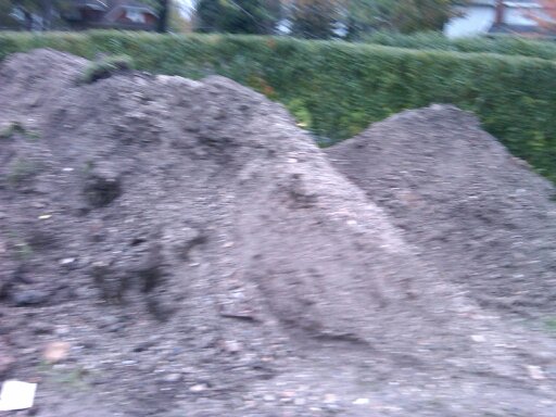

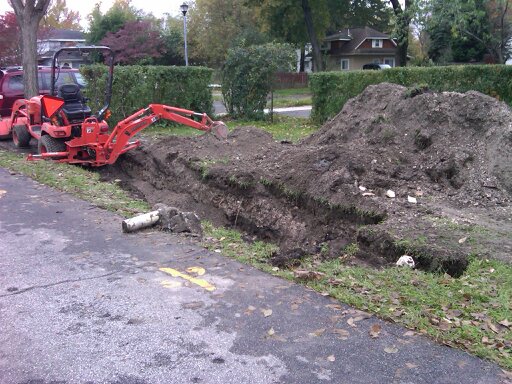

1325088041634.jpg1325088044157.jpg1325088047269.jpg1325088050213.jpg1325088053135.jpg

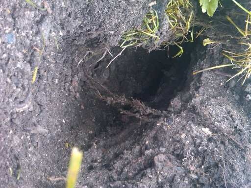

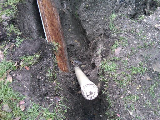

Sorry guys -- I know you gonna hate - but these are the only pics I took. It was for a sewer project I was working on and couldnt find pic that had me driving down digging out a ramp to go deeper for my BH. If you can picture this - its a single lane going straight down to hole. I literally had to sit back on seat hard to keep the cutout from kicking in. The top of the ground was waaaayy above the rops and all I saw was walls going down and back up. I was trying to find the old sewer pipe from the sinkhole I found in the yard and was trying to figure out what happened. The old clay pipes actually sunk over 8 ft from original position in middle of yard. It was over 6 feet deep at house end,, the old main sewer was even deeper then that under the street. It actually sucked there since most of the soil was ashes from old landfill from 1920's. Found lots of intact old bottles too.
