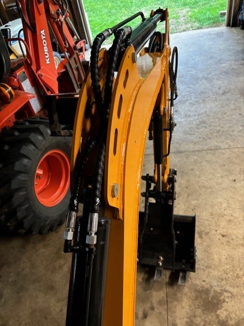

Any one know where the hydraulic drain plug is located at? It warmed up today did a few things on it. Got my 12" bucket on it. Works fine, will have to get a couple spacers between the ears. A lot heavier. Took it and transplanted a small bush. The main thing i am going to have to do is change the control to the JD pattern. no way can I use it like it is. Any one know how that reset switch works on your instruments and I see that it doesn't show my RPM.
   / DigMaster DM200 Excv. #59
John - can't help on the instrument reset but the Hyd tank should have a plug on the bottom - if you remove the side cover then swing the machine so the tank is between the rear tracks you should see the drain.
To change it to BH or JD controls, you need to swap the boom and dipper stick lines. Was easy on my Hightop as the boom cylinder is on the back so it was just a swap of lines.
. Yours is in the front so you will need to change at the valve body - which from that video appear to be easy to access and are labeled.
